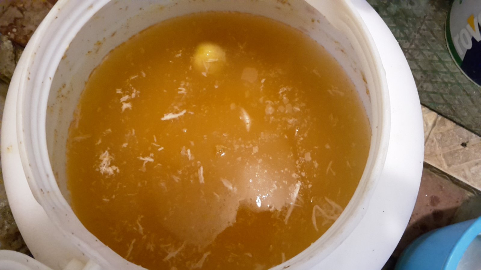

Every year I distill a small batch of figs, this year is very little but I am satisfied, I drink little alcohol so it's ok.
Puree
start fermentation
finish fermentation

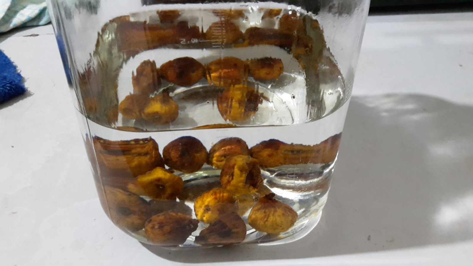

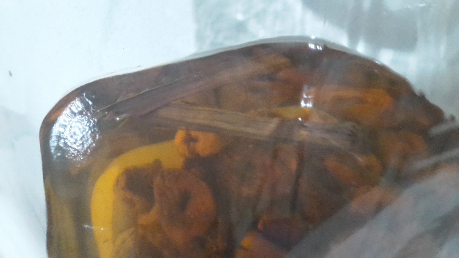

Thank you all, I didn't think there would be interested. The procedure was very simple: collected, washed briefly, chopped in puree, added little water, added yeast bayanus strain (from sparkling wine). No enzyme, no sugar. I always have some problems measuring the OG with this fruit, because it makes the juice a little gelatinous then "brake" the descent of the densimeter in the test tube, in fact my OG was only 1047 but I think it was more.

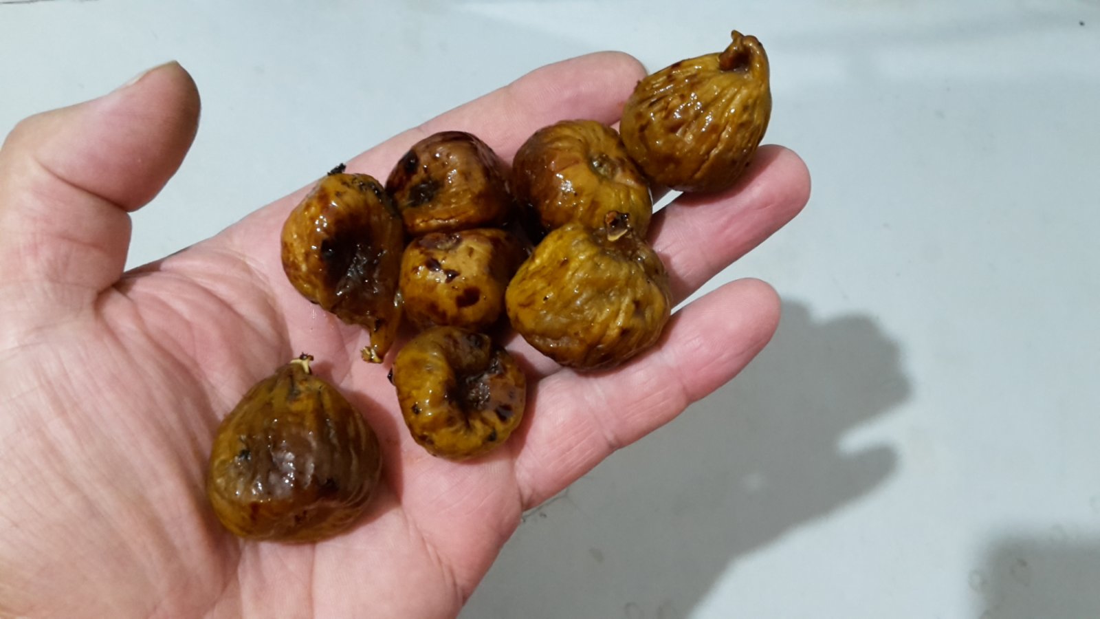

First I run a stripping with the steam jacket, distilling the whole fruit, then today I made the Spirit run leaving the distillate white, then I added the whole dried figs, they are dried in the sun naturally, you can see the fruit sugar which covers the entire fruit. I did some pictures, I hope I answered everyone .....
Bass wines + added part of the ferment
Dried figs, then briefly baked, you notice the caramellization

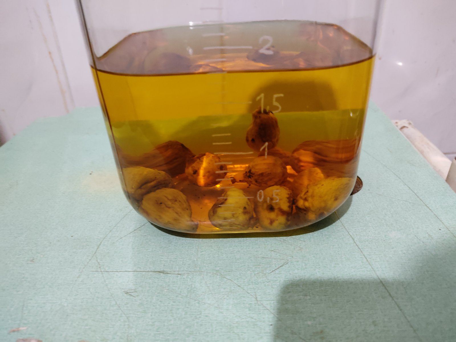

Update

Today I added a couple of additional figs, and then the final touch with a piece of slightly toasted cherry wood.

I am pleased that others have tried.I replaced the wood with dried figs, makes an inic product and much appreciated by friends!
