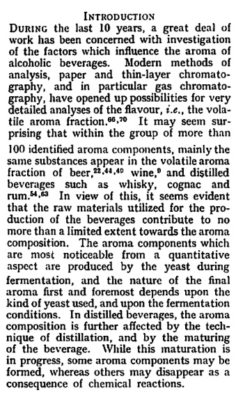

Postby kiwi Bruce » Sun Sep 03, 2017 9:24 am
Single Malt Yinzer has this in another post ...I'll link to it again...good reading
YEAST AND ITS EFFECT ON THE FLAVOUR OF ALCOHOLIC BEVERAGES
http://onlinelibrary.wiley.com/doi/10.1 ... 370.x/epdf
Thank you Single Malt Yinzer!
