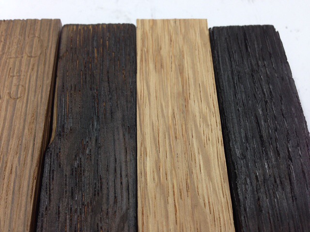

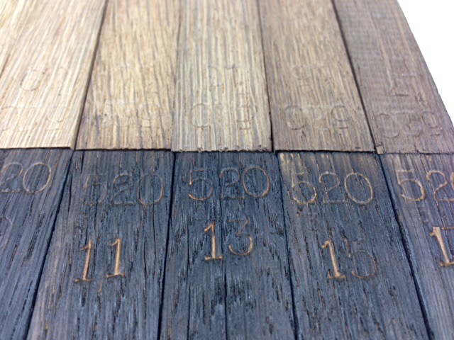

Howdy. I've read about and done a little charing, and know that the "correct char" is subjective and the correct process is also subjective. I simply want to share some pics and get any feedback on my process of level of charring. The few specific questions are below..
For these toasts, I am using a propane torch adjusted down to a 1" long, 2.5cm, blue flame.
My sticks are 3/4" x 3/4" x 6" (2cm x 2cm x 15 cm)
To toast, I run the toarch down one side with a small zig-zag pattern, and the torch was touching each side of the stick for 10 seconds. I finish with a little char to the ends.
The result is a thin char, and I can see small hints of un-charred wood through the char. I am wondering if this char is enough for a Bourbon? This last pic includes a stick on the right with a bit more char on it. About 16 seconds per side. I can no longer see any un- charred wood through the surface. So in your opinion, is the thin char enough for jar aging, or perhaps the second deeper char? Maybe you think I should go even deeper? Just looking for opinions from those who have done much more of this than me.
Thanks. Otis
Thanks. Otis

Both chars look all right.
The shorter the oaking time is, the better will taste the light char. More and finer taste from the oak, although perhaps the color of the Whiskey is lighter. The dark char will taste more unclear musty and will have the astringent dryness of wine. After a year both will be similar. Perhaps later the darker char will win. I am not sure.

I tend to replicate a #3 char on my charred white oak sticks. I believe a #3 char is what most Bourbon distilleries use. IMHO, a #3 is closer to a "alligator" char than any pictured. I have good luck with this level char, but have learned it is best to wash well after charring and the wood used is important as well. I get mine from a fire wood guy and only well seasoned white oak and I remove all sap wood before I char. I have also been playing around using a combination of well toasted sticks and #3'ish char sticks. I also just split my sticks to size and suspect that rough and un-even surface gives better results than the neatly sawn (I even seen guys plane them) pieces.

i char for a simulation of #4 char. i have barrels charred to #4 and they have 1" square chunks about 1/16 thick of char that have fallen off and roll around in the barrel. i leave them in.
Talked to Jay Gibbs from Gibbs bros. cooperage today. he said (on top of being one of, if not the, oldest continuously run cooperages in the USA) all of their barrels are #4 char and was quick to point out that of the distilleries he services they have won many, many awards with his barrels.

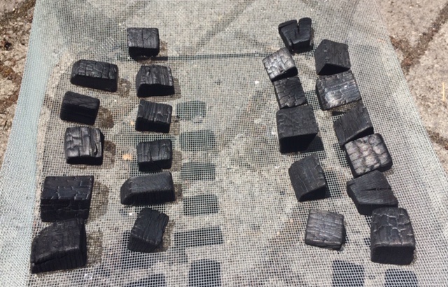

Sorry for the big pic, but it is needed to see the char levels. Legal Bourbon must use Char 3(Edit: This is wrong, see below). Looks like you're closer to 1 or 2. Article below has good info near the bottom on charring.
http://www.distillerytrail.com/blog/und ... s-not-age/" onclick="window.open(this.href);return false;" rel="nofollow

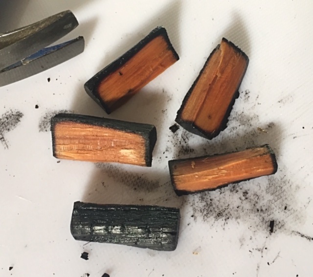

My OP showed a pretty light charring. Figured I would add something more in line with what I have been using more recently. 25 seconds under the propane flame thrower.
This is some chunks of toasted Apple I did a few months back for some rum and other future spirits. I put these on a wire screen to get the flames to wrap around the sides. After charring one side I doused them in water then flipped them over for a char on the back side.
After soaking The toasted/charred apple in rum for 4 months, I pulled the chunks and split them to be put in proofed down bottles of rum. This is a nice view showing the depth of this char. Otis
