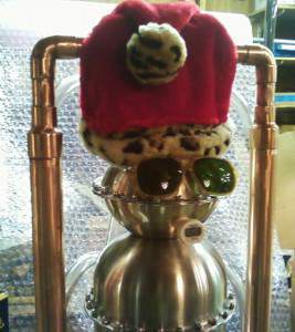

Postby mash rookie » Sun Dec 18, 2011 2:08 pm

Postby Bushman » Sun Dec 18, 2011 2:14 pm
Nice to see it done, thanks for the early sneak preview!

Re: I ROBOT
Postby LWTCS » Sun Dec 18, 2011 2:27 pm
Silly feller,,,,Got a diagram of the vapor path?

Re: I ROBOT
Postby Prairiepiss » Sun Dec 18, 2011 2:31 pm
:lol: I like it. Looks great. Nice work as always MR. :thumbup:
+1 on the diagram.

Re: I ROBOT
Postby BigPa » Sun Dec 18, 2011 2:34 pm
I don't like the way he keeps staring at me......... :clap:

Re: I ROBOT
Postby devotus » Sun Dec 18, 2011 2:38 pm
Best looking espresso machine I've seen :)

Re: I ROBOT
Postby frozenthunderbolt » Sun Dec 18, 2011 6:28 pm
Single collum, double liebig condenson, coil above his head?
What diameter are your bowl bubbles, how many nut'n'bolts and any gasket there?
Did you cut out a disk or drill permanent plates inbetween each one before soldering?
most important how does it run?!

Re: I ROBOT
Postby Large Sarge » Mon Dec 19, 2011 4:47 am
These are not the droids you're looking for.....
OK, so you have my attention. How does it work? Details man, details!!!

Re: I ROBOT
Postby emptyglass » Mon Dec 19, 2011 4:49 am
Man, I can't get the smile off my face. LMAO, in the best way.
I don't care what it does, that was worth it.
Girls dont piss like that. This ones gotta be a boy.
And just when I thought I'd seen it all, along comes MR with this. You got too much imagination dude.
Just watch out for those Bender robots, they not only run on hard liquor, but they will be highly attracted to her...umm...him.
Ok' smile has gone a bit now, whats the go with the twin condensors?
For capacity, art, or both?
Is it a thumper tower, or plates?
Just looked at those hands again, smiles back. :clap: :clap: :clap: :clap: :clap: :clap:

Re: I ROBOT
Postby Samohon » Mon Dec 19, 2011 4:55 am
Nice MR... +3 Diagram of vapour path..?
I'm liking its compactness... :thumbup:

Re: I ROBOT
Postby Bushman » Mon Dec 19, 2011 6:08 am
Before it was done my wife looked at it as MR was explaining it. The hands were not attached holding the parrot so later I explained that it was going to be a robot taking a piss, the hands and finished look is a nice added touch to what I saw!

Re: I ROBOT
Postby Samohon » Mon Dec 19, 2011 7:17 am
Reckon the 2nd from top and probably the top ones are thumpers, could be completely wrong though...
Where s Larry the thumper king? C'mon MR... :twisted:

Re: I ROBOT
Postby mash rookie » Mon Dec 19, 2011 8:15 am
THIS A HIGHLY ADVANCED AUTOMATED DEVICE. Nah, that’s BS
Functioning art. Simplicity. CM packed column. No bubble caps No plates. Three inch holes where soldered. Stainless mesh screen held down by full fine copper packing in each ball. 101 nuts and bolts. 202 washers
I expect to achieve tremendous amount of refluxing with a vapor speed change at each ball. Vapor will linger and drip as it slows in the packing before being forced through the next three inch restriction.
The arms are twin Liebigs because I expect a huge amount of vapor to knock down. Vent holes will be drilled below the elbows. One more hand to make.

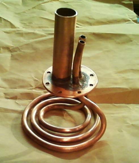

The brains include packing and a reflux condenser shaped like a stove burner. Coolant will be diverted from exit water.

Re: I ROBOT
Postby Prairiepiss » Mon Dec 19, 2011 9:35 am
From your prior posts I thought it would be some sort of thumper bubbler set up. But I'm still interested to see how the vapor expansion in the balls effects the output. I found with mine the expansion in my condenser ball helped with the cooling efficiency.
You said your reflux condenser is a coil like a electric burner? So its a flat coil that spans the width of the top ball? Spacing between the coils? If so I really like the idea. I'm guessing its 1/4"? How much do you have coiled in there? Just curiosity wanted to compare to mine. I have 7 foot or so in mine. But mine isn't flat its a traditional coil. can't wait to hear some results. I think you mite get that neutral out of this one that you have been looking for. :thumbup:

Postby mash rookie » Mon Dec 19, 2011 11:28 am
It is 3/8" PP. It should do the job. Here is a pic.

Re: I ROBOT
Postby Prairiepiss » Mon Dec 19, 2011 11:32 am
Very cool MR. Looks like it should serve you well. :thumbup: Thanks for the pic.
