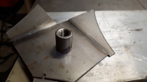

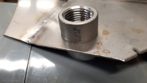

Looking for some help already!
I'm going to be welding (planning to anyhow) some 1/2" NPT half couplers to the sheet metal.
Of course I tried to do this but failed miserably. (:
I tried cranking up the amperage (120A) to melt the coupler, that succeeded in melting my electrode pretty fast.
Any tips for this one?
Note that this is a 1/4" coupler for this test.

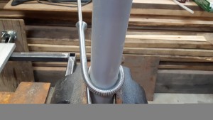

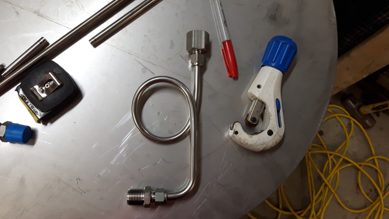

An overall view of the final design.
The pigtail on the top left is for the vacuum relief valve.
The other part next to it is the 1psi cracking pressure check valve. This will inject steam into the mash once the boiler pressure reaches 1psi. The check valve also prevents mash being sucked into the boiler when the system cools down.
The plan is to put a 10" manway cover on the top to make loading and dumping easier. The whole shabang mounted on a pivot to make dumping easy.

As far as the welding, use 3/32 tungsten, sounds like maybe yours is 1/16 if it melted down with high heat setting, and you can probably lighten up on your amps a little. You should be able to run a nice fillet weld around it. Concentrate your heat a little more on the coupler and you should be fine.

just by your pic. it would help to clean your stainless with a SS wire brush or cup brush on a drill to break surface oxide. then use a filler rod to start the pieces flowing together. the beauty of tigging if you don't like how it comes out just go back over it again to make'r purdy. just for curiosity why don't you want to use filler rod for the welds? I understand the thin sheet to thin sheet but a coupling to sheet is much easier with filler, and IMHO easier to not sugar the back side of the sheet when directing the heat at a fed weld puddle. one last thing watch for any breezes it's really weird how small an air flow , or to high of a gas flow, can suck oxygen into the weld(never good) for shits and giggles your gas lens flow should be 15 to 25 cfm. hope I helped a little bit :) good luck

That's why I'm posting here folks, I need advice.
Thanks for the replies, I need advice I've never done anything like this before.
I started without filler rod 'cause that seemed like the way to go.
I'll clean up before I start the next practice welds.
I'll also try with some filler rod and post my results.
Any more advice, keep it coming.

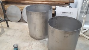

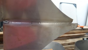

Ok, so after practising on scraps I finally built up the courage to tackle welding the tube seams.
I clamped on aluminium bar I had sitting around to the back of the seam and proceeded to weld.
Tacks at first, then stitching about an inch at a time. My experiments and practice gave me the confidence to fusion weld the seam. No filler.
Had a couple of rags by my side to cool the welds. A wet rag to cool the welds, the other to wipe up the water.
I must say, I'm pretty pleased with the results!
Not the prettiest welds, but for my first ones, I'm stocked! :thumbup:
I cleaned up the welds, but didn't go bananas. The whole thing will be insulated.
The bottoms aren't welded yet, I just wanted to see how stiff 16 gauge would be.
Plenty stiff if you ask me.

Posts: 12841
Re: Fasten your seatbelts. Let's build the Mashimizer !
Nice build Fart :thumbup:
Just a thought.
Make at least one of the parts to be TIG welded bigger than needed,
So the excess material can be used as filler. So you don't need filler rod.
That's what I do, because I shake so bad, that it takes two hands to hang on :lol:

shadylane wrote: Make at least one of the parts to be TIG welded bigger than needed,
Yup, that's the plan. The bottoms are oversize by 1/2" which gives me a generous 1/4" all the way around.
I wasn't sure how distorted my cylinders were going to be when I started.
I must have done it correctly, because there is basically zero distortion from the welding.

Fart Vader wrote:Looking for some help already!
Just some thoughts. Are you running pure argon for a shielding gas? How is your tip ground on the tungsten. A conical sharp point works best ground in the direction of the point.You can pre-heat the collar so it will weld easier. Are you running a tight gap with the tip of the electrode? On small stuff I like to keep the tip within about 1/16 of an inch from the puddle give or take a bit. Get some 1/16 308 filler rod to help get the puddle started if you want to do a fusion weld. Also fusion welds need a tight metal to metal fit to work well, no gaps.
Don't crank the power up to 120A :lol:
If I remember correctly around 30 or 40A was the max I used, when welding fittings to the sheet metal.
Concentrate the heat on the thick fitting, melt the puddle and flow it into the sheet metal.
You only need high amps when welding copper or aluminum.

Hi Corene, I was hoping you would find this thread and share some of your valuable advice.
100% Argon, around 20CFH using a gas lens with a #6 cup (I also have #5 and #8).
1/16 308L filler is what I have. (Also have some 309L and 347ER)
Conical point, ground in the direction of the point is what I've been doing. Nice tight arc.
I'm actually quite surprised that I have not dipped it in the puddle as much as I thought I would have.
I guess my coordination is still relatively good ;)
Shady, 40A is what I've been using on the 16 gauge. I cranked up the current practicing on the coupler.
Here's another question. How do I prevent cratering when I finish the weld?
Maybe 10% of my stiches ended up with a small crater. :?:

If you have a foot pedal, slowly reduce the current to 0

Pigtail anyone?
Post by Fart Vader »
The vacuum break valve needs to be mounted on a pigtail for steam service.
I've never tried anything like this before, but it worked like a charm.
3/8 stainless tubing bent around a piece of pipe using a spring bender.
The resulting pig tail ready for installation. Soon.
Actually a lot easier to do than I initially thought.
My double walled boiler build: The Mashimizer. viewtopic.php?f=50&t=64980
