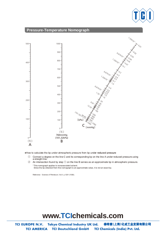

This nomograpgh maybe of interest to those using vacuum for distilling spirits, the graph makes temperature corrections for barometric pressure and elevation.

unfortunately heat up energy (2.57 J/g.K) isnt that much compared to boiling off energy(841j/g) , so the energy savings arent that muchdougyethanol wrote: ↑Thu Aug 15, 2019 1:49 amI have been working on a vacuum setup, Its like learning to distill all over again. Great power savings can be achieved as you need less heat to boil ethanol with minute power to obtain vacuum. Its a work in progress, i have a working model but needs more work. I will post pics and updates as i work on it.

manu de hanoi wrote: ↑Thu Aug 29, 2019 4:49 amunfortunately heat up energy (2.57 J/g.K) isnt that much compared to boiling off energy(841j/g) , so the energy savings arent that muchdougyethanol wrote: ↑Thu Aug 15, 2019 1:49 amI have been working on a vacuum setup, Its like learning to distill all over again. Great power savings can be achieved as you need less heat to boil ethanol with minute power to obtain vacuum. Its a work in progress, i have a working model but needs more work. I will post pics and updates as i work on it.
