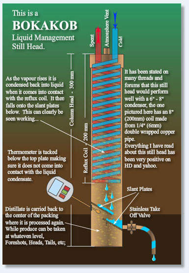

The Bokakob (Boka or Bok for short) is the common name for a Dual Slant-Plate Single Column In-line Reflux Still designed by Alex Bokakob in 2001. The still was originally designed with a fairly small reflux column to sit atop a stove-top boiler, and has seen significant modifications and improvements over the years. This still is popular with many novices for its simplicity to build and operate, while being able to yield 95% ABV neutral spirits. It can also have its packing material removed and function as an adequate pot still. It is classified as a Liquid Management or LM Column reflux still. History
Bokakob created a series of reflux still design drawings that were widely circulated after they were created in 2001. http://homedistiller.org/equip/photos-alex" onclick="window.open(this.href);return false;" rel="nofollow This particular still featured a short (2ft/.67m) column made of 1.5" copper pipe attached to a stove-top pot boiler, and only required three joints to be soldered (the upper and lower plate, and take-off tube). Various discussions on Yahoo and HomeDistiller.org resulted in many design variations and improved efficiencies.
The still was named after its designer Alex, who had a Yahoo username of Bokakob, but web discussions with poor spelling or simple abbreviation led many to refer to the still as a Bokabob, Boka and Bok.
Column and Slanted Plates
General Theory
The single in-line reflux column of the Boka is meant to carry vapors from the boiler up through packing material for reflux and up to the condenser. Some of the distillate will fall to the dual slanted plates which can then overflow (allowing the distillate to fall back into the packing, which is the basis of the reflux design) or be drawn-off for collection. Materials

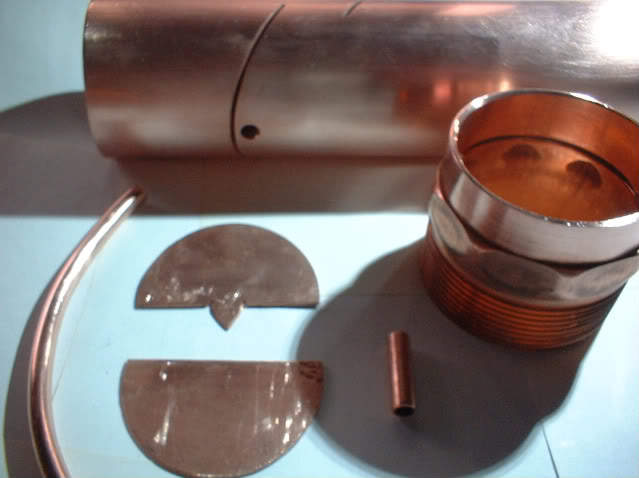

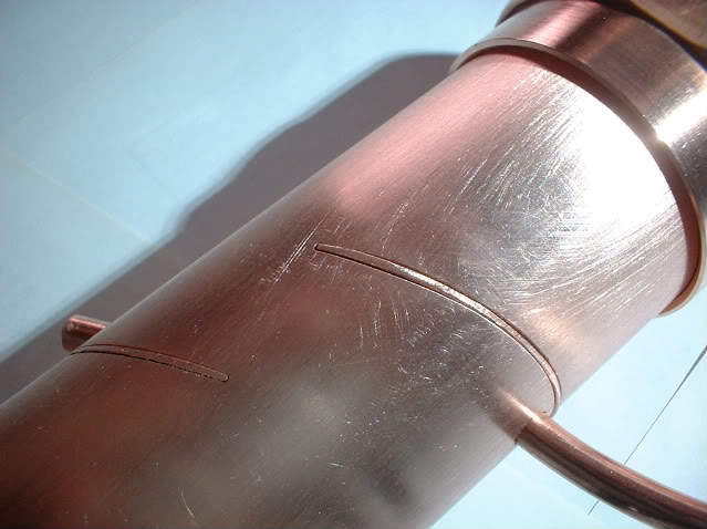

Plate angle, placement, and spacing The slanted plates (not to be confused with reflux plates or trays such as bubble caps or perforated plates discussed elsewhere) in the Bokakob design are set at an angle below the condenser coil so that the upper plate collects distillate from just over half of the column and directs it onto the other lower plate. The lower plate is angled towards the wall of the column and collects a "pool" of distillate. At the bottom of the "pool" there is a take-off tube which can be opened to collect the distillate. If the take-off tube is only partially opened or is left closed, the "pool" overflows and a notched recess in the lower plate allows this overflow to fall back into the middle of the packing material of the column below. This allows for further reflux and purification of the distillate.
The ideal placement for the plates should be such that the upper plate is just below the condenser, about 0.5" to 1" (15-25mm). In earlier designs the upper plate was connected to the bottom of the condensing coil, but distillate was able to drip down the sides of the column and then would not properly mingle with upcoming vapour. The original design also required the condenser/plate assembly be perfectly rotated to align with the lower plate or collection would suffer. Later designs have the upper plate soldered to the column independent of the coil. So, for proper placement of the slanted plates, you need to know the size of your condenser coil. Building your coil and deciding its placement and measuring where it will end in the column need to be completed before deciding on placement of your slanted plates.
The angle of the slanted plates has traditionally been at 30 degrees of angle from horizontal. The angle is only important to the extent that the take-off tube is submerged in the "pool" of distillate. http://homedistiller.org/forum/viewtopi ... =17&t=1757 More extreme angles (>30º) will require more material to construct and will not provide any benefit, though those using a compound mitre box may only have a 45º slot. You also need to ensure that both plates pass the center of the column, or overlap in a vertical plane. If your plates do not overlap then distillate will fall of the upper plate back into the column, missing the lower plate and collection "pool".
The spacing of the plates, (ie, the vertical space that is left between them) needs to be sufficient to not constrict flow of vapor up the column. Too small of a space may increase vapor speed in the column after the constriction and minimize the time the vapor spends condensing at the condenser coils. The general consensus is that 0.75 to 1" (17-25mm) is best in a 2" (50mm) column. This approximates the cross-sectional area of the column with the packing material in place. http://homedistiller.org/forum/viewtopi ... 17&t=17857 http://homedistiller.org/forum/viewtopi ... 32&t=15948 There is a nice diagram of the Boka head here. http://homedistiller.org/forum/download ... &mode=view
The plates are typically made from a scrap section of copper pipe, which is cut along its edge )parallel to direction of the pipe) and beaten flat with a hammer. Once the column has grooves cut to accommodate the plates, the rectangular plates can be inserted into the grooves and marked with the correct shape, then ground or cut to be smooth. There is no need to pre-cut the plates into elliptical shape before the grooves have been cut. Once to proper shape they can be soldered or brazed into place. http://homedistiller.org/forum/viewtopic.php?f=2&t=8794

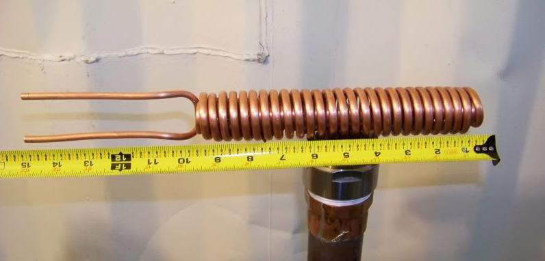

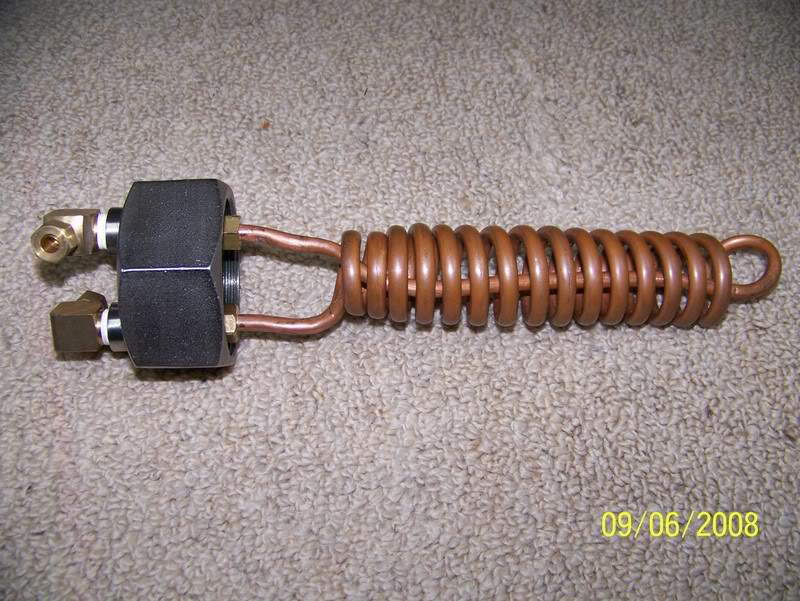

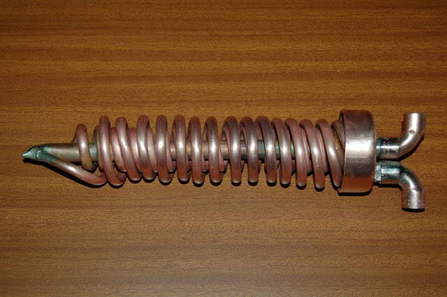

Concentric dual-coil
This is the most popular type of condenser used in a Boka. It is commonly referred to as a 'double helix' coil, though it is not. http://homedistiller.org/forum/viewtopic.php?f=2&t=5810 It is better described as a single-path double-concentric counter-wind condenser, or its proper name, the Dimroth Condenser. http://en.wikipedia.org/wiki/Condenser_%28laboratory%29" onclick="window.open(this.href);return false;" rel="nofollow It is constructed from one continuous piece of copper tubing, which is wound in spiral downwards, and then continued into a second larger spiral wound outside the original spiral back upwards. Both the input and output are at the top of the coil. It is more difficult to make than a single coil, but isn't too difficult with some practice and simple household tools.
There is a great tutorial by Hookline on how to wind this condenser by hand here: An alternate method is featured here which uses a jig and more tools: http://homedistiller.org/forum/viewtopi ... 62&t=11554 Keep in mind that filling your coil with salt will greatly minimize the risk of kinking the coil, but many users have found removing the salt after coiling difficult or impossible without high pressure. Also, if you don't want to buy a spring-style coil bender, many spring door stops fit 1/4" tubing and work just as well. Single coil
For columns narrower than 2" (50mm), a double coil may not be able to be wound narrow enough to fit in the column. For smaller columns a single coil may fit better. This is a Friedrichs condenser http://en.wikipedia.org/wiki/Condenser_%28laboratory%29" onclick="window.open(this.href);return false;" rel="nofollow which is constructed from a single piece of copper tubing which runs straight down to the bottom of the coil with no winds and is then coiled in a spiral around the central tube back upwards. This type of coil can be constructed using the same methods as the dual coil, just skipping the first half: http://homedistiller.org/forum/download ... p?id=18968 Using a cold finger
For either of the above designs, a long coil can create substantial back pressure which may inhibit the ability to use coolant circulated by a pump. The solution is to have a cold-finger run down the center of the coil. A cold-finger is a larger diameter tube down the center that is soldered to the outer coil or coils so that it also carries the flowing coolant. In addition to reducing back-pressure, the cold finger also increases surface area in the coil and increases efficiency. http://homedistiller.org/forum/viewtopi ... 15&t=17456 It requires more tools, cutting, skill and soldering but yields a superior condenser, especially with columns larger than 2" (50mm) Keep in mind that it may be difficult to fit a cold-finger inside the traditional dual-coil used on a 2" (50mm) column. A true double-helix with a cold finger is among the most efficient condensers, creating a uniform spiral path for upward airflow in-line with the coils of the condenser, and is pictured here: http://homedistiller.org/forum/viewtopic.php?t=2535 Sealed/capped

A thermometer allows you to monitor the vapor temperature as you distill. At the beginning of the run, the temperature will allow you to know when your still has begun to reflux. Later, the temperature lets you judge the purity of the distillate output without having to measure it with an alcometer. While it is often shunned by potstillers, in reflux distillation the thermometer becomes a invaluable tool to indicate when to begin collecting the distillate, and when to cut to tails, or to assist in adjusting the correct amount of reflux. Temperature is the primary feedback in optimizing your distillation, as it relates directly to the purity of ethanol vapour at that point (see the ethanol / water phase diagram).
Pikluk's Boka head with thermo probe inserted
Placement
The original Boka design called for the thermometer to be placed in the packing, near the middle of the column. The theory was that the temperature should be uniform in the column and temperature changes in the middle of the column could be noticed before the distillate being collected higher up changed, thus allowing for better cuts. http://dir.groups.yahoo.com/group/new_d ... sage/16745" onclick="window.open(this.href);return false;" rel="nofollow Later designs call for the thermometer to be placed above the top of the packing, just below the upper slanted plate, shielding the thermometer from falling distillate. Distillate that drops down into the packing during the reflux process can have a different temperature than the vapor and make it more difficult to properly identify the minute changes in vapor pressure that denote change in purity or composition of the vapor. http://homedistiller.org/forum/viewtopi ... =36&t=8804
Both locations have their merits, but the consensus would be that placement above the packing is most useful. Placements further down the column can provide advance notice of changes occuring before they influence output, but thermometers there are best seen as suplementary to the essential top thermometer.
