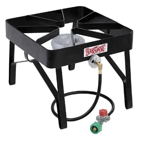

A common propane burner used to heat the boiler
Natural gas, propane, and lpg can be used with a simple burner to heat the boiler directly. Burners range from 10,000 BTU up to 100,000 BTU. Gas Burners come in a wide range of sizes and styles, but all of them are meant to sit below and heat the bottom of the boiler http://homedistiller.org/forum/viewtopi ... 15&t=18608 http://homedistiller.org/forum/viewtopi ... 15&t=14836. Gas has several advantages over electric. Gas controls are much more flexible "off the shelf" and allow for fine (if not accurate) adjustment to heat output. Most gas burners can also generate a higher maximum energy than electrical circuits can yield, giving much faster heat-up times. Gas makes the entire apparatus portable to areas away from power supply, which may be of use in sheds without utilities or outside. Many users already have some type of gas burner that can also serve their distilling needs without any extra modifications or need to purchase special equipment. Gas burners are probably less likely to scorch a thick boiler charge if run carefully, though some very high-solid washes will still require a slow heat up or indirect heat like a double boiler to prevent burning
The drawbacks are that an open flame puts off dangerous CO2 and CO and requires plenty of ventilation or must be used outdoors. Open flames from a gas burner can ignite alcohol vapors in the case of a condenser failure or even cause an explosion if leaks are not identified and the set-up isn't watched carefully. Gas/Propane costs can be much higher than using electricity (depending upon area) and may be more difficult to move or transport. Propane tanks also need to be refilled after several uses creating extra trips to the 'propane store', and can leave you short mid run. Gas is a more inefficent heat source, as the boiler is not as easily insulated as an electric boiler because of fire hazards and venting issues (see insulation. It is also harder to set a known wattage input with gas. It is possible, but requires some experimenting and measure water production at various settings to calculate. This means it can be hard to determine if a reflux column is running at its most efficient speed, but has little implication for pot stillers.
