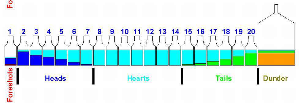

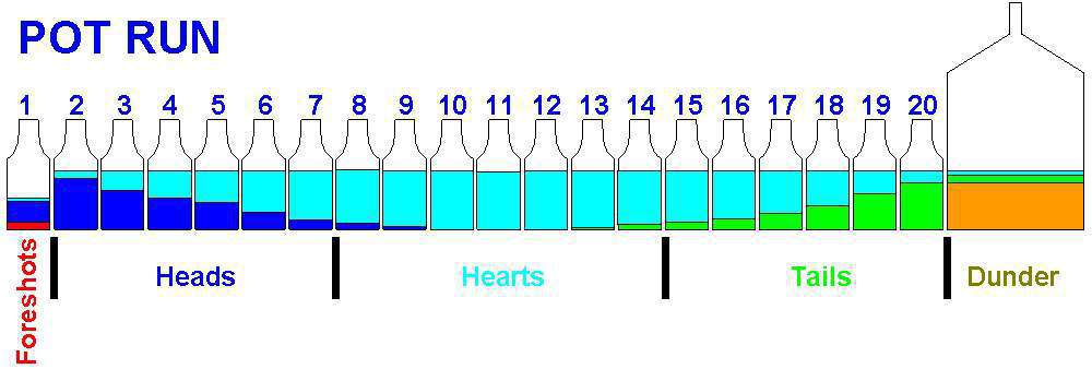

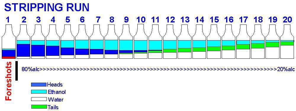

To give you a visual idea of what is going on in a pot still run, Ayay has knocked up these awesome illustrations. (from http://homedistiller.org/forum/viewtopi ... 15&t=11913)
One of the biggest things to get your head around with a pot still is that fractions do not separate out cleanly (reflux columns are better at it but still imperfect). The different components in the product tend to get smeared across a run. If each bottle of a run was divided up into components, it would 'look like this':
However, the components are all mixed up (and appear that way to our senses) so what the distiller is really faced with is better visualised like this:
The hearts cut in the first diagram is shown as completely pure. This is not normally the case. The following two diagrams present a somewhat more realistic scenario. First of all, most distillers chose to do a stripping run.
The key thing to notice here is the amount of water in each bottle increasing as ABV drops. Stripping runs are blasted out faster than a spirit run (the last run, when most make their cuts), so the separation between fractions is bad. This is of no concern at this stage, and no cuts are made. The decreasing yield of alcohol also illustrates why we normally stop our stripping runs at 20% or so - after a time, it is simply not worth the bother / heat input for such a small return. Now lets assume that the product from this stripping run was added to the product of say two more stripping runs, and dumped back in the boiler at 40%. Then a slower spirit run is performed, so get better separation between fractions. For clarity, the water content is omitted from this diagram.
The key thing to notice here is that there is some overlap of heads and tails with the indicated hearts cut. This is because there are desirable (and strong) flavours in heads and tails, and with too narrow a hearts cut, the end product will lack character and flavour. Also, aging can smooth out the harsher compounds that come with those flavours, but that is another discussion in itself. Deciding how much of the late heads and early tails end up in your product is what I consider to be the hardest part of the production process. Get it wrong and your product is either boring, or harsh with painful hangovers. Fortunately, there are a few tricks to help out the beginner in this.

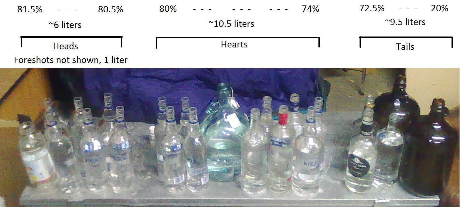

Notes from the cutting bench...
Post by kiwistiller » Wed Nov 11, 2009 7:17 pm
I ran an UJSM varient a few days ago and I thought I might keep some records of the cuts as a indication of what to expect for cuts on a spirit run.
The Charge: ~40l (hard to see in the keg :) ) of low wines @~45%, from successive ferments of UJSM style corn + rye + barley malt.
The Run: Heat up at full power (I'm using a 3 ring gas burner, about 30k btu I think), slow down and take foreshots off on very low power, power up a bit on heads, more power still on hearts (around 2/3 of full power now), and then let the take off rate naturally decrease as the % in the boiler drops, and tails start to creep in. once definately in tails, full power to strip.
The Destination: It is a good idea to decide what you are going to do with your spirits before doing cuts. If you plan to drink it white, for example, you need to make very tight cuts. oaking will smooth out some heads and tails, and help transform them into nicer flavours (although this is voodoo to me), so oaking lets you get away with slightly wider cuts. This run was destined to go on my toasted barrel sticks for 6 months to a year (hopefully :) ) so my cuts on this run will be reasonably wide.
The Result:
I've also been experimenting with power settings, I read that it is possible to run too slow, and powered up more during hearts. This increased my hearts cut by about 2 bottles on the heads side! Now as I said this is going on oak for quite a while (well, its a while for me!), six months to a year, so the heart cut is probably a bottle or two wider than usual. I was tempted to go one or two deeper into tails, but I have a fear of tails after the disappointment of screwing up my first pot still run that held all my hopes and dreams :lol:
Anyway thought this might help some folks get a visual of sorts.

very nice!. also the cuts change with what your actualy fermenting off and, what your tastes are. i did a very simular run on a wheat/corn malted barley ujssm. charge % and size close to yours. i started keeping around 76% down to 68% for a total of 13L of cut 45% that suits my tastes. you don't run into the tails as far as i did ,but i kept less heads. you are correct about changing up the speed on the middle of the run, i'm going to play with the speed more on this grain bill. one thing about ujssm you get a chance to good at it and know exactly what to expect...so experaments keep ya learning.

yes I'd normally have about 2l more of heads, speeding up a bit really helped that. Stoked about that. Can't believe I hadn't come across it before.
big worm wrote:i started keeping around 76% down to 68% for a total of 13L of cut 45% that suits my tastes.
My still sticks at 80% like glue on a doubling run. no idea why, but 76% for me is the second to last bottle of hearts (I just checked, they're still on the bench awaiting attention). different equipment I guess :) . I wonder if our proportions are similar. But you're right, I'm very tails-averse. Can't stand them.
