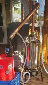

I run a 13 gallon milk can, and used to run one of them "dual purpose" stills. I built a copper unit, and couldn't be happier.
You can build a completely modular unit for about $250 in materials or less(plus the boiler) and have a great pot still, and with just adding additional spools and a reflux condenser, you have a reflux still for neutrals.

@Deplorable - that's a beautiful looking still. For your condenser, is there just a smaller pipe going through the middle of that 2" pipe where the vapor feeds into and then water is cycled through the outside pipe?

Thanks drum!
Thats called a shotgun condenser. There are four 1/2 through tubes in a 2 inch water jacket. Very efficient, and compact design, more than capable of any cooling needs for a 2 or 3 inch still.
If you're thinking of building a still and you have the skills to solder, I encourage you to check out the construction subforum here. Lots of great threads to learn and inspire you.
