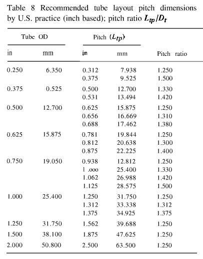

Tube layout
Pitch is the measurement from each tube center to center.
Pitch:Tube OD ratio should be 1.25 - 1.5
example, for .5" OD tube use .625" - .75" pitch
Note: this is a tighter layout than some designs use, more spacing is just a waste of the shell (or ease of fabrication). But this tight spacing lets you fit in more tubes OR use a smaller shell.

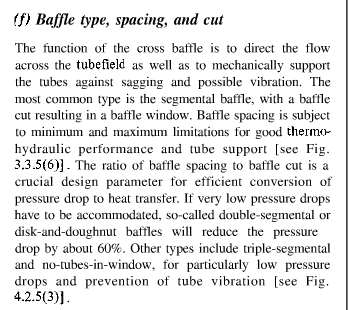

Baffles
I know from experience that pressure drop through a shotgun is low enough to be of no concern to me, so the following uses a segmental baffle. If you have a weak pump or some other reason to worry about coolant flow, the disc and donut style baffles will cause less restriction. (But somebody else will have to share the research on them!)

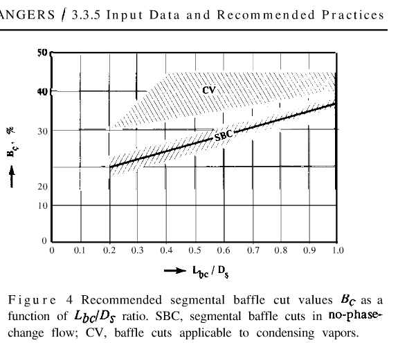

Baffle cut

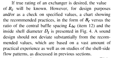

This shows a specific recomendation of the ratio of baffle cut to the ratio of baffle spacing:shell diameter. Use the SBC line, since your coolant will not be changing phase.
Use graph and ratio of baffle spacing:shell ID (Lbc:Ds in chart) to get percentage (Bc)
Use formula Bc = (Lbch/Ds)100 to determine how far from baffle edge to cut off your slice.
I'm using a 2" shell shotgun, so I calculated a 50mm Lbc for a 50mm Ds, giving me a Lbc:Ds = 1.0
I read that as recommended Baffle cut of 37% as a percentage of the shell diameter.
Extrapolating that to Lbch (length of baffle cut height, in mm; aka, how far do you measure in to cut off a portion of that baffle plate)
rounding the Ds to 50mm, and shooting for 37%
Bc = (Lbch/Ds)100
37 = (Lbch/50mm)100
18.5 mm = Lbch

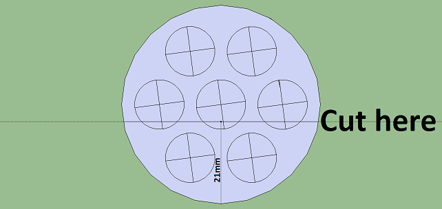

So make your 50mm baffle plate and slice off 18-19mm.
Like this drawing BUT here I read the chart wrong, and used the CV area for a 42% Bc = 21mm! (I just don't want to make a new drawing and I lost the correct one in a HD crash). Besides, I cut it with jigsaw so sub mm accuracy wasnt really possible after all!
There ya go. The shotgun I designed (2" shell, 7 x 3/8" nominal tubes, 60* tube pattern, 2" baffle spacing, 37% baffle cut) worked great, handles all I've asked of it. Of course I didnt actually build a non-baffled or randomly baffled one to compare it to.
