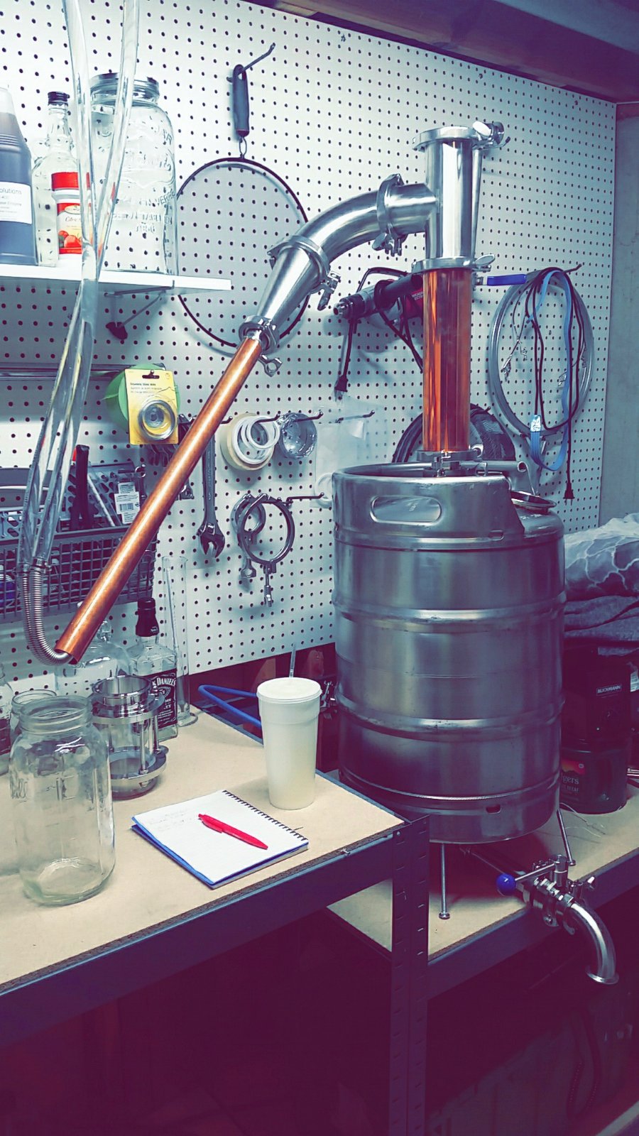

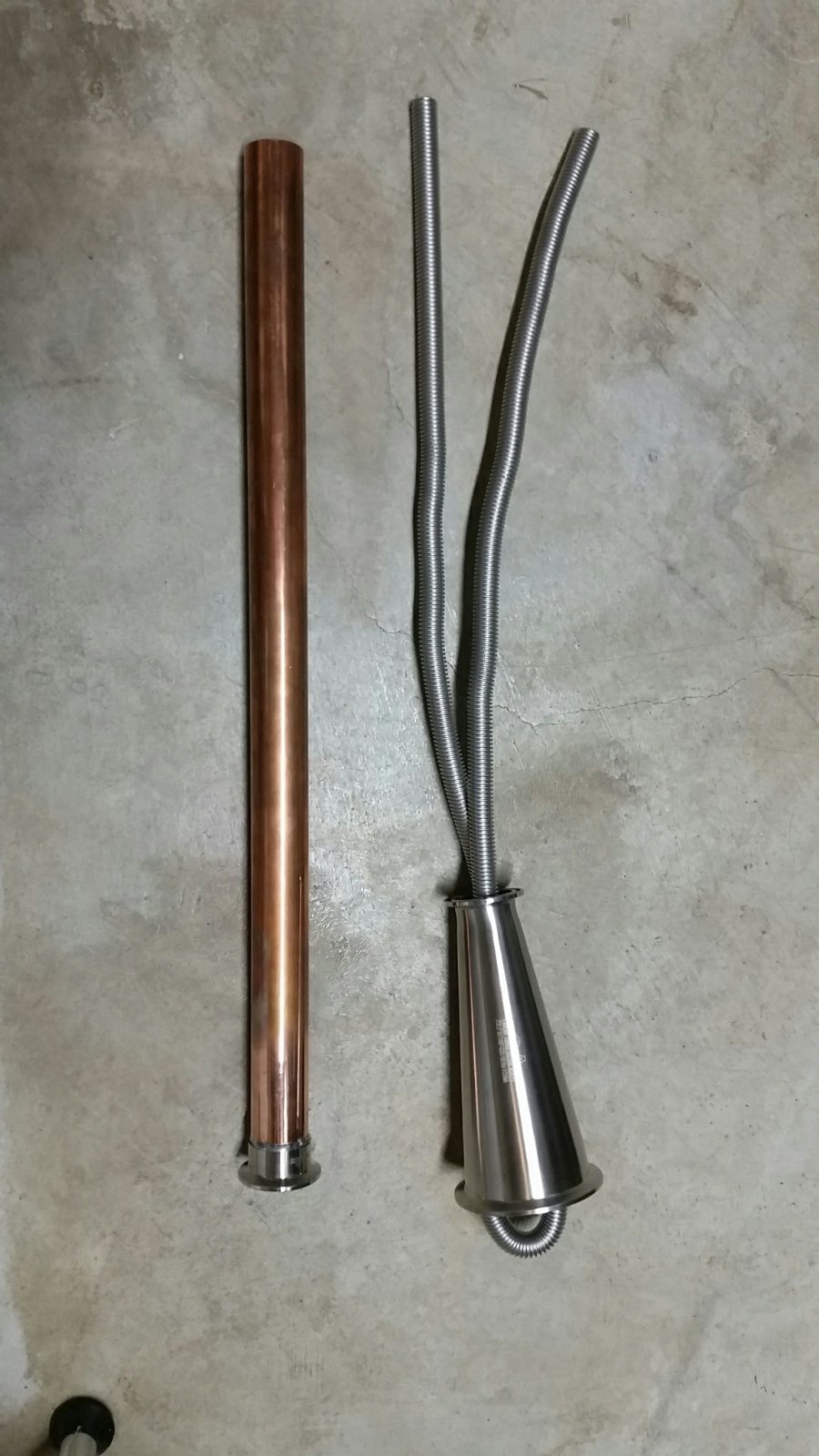

Another dimroth build inspired by dad300 in his ccvm thread. I thought it was interesting and it was claimed to knock down a lot of vapor. My plan was to use a keg spear and run csst through it. The 1/2" csst I bought had a 5/8OD and would not double up in the 1" spear. So I went to menards and picked up a pre cut piece of 1.25 x 24" copper, which just so happens to slip inside a 1.5" TC ferrule.  Got the ferrule soldered on, attached the reducer and ran the csst. So far it's been working great.

Great looking set up, well done :wave:

Tidy!!
