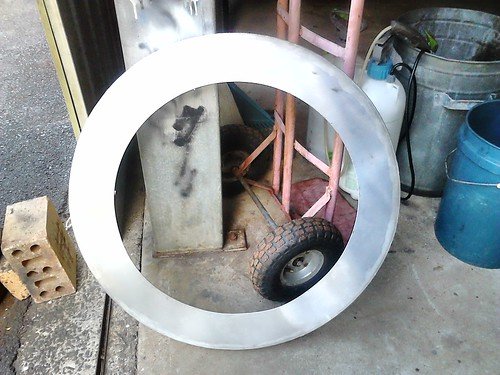

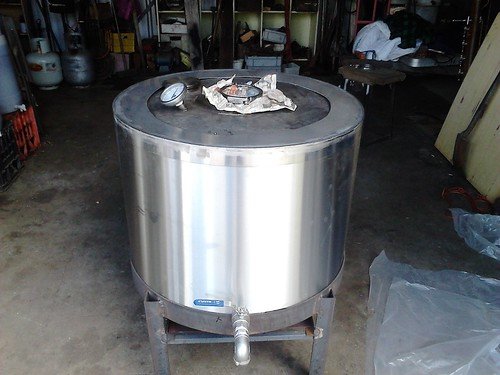

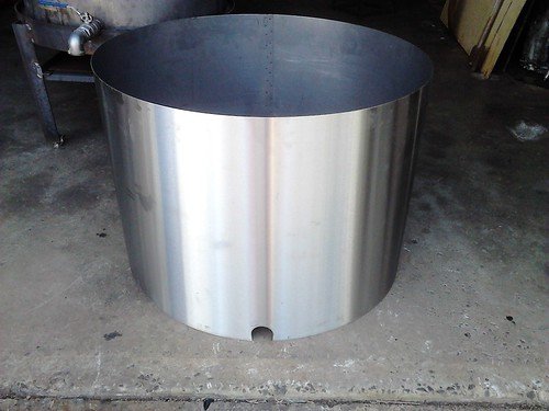

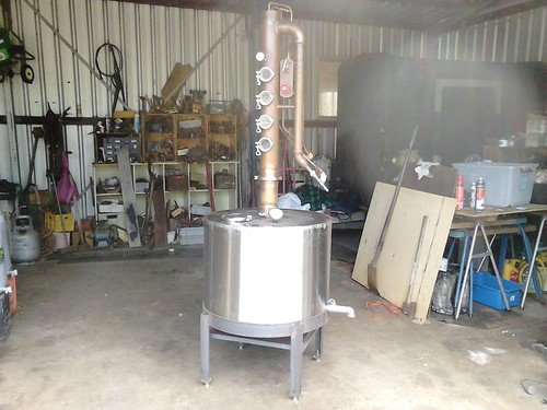

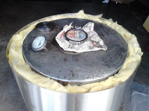

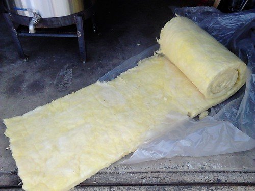

So onto the next part of the build, I'm pretty happy with how this whole project turned out, It hasn't happened over night, more in stages, in between the other stuff life throws at you.
The photos pretty much tell the story.
