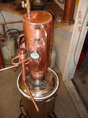

Well, I'm absolutely completely impressed with the results. Grabbed 10L of cheap wine (%12 ABV) at the store, added another 5L of water and ran her. Once the gauge hit 185 she was at %93, leveled off at %80 stopped putting out at %75. Had to crank the burner up and start forcing out product (not a standard practice by any means) and she hit %70 and just quit....Think I got a winner here....Be running the wash through her next week... :mrgreen:

ozone39
Posts: 659
Joined: Sat Dec 12, 2009 9:14 am
Location: Big Sky Country
Re: 6" type L copper ponu still build
Post by ozone39 »
Carries a lot of the grain flavor with it (I run with a half barley and half rye wash). I am currently working on installing a temp gauge in on the condenser side. She is a very sensitive to how much cooling water is applied to the condenser side. My first run with a batch of wash was like watching the movie shakes the clown, (difficult, but funny). But the learning curve is starting to level out and the product is getting much better...

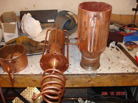

The rebuild/redesign has begun....

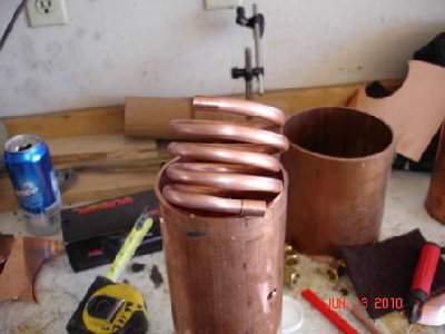

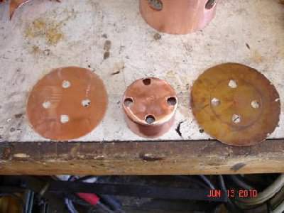

ozone39
Posts: 659
Post by ozone39 »
more progress made today. Try and get it all sweated up later this week...Summer's here so progress is slow..

ozone39
Posts: 659
Post by ozone39 »

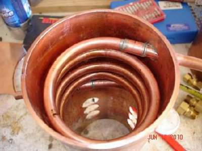

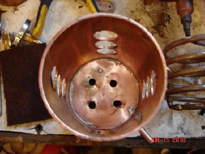

It's still a ponu. I'm just utilizing 4 ea .375" diameter tubes as my primary vapor tube instead of one 3/4". The initial vapor travels up these tubes and back down through the condenser, condenses back to liquid and then will hit the lower coil (not installed yet) and flash off into the secondary coil (this one is installed) and come out as product. I went with 4 ea 3/8" tube to keep it uniform and I would have had to offset the tower to one side to fit a 3/4" piece of pipe..4-3/8" tubes have the exact same surface area as one 3/4" (2.355 sq inches). Thanks again for the compliments, I'm going to try and get her sweated up by weeks end. But with summer here kinda makes it tough..

Steamchamber, primairy steamtubes (4, looking great! :D ) going on top into the condenser, into lower coil. Output throug cooiling coil.
Still the same as the ponu, but what are these big holes?
And when you build the inside (4 tubes connected to the lower coil) pleas send pics!! :ebiggrin:

ozone39
Posts: 659
Post by ozone39 »
Holes are access ports so I can get my torch in there to sweat up all the joints. I guess they will add some ascetics to the still as well.....

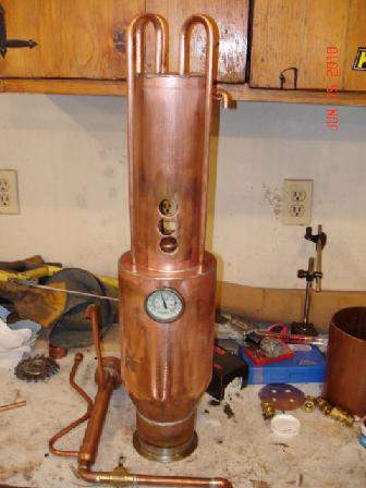

ozone39
Posts: 659
Post by ozone39 »

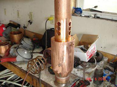

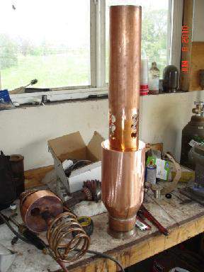

Well, wife is out of town, kids are with the cousins, it's rainy and shitty out, beers are cold and the tunes are loud... These are the elements for progress....Things left to do: install cooling line ports, secondary vapor tube, install parrot.....Getting close..

hstuurman
Posts: 307
Joined: Mon Mar 01, 2010 4:00 am
Location: De Wadden The Netherlands
Post by hstuurman »
Damn man, this is (again) turning to be a beautiful, extraordinary build.
Those 4 steamtubes look great :D , how are you gonna finish these acces holes?
Henk

ozone39
Posts: 659
Post by ozone39 »
Think I'm going to leave them as they stand....

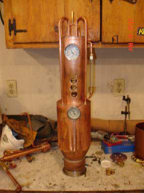

ozone39
Posts: 659
Post by ozone39 »

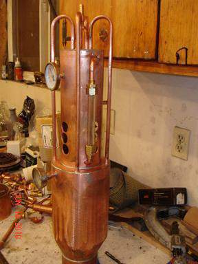

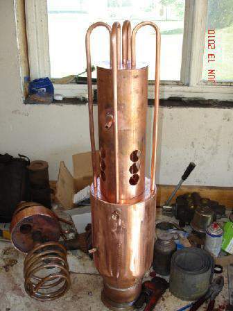

Thanks for the comments guys, I appreciate it..With the old lady out of town things get done..Made some more progress tonight. Really all that's left is attaching the parrot and installing the primer/flushing valve (and distilling of course). After that sanding off the access solder and shooting it in the walnut blaster will be on call...
