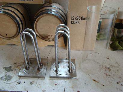

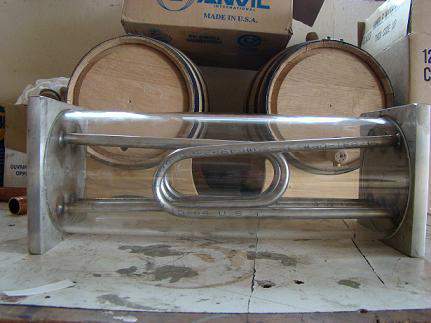

Hi All, thanks again for all the great compliments...The weather here has been holding out (been decent) which in turn means busy work days (trying to beat the snow). As well the condenser has turned out to be a BIG challenge. It will be made simular (s.s end flanges with 4" glass) to the column but will be horizontal (perpindicular) to the steam column. I had to ditch the sphere's on the condenser and am going with a twin plate s.s multiple boiler tube design. Had to order some s.s tubing, and that arrived today. So hopefully I can get things rolling here.

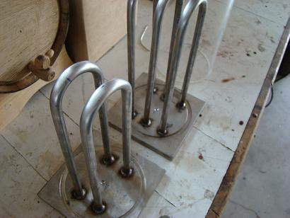

some more progress today.
- Posts: 4848
Re: 4" glass column "coil-less" ponu
Looks like that barrel on the left is thirsty

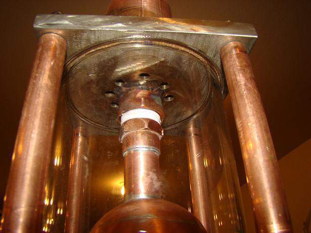

Got collector #1 (out of 4) completed....

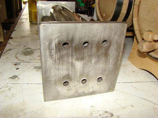

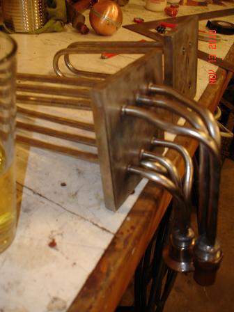

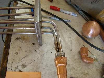

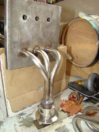

Well, the tough side is done (primary side that has three tubes). Now diving into the easy side (double tube side, secondary coil side assembly)....
