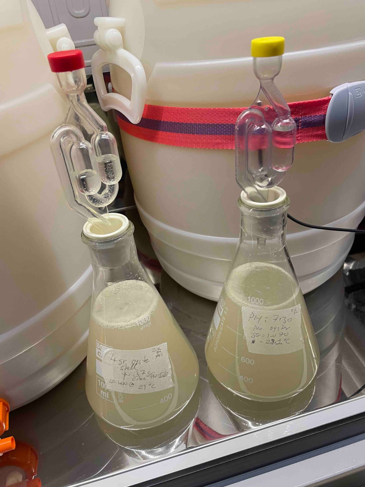

Now I have just started an experiment, doing 2 batches of Shady'sSugarShine, each are 1 liter and SG is 1.070 wash starting temp is 84.2°F set temp is 86°F I am trying to find out the effects of starting with a low PH so I adjusted 1 batch to 5.2 PH and added oyster shells upfront, and in the other batch I did not add oyster shells so there is no buffer to equalize the PH of the wash it will eventually go down just want to see if it will stall and want to find out where it will stall at what PH ? Also wanted to see if starting at a lower PH will make the fermentation duration faster. Again thanks Shady for this great recipe, it is my favorite, will help me to continue my gin journey.

In the past I remember I had a sugar wash crash around 1.020, so by looking at the gravity above, would it be reasonable to add CC in powder form at day 2 ? I will also try this. The reason being the PH will probably be somewhere around 4 or maybe less, I will also measure it, so it will be able to dissolve the CC in powder form, that is what I think.
Because powdered CC has a large surface area to volume ratio, you have to be careful not to use too much and raise the pH over 7 and break down protein.
Whole shell and slabs of marble are more forgiving and won’t destroy your wash unless you leave them in after the ferment goes dead.
Here's what I'm thinking.
Calcium carbonate works good for a buffer, it's not very good for adjusting pH that's gone too low already.
When you start relying on gravity, pH measurements and/or fermentation time to make decisions.
It's possible to make mistakes and head off in the wrong direction with adjustments.
It's simplest, to have a sock with some crushed oyster shell hanging in the fermenter from the start.
