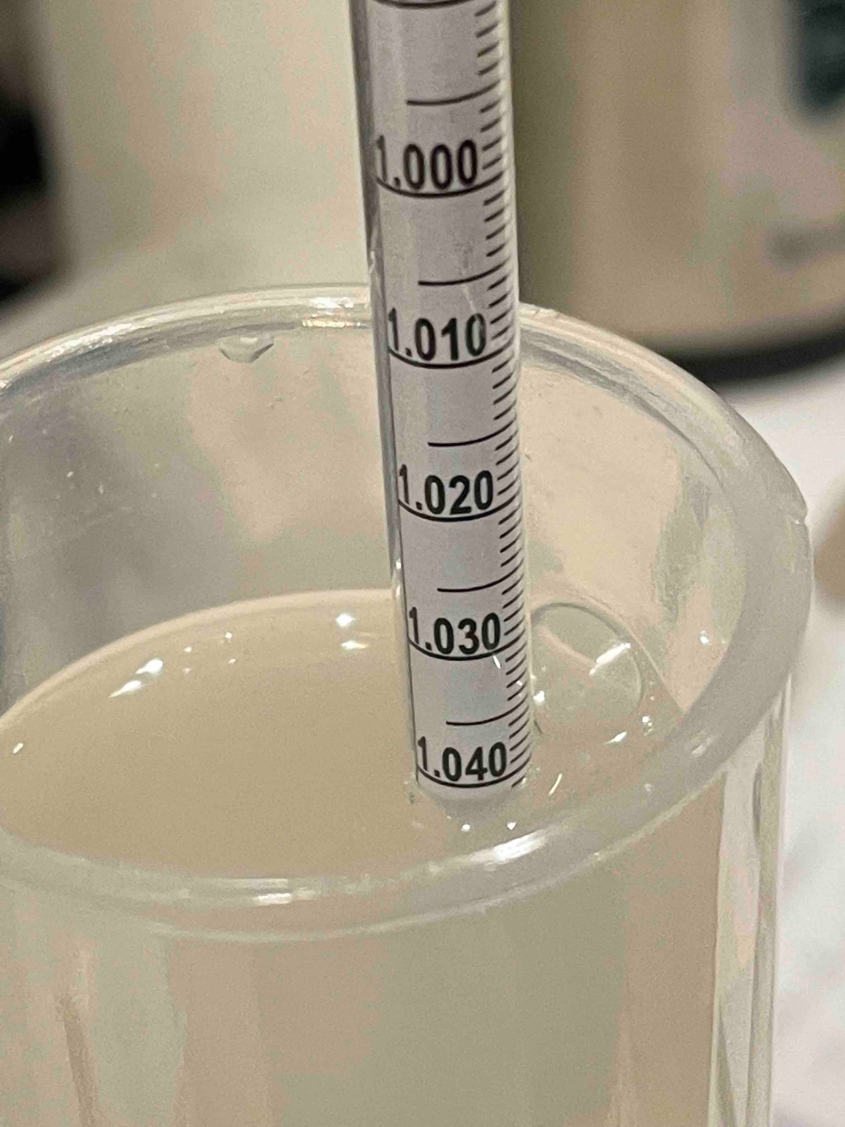

Hi,
24 hours has passed to see the first results of the experiment.
Batch 1: 1 liter Shady's Sugar Shine: ( Dap + Epsom Salt + Boiled Yeast ) + 0.37 grams citric acid / liter + 4 grams oyster shell
Day 0: SG: 1.070 - PH: 5.3
Day 1: SG: 1.041 - PH: 3.78
Day 2: SG: 1.025 - PH: 4.07
Batch 2: 1 liter Shady's Sugar Shine: ( Dap + Epsom Salt + Boiled Yeast ) + No citric acid - No oyster shell
Day 0: SG: 1.070 - PH: 7.30
Day 1: SG: 1.050 - PH: 3.00
Day 2: SG: 1.040 - PH: 3.07 added 1 gram cc now the ph is: 4.07
Very interesting results, first I can see that bringing the wash to 5.3 PH at the beginning of fermentation with citric acid, created a better environment for the yeast so it consumed more sugars and brought the gravity to 1.041 in 24 hours whereas without citric acid the gravity reached to 1.050, on the other hand not using using oyster shell as a ph buffer really took the PH down from 7.3 to 3 which is a %58.9 decrease in 24 hours, quite shocking I was not expecting that, this really got me concerned as I think it will stall after 1-2 days, lets see, But Batch 1 which started with 4 grams Oyster shell started at 5.3 and is now 3.78 which is a %28.6 decrease we can clearly see that the oyster shell is doing its job as a ph buffer. In this case all I can say is, if I am going to use powdered CC I could start adding upfront at the beginning or I can add after 24 hours.

- Posts: 895
- Joined: Mon Mar 13, 2017 9:48 am
Re: Shady's Sugar Shine
Day 2, it looks like Batch 2 has experienced a PH crash, so I added 1 gram CC and this increased the PH from 3.07 to 4.07 now the fermentation resumed, will see the results tomorrow, I updated the above Gravity and PH results.
Day 3: SG: 1.005 - PH: 4.35
Day 3: SG: 1.023 - PH: 4.27
As you can clearly see that the ph crashed in Batch 2 in day 2 so as a result of that I added 1 gram CC to this 1 liter batch, and instantly the fermentation resumed, as if it was waiting for CC
but what really amazed me is Batch 1 as I stated before, I used citric acid and lowered the initial PH to 5.3 I think somehow that speed up the fermentation duration, below I will compare it to my usual fermentation gravity results, I will call it Batch 3. That is a bigger batch of course so everything is same as in Batch 1 except Citric Acid.
Batch 1: 30 liter Shady's Sugar Shine: ( Dap + Epsom Salt + Boiled Yeast ) + 100 grams oyster shell
Day 0: SG: 1.070
Day 1: SG: 1.050
Day 2: SG: 1.030
Day 3: SG: 1.010
So at Day 3 Batch 1 is 1.005 and Batch 3 is 1.010, not much of a difference but Batch 1 is slightly better in terms of gravity drop.
Day 4: SG: 1.000 - PH: 4.46
Day 5: SG: 0.995 - PH: 4.57
Day 4: SG: 1.010 - PH: 4.31
Day 5: SG: 1.002 - PH: 4.28
Hi,
This is the last updated results, in Batch 2 since there was no sea shell in it the ph drop quite fast at the beginning and PH crashed on day 2 to PH:3.07 so I added 1 gram cc per liter due to that I lost 1 day in fermenting, at Day 5 the first batch is 0.995 and the second batch is 1.002 there is a 0.007 point difference which probably caused due to the ph crash but when I look at final ph results Batch 1 with sea shell started to show a gradual increase from 3.78 to 4.57 which shows that leaving sea shells in the wash increases PH and risk of infection due to that, but in Batch 2 where I added powdered CC at day 2 increased from 4.07 to 4.27 then 4.31 and finally today 4.28 which is much more stable in that sense.maybe 1 gram per liter is just what it needs ?but when we throw in a sea shell the amount could be too much where it dissolves, in my case the sea shells was 4 grams in weight whereas in Batch 2 I only added 1 grams, so Batch 1 is 4 times the amount.
Day 6: SG: 0.992 - PH: 4.63
Day 7: SG: 0.991 - PH: 4.75
Day 6: SG: 0.996 - PH: 4.36
Day 7: SG: 0.994 - PH: 4.41
I can call it finished, but it is very clear to me that adding powdered CC 1gr/liter with citric acid ( the amount will vary due to the composition of your water) will be ok, so my next experiment now will be in 2 batches again everything will be the same but I will add powdered CC to both of the batches upfront but will only add citric acid to one of them, so see if the acid really helps or not needed at all. But as you can see adding CC at a low amount will keep the ph to the end of fermentation quite stable, it still goes up but not as fast as the one with oyster shell.
