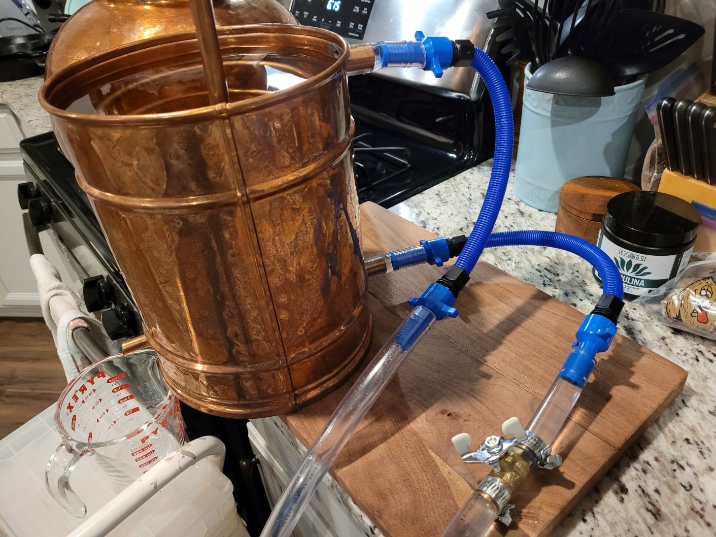

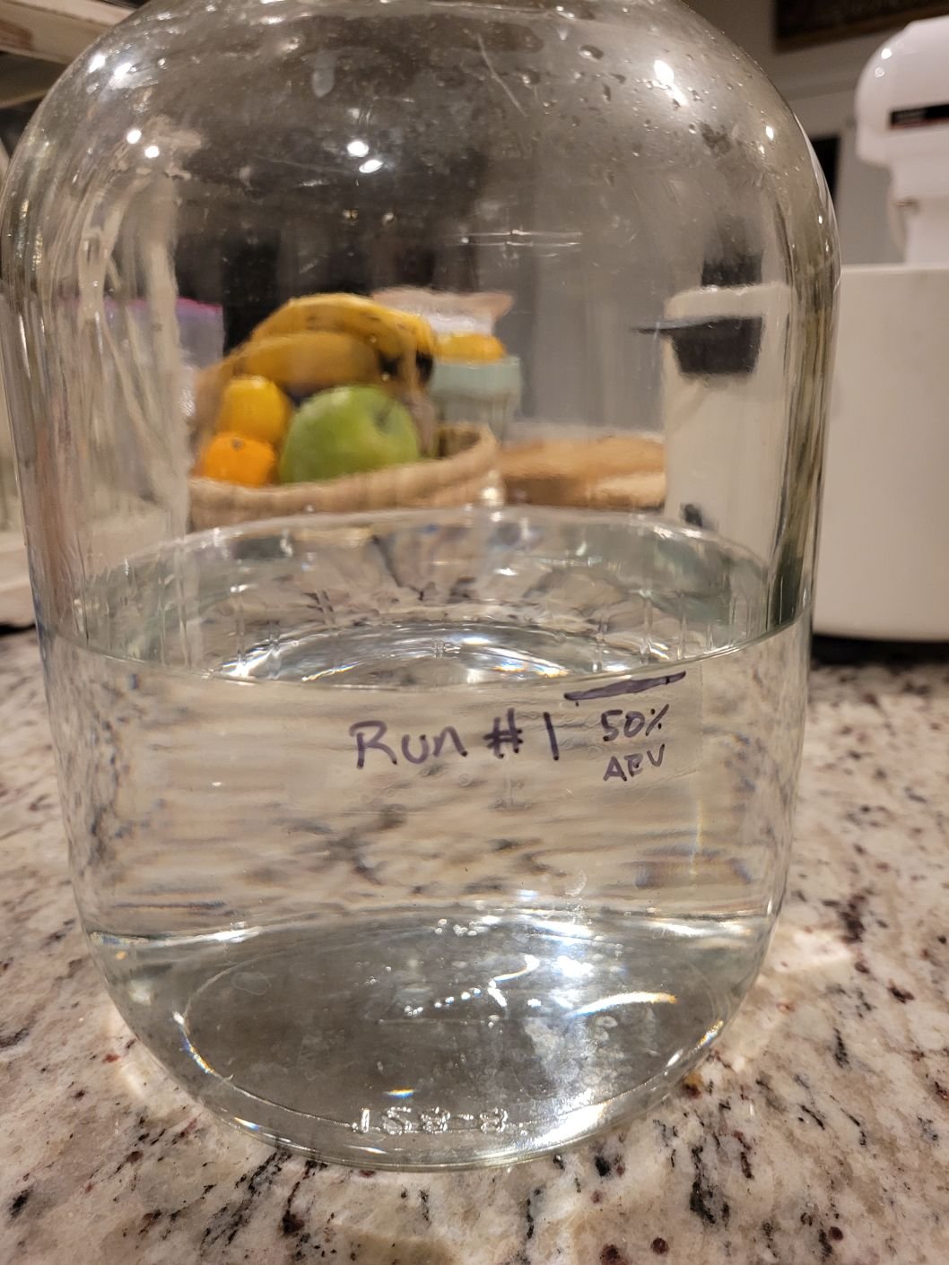

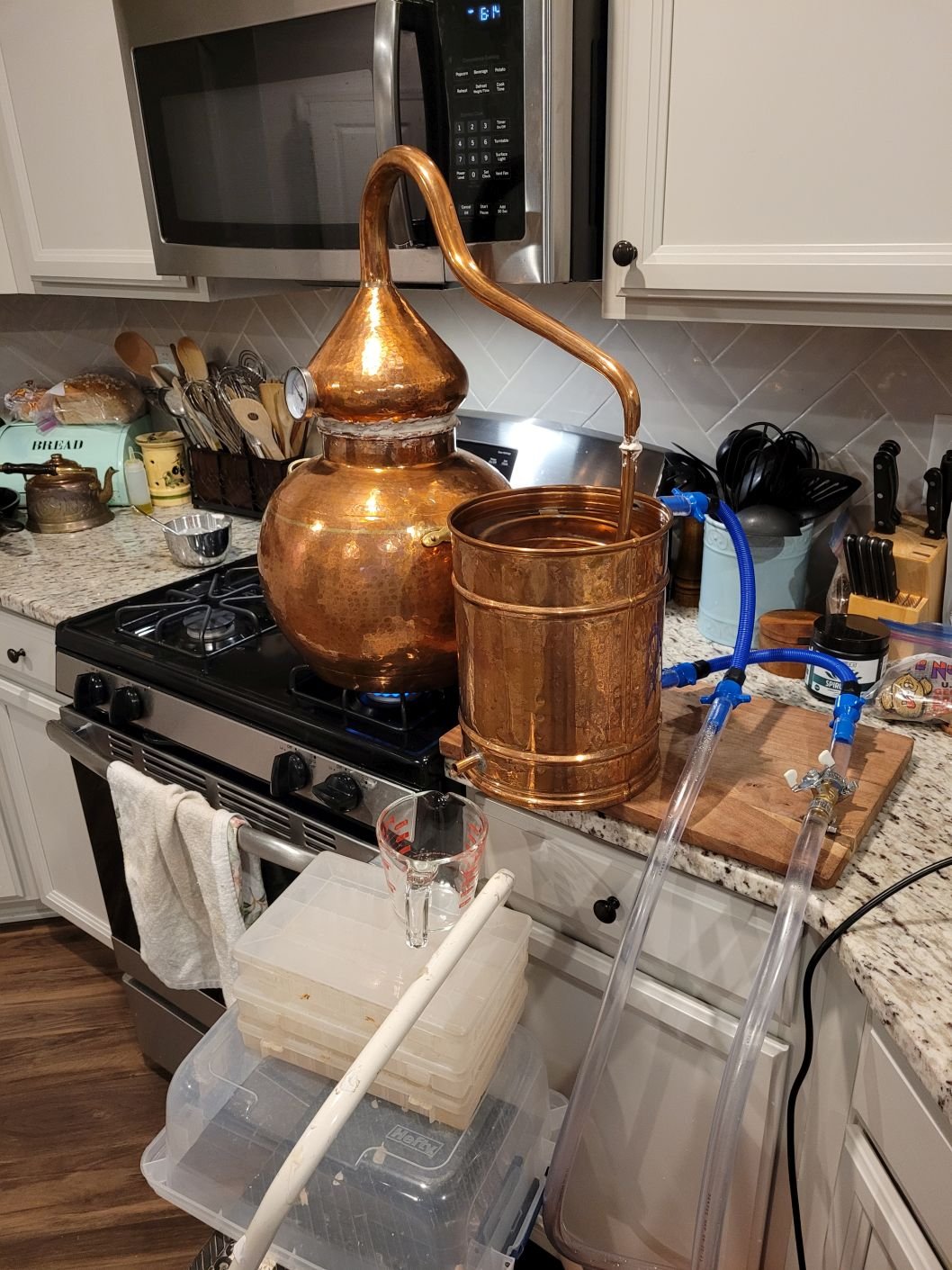

I am in the process of doing stripping runs on this recipe and thought I would share my experience so far. This is also the largest wash I've done (~35 gallons) so thought I would share how it's going.
I used 10 lb bags of organic raw sugar I got from Costco. (https://www.costco.com/kirkland-signatu ... 34874.html) I started with 50 lbs of sugar and dissolved it into ~33 ish gallons of water. Original gravity was 1.070.
The only thing I added to the wash was some fermaid, epsom salt, DAP, and oyster shells. Started fermenting well right away. On about day 3 things started to slow down, but didn't stop, and gravity was still high. Temps were too low (75 ish degrees) so i bought an aquarium heater and brought things up to about 86, added more yeast and some more fermaid and things picked way up. Strong ferment for about another 5 days and eventually finished dry after 7 days total to about .997.
My pony keg boiler and homemade copper head / Leibig seem to be imparting some off-flavors, so borrowed my friends copper pot still, which unfortunately is only about 3-4 gallons. So I've got a ways to go, but here were the results on the first stripping run of 3/4 gallons of wash:
5:50 PM - charge still and add heat (gas stove) starting temp 75 degrees
6:55 PM - First drops of product - vapor thermometer reads ~160 degrees (take first 150 mils as fores)
8:30 PM - Tails begin - temp is 205
8:43 PM - Remove heat / finished 35% at last reading
I collected just under 1/2 gallon of product, and the blended (no cuts / stripping) product is 50%abv. The product is sweet, mild, and very drinkable, surprisingly so.
I guess I'll keep at it in 3/4 gallon batches until I work my way through all 30 gallons .. or maybe I'll convince the wifie we need a bigger boiler / still
Anyway - Just my experience so far...
