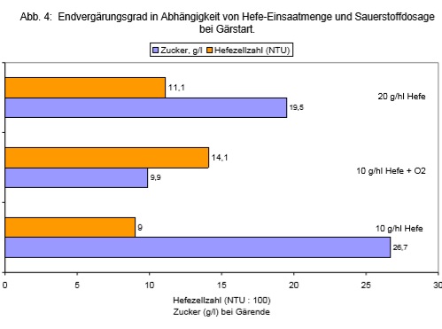

I asked myself: why not add two doses of live yeast in stead of killing one dose and add the other alive.
This article https://www.schneider-oenologie.com/dow ... aerung.pdf" onclick="window.open(this.href);return false;" rel="nofollow suggests that your method is better, because the added live yeast feeds on the dead (as expected) and becomes more than twice as active.
(But I find it hard to close my ears for the desperate shrieking of yeast cells in the hot water. I keep telling them they die for a great cause and the greater good and contribute to a better spirit, but they seem not very convinced.)

Post by Kareltje »
Try automatic translate. I could even understand Russian and Polish.
The relevant part:
Amount of yeast vs airing
One can ask whether the improvement of final fermentation as reached with airing can not easier be reached by adding more yeast cells. To test this we made three washes: one with 10 gr/l of yeast withput airing, one with 10 gr/l with airing and one with 20 gr/l.
The result is in abb. 4. We see that doubling the yeast from 10 to 20 gr/l results in only 57 % higher final yeast cell count. With enlarged seeding of yeast the growth rate diminishes. The highest end cell count was reached with 10 gr/l at the start and additional airing. So we see that optimal oxygen dosing is more important than yeast dosing for getting a dry wine.
