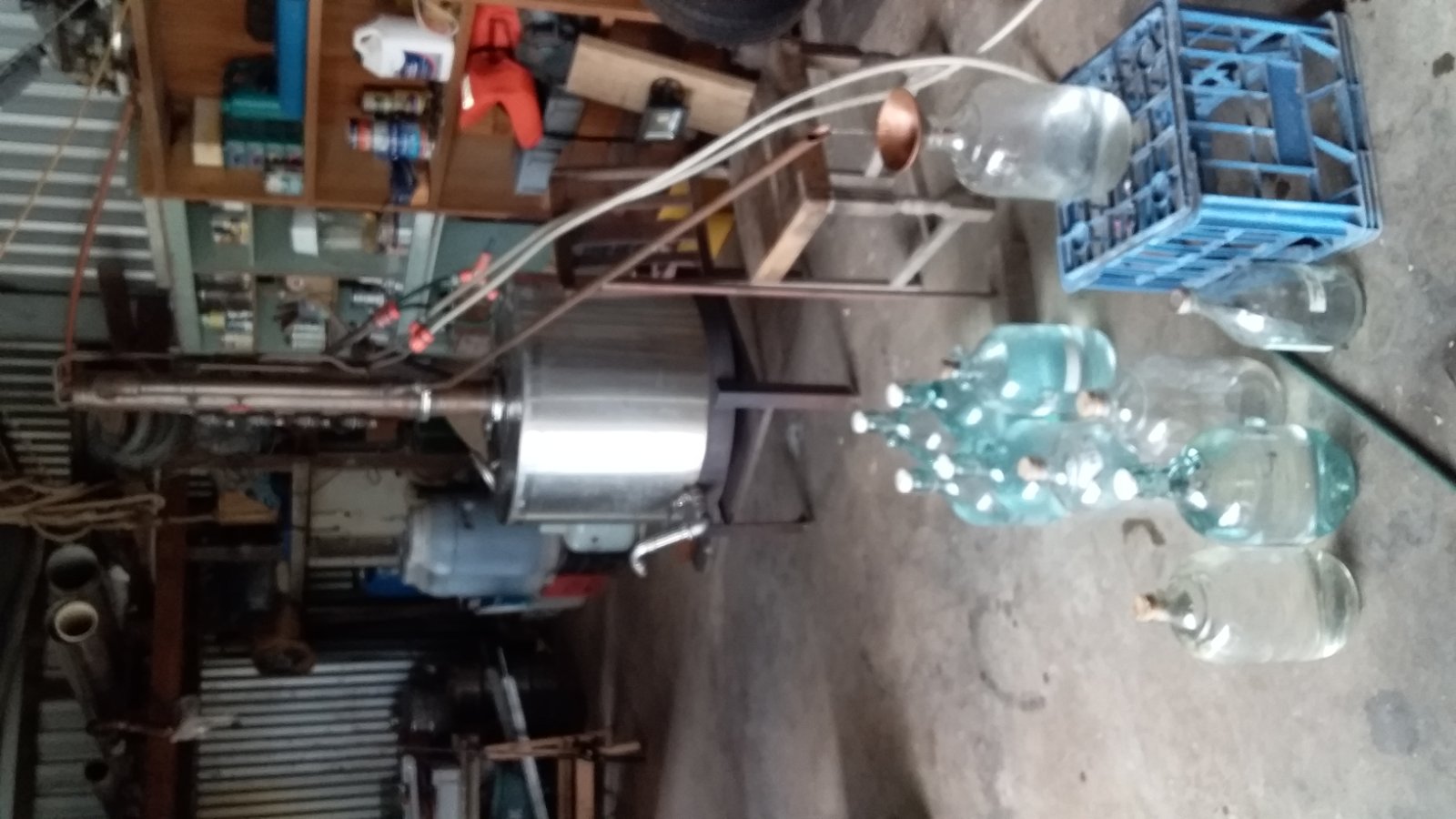

Excellent recipe
Put down a 150 litre wash about 6 days ago, looked finished and tasted done yesterday. Popped one of those fandangled hydrometers in and it read 990.
Stripped it today , low wines taste and smell very very clean . Can't wait to clean it up further with the 3 boka.
If the low wines are anything to go by the spirt should be exellent
