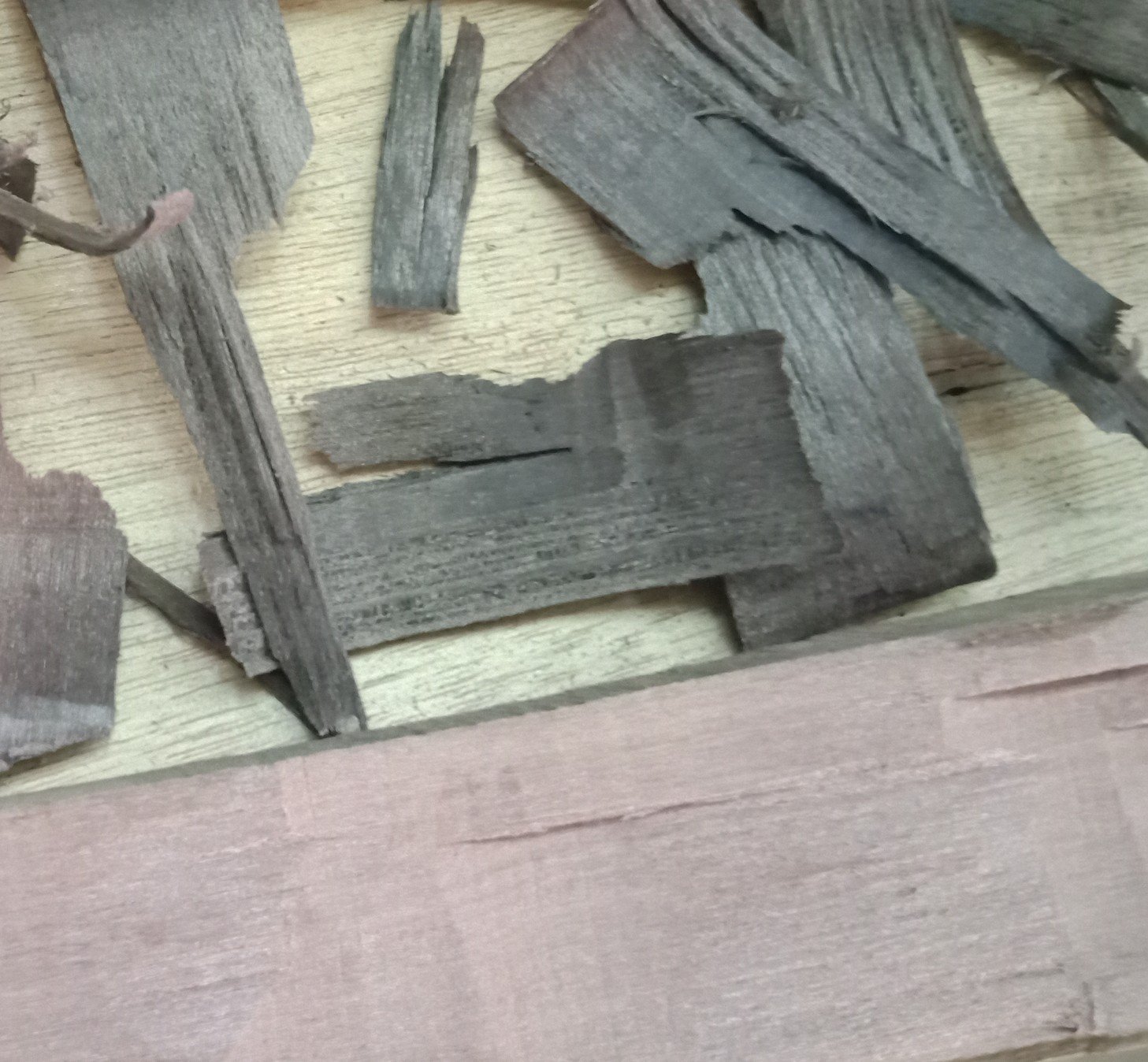

I've had some good results with some flash ageing with some local tropical red oak . I use thin chips that I toast in the oven for 15-20 min at 500 deg until the color changes. I've soaked the whiskey for a day, any longer seems to produce too much wood flavor then for a hour or two in a pinch of jasmine black tea. This seems to work quite well. I know it's quite unorthodox, but it passed the whiskey coke test in that it tasted exactly like a good whiskey coke even though I prefer it straight up.
SGB
Posts: 225
Joined: Thu Apr 09, 2020 1:21 am
Post by SGB »
Wood after toasting

Posts: 18359
I use a propane gas torch to char and re-char my wood chips, lot faster!

Bushman wrote: Thu Jun 11, 2020 5:36 am I use a propane gas torch to char and re-char my wood chips, lot faster!
Well. .. After the oven, I do use the torch to give one side a final char. I just don't don't have a picture of that process because my hands were full. .
In the end, better wood would be better. That's for sure. But for now it's OK. I'll continue to work on improving the process
