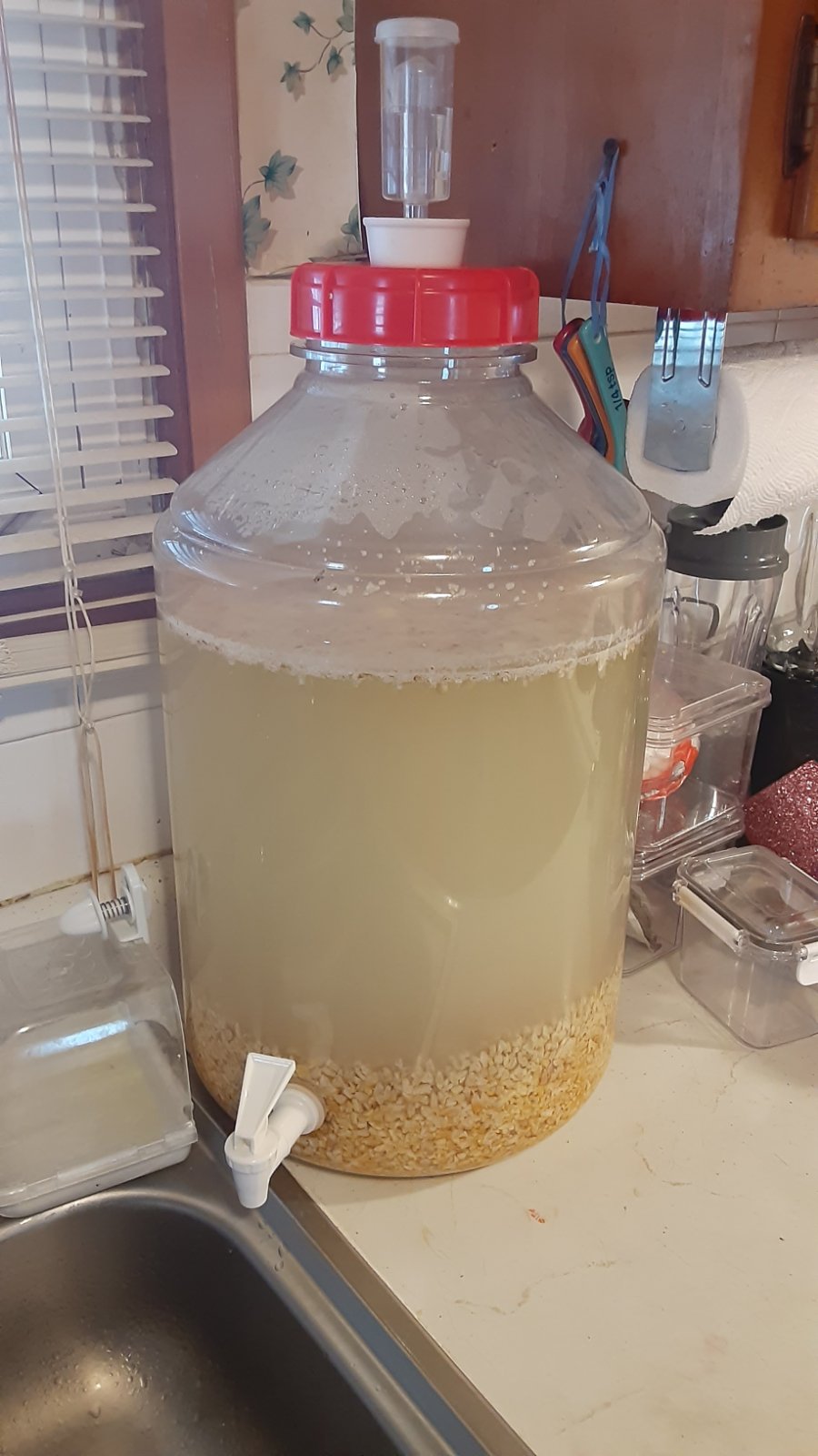

Seems to me that they are meal worms from the corn. Usually I mix the corn in with hot backset and sugar but last time I didn't, just added the corn at the very end . I was surprised to see that they were all alive happy.
I guess the ABV didn't bug them at all....
- Posts: 51
- Joined: Thu Feb 07, 2019 11:38 am
- Location: Ohio
Its your corn, you should go through it and find them and get rid of them. Worms and weevils can be found in corn. I store my corn in tubs, I get it from a local mill and who knows what goes on there. I lightly tape a silicate park to the lid to dry it all out.
- Posts: 10582
Might add some flavour ....Id strain them out n run it. If it doesn't taste good give it to free loaders that you don't want visiting again.
- Posts: 13949
You are what you eat and they've been eating corn. I ignore critters except to get that batch of ingredients done quickly before they contaminate something else.
