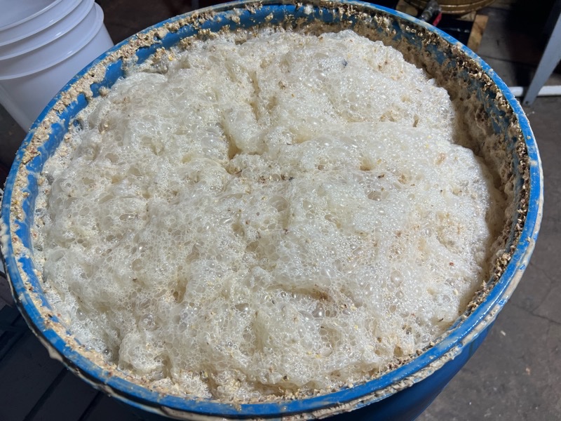

Trying out a few batches of UJ. Only filled the fermenter up about 2/3’rds and pitched yeast Sunday. Tuesday afternoon and it very active!
I used AG backset and FermPro900 yeast. Seems to like it :)

I think you’ll be happy with your results. UJ is so easy compared to AG
