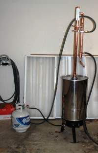

Your question has been answered but I would love to see pictures of your 30 gal rig :D

Say hello to my little friend... :lol:
Thanks for the advice. Cleaning now in process! Good stuff soon to come!!

Thanks for responding so quick. Not the one I wanted to attach... Fixed.

Much better, that is a nice looking rig. Since I was one of the few, if not the only person to see you........your ugly :) :) :)
