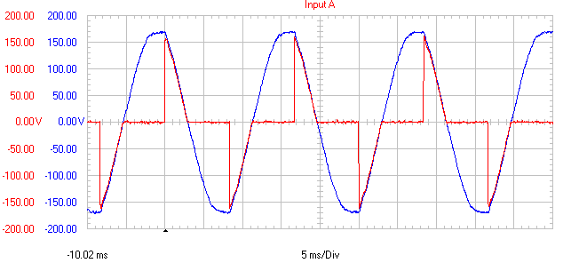

mash rookie wrote: With all due respect I am not sure why you insist on using it wrong.. You need to use it as designed.
You exactly right - it needs to be used as designed. Unfortunately it's not designed for non-sinusoidal AC waveform. And AC waveform after phase-angle controller is not a sinus.
BTW - do you understand how phase-angle controller works?
Blue curve represents voltage on controller input (sinusoidal form), red curve is an output at ~40% of power. As you can see it doesn't look sinusoidal.
It is intended to show you line voltage in and amperage draw.
It's not so straightforward for AC as you think. Do you know what voltage and amperage this devise shows - RMS, Peak or Average? If it's not RMS you can not use it for power calculation. Please read this - http://www.allaboutcircuits.com/vol_2/chpt_1/3.html" onclick="window.open(this.href);return false;" rel="nofollow and the chapter "Average electrical power" here - http://en.wikipedia.org/wiki/Root_mean_square" onclick="window.open(this.href);return false;" rel="nofollow
What do you expect to learn? Do you understand power application relative to distilling?
I'm trying to find a way how this meter can be used with phase-angle controller and how correct it's reading.
My conclusion:
- You can not use it to measure voltage on heating element since it's power supply limitation.
- You can use it for amperage measurement, but reading not very accurate.
I see no value related to distilling from your post.
I hope that other forum members will see a value .
What exactly you don't understand from my post?

mash rookie wrote:If you are saying they dont work I suppose I am not surprised for $12.
It works OK, but only if no phase-angle controller involved.
Please explain what I might understand by knowing voltage on the element? How I can use this information? I guess this is my misunderstanding about your post. I am missing something.
My reason for wanting the information this meter advertises is for calculation of vapor speeds as I continue to study different packings and reflux ratios. If it is inaccurate it still may have value if it is consistent. It will be easier to record than analog.
To calculate a vapor speed you need know power dissipating on your heater. To calculate a power you nedd to know RMS Voltage and/or RMS amperage.
If you are using phase-angle controller than analog and cheap digital Volt/Amp meters give you wrong reading. And you'll get completely wrong power value based on that readings.
Please read this article - http://www.allaboutcircuits.com/vol_2/chpt_1/3.html" onclick="window.open(this.href);return false;" rel="nofollow
It describes AC voltage measurement, Power calculation, meaning of RMS etc much better than I can.
