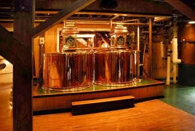

Don't get me wrong... Copper patina looks good. Shiny copper looks good. I just happen to prefer shiny. With all the work we'll have put into our still, I would just prefer it to stay looking like this...
