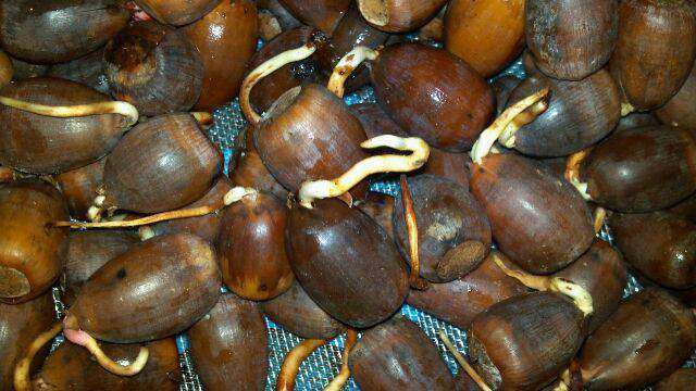

BD, no problem, I knew what you ment. They have sprouted rootlets very well, ( sprouts about 2"long long on most all of em). White oaks are of course dicots, not monocots like grains. They sprout a little different. They first send out a rootlet then off that a little, a shoot will form. I can't see any shoots yet. I've read that they do that as a protective measure from freezing until spring warm up. Thinkin maybe I should warm them up?
here's what they look like now...

When I decide to stop the sprouting, I'll need to dry them out. This will make the shells and the brown protective layer, brittle. Then I'll put them in a sack and beat the sprouts and some of the shells off. Then I'll have alot of work to do cleaning them up. After I'm down to just meat. Then I'll begin soaking them to remove the tanins. This is the point I was concerned about in the other thread. Will this leaching to remove tanins also remove the enzymes? I'll soak and rinse several times in cold water. The cold water should atleast slow the enzyme activity down, but will it be rinsed away??? We'll see...
Hope this answers some of your questions too durac11.
