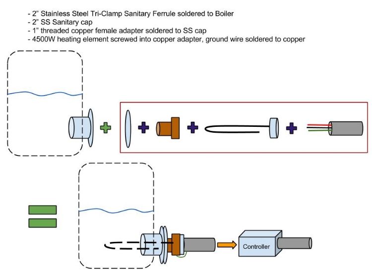

- Heat source is 4500w 240v ULWD straight foldback heating element. I've thought through a lot of options for how to attach it to the keg and I think I have a solid plan now.
- First I bought a 1" threaded female copper adapter, I think Rad and some others talk about that as an option in the heating element thread. Plan was to solder that to the keg and run the ground wire to a screw down on the base of the keg. There were some things I didn't like about that. Then I saw a link to one of the distiller/brewery places where they used a tri-clamp fitting that was threaded. That would work great, except I don't have a metal lathe. Then I saw that I can order a 2" SS ferrule fitting and cap and so here's the new plan. I think it will work well and allow me to disconnect between runs, use the opening as a drain for easy cleaning, keep the element out of the way and clean, and cap the opening to keep dirt/bugs/rodents out.
