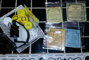

I feel like I'm opening myself up for a lot of criticism but here goes. I'm an outlaw distiller and an outlaw cheese maker. Many years ago about a year into learning to make cheese I realized that the two hobbies go together, in that I keep living culture that I can use for both. So if you don't already know you can buy cheese cultures and store them in the freezer for many years. Here's a two pictures of my cheese culture and towels rapped around 4gl ss pot, that is the yogurt (slur )
Not much to see but this is now I keep it warm
2015-07-14 14.22.52.jpg (45.65 KiB) Viewed 8665 times
Cultures
Cultures

I've used a lot of cheese and yogurt packs like those but never made cheese or yogurt :-P
After tons of testing, I found exactly what Jimbo said - temp and pH is really the key. Now I just sprinkle some dry malt on the mash once the right conditions are met. Let it sit overnight and it's pucker city.

That absolutely that does work and works great. I just did a scotch that way, fantastic. myself I've done this stuff for so long and I'm very comfortable with that I'm doing and how to get the flavors I want, I find it changing to force the flavoring I want.

Yeah, I had great results with the various culture packets from the homebrew store, but I've got to factor in the costs as I scale to 250 gal batches. Letting the grain and Terroir work its magic sounds good to me.
