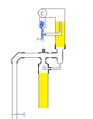

I have decided to go with a different design than I had originally I found this posted by myles and have decided to go with this concept.
I have three questions about it that I think are the last little bits I need to clarify to feel ready to give it a go.
1. Can anyone see any issues with this plan that I might of over looked?
]Image
I have 54mm column packed about 1400mm high with copper then a male and female threaded joint to connect the head, then reduce to 28mm, T at the top left side a lever ball valve in horizontal, keeping the horizontal as short as possible, on the right all still in 28mm another T, at the bottom 8mm returning to the main column just above the threaded joint, at the top of the T increase back to 54mm and have more copper packing, then. 90' to the horizontal condenser (slightly angled to take off) use 10mm to return to just above the packing. I understand this may be difficult to picture so if I get my laptop back soon I will put some dimensions on to the picture.
2. Can anyone clarify the way this heads trap bit works?
From what I understand is that as the wash heats up and the fore shots and heads rises it goes to highest point, condenses returns to the second lot of packing where it converts back to vapour, possibly even returns to the first lot of packing early during stabilisation, so once stabilised it is stuck in a loop at the very top. (Really struggled with understanding the 'flow', very visual and hands on type of learner)
3. Am I right in thinking that the operation of this would be to turn the heating element on and wait for the still to stabilise and then just open the vm port to collect the hearts? So I would not need to open the valve below the condenser to drain the foreshore or the heads.
Oh and one about liebigs, I have read about them choking the product take off, I had thought I would reduce down from 28mm to something like 10mm to run through the liebig, and inside the liebig I would loosely coil the product pipe to increase its path through the water jacket, I havnt found anywhere that mentioned sizes I know I would stay 28mm until after the 90' and was traveling down.
Any guidance is much appreciated

Well, the design itself is ok and Myles is a experienced builder/distiller.
But fact is..this is far more complicated to build than it needs to be.
Now i don't know your skills with tools or what kind of tools you have access to, but with two external refluxlines, offset LM etc...this build requires more fittings than necessary.
Further it will require some good metalwork skills to get a decent result out of it.
My advice would be to ditch the Nixon Stone concept alltogether, ...hmm...i belive Bellybuster was complaining about his slow N S still.
There are better and easier designs to build.
If you want a LM/VM combo, why not make a VM with a LM on top of it...? It would be way easier to build than the design you are proposing. :idea:
Still stirrin gave you good advice...also with a potstillhead. Surely i wouldn't be without mine, as it serves two purposes...stripping and/or whisky distilling.
Edit Oh..btw i forgot to answer your questions:
As the vapors rise they eventually reach the refluxcondenser. Now as they change from vapor to liquid again , they simply drip straight down into the small collection reservoir below.
On this reservoir there is a valve that allows to bleed off the foreshots and heads.
If the valve is closed, the reflux takes the path through the refluxline and into the still again. From there straight down and eventually it ends in refluxline two.
Both lines are with a 90 degree bend on them to create a liquidlock, that prevents vapor to travel directly through them.
No.. The idea with the headstrap/reservoir is to bleed off foreshots and heads as explained, and THEN open the VM path for the vapor.
It will prevent your productcondenser from contamination off heads/foreshots.
10mm diameter for a Leibig will be way to tiny on a VM..!
By "coiling" the productpipe, you will end up with a Grahamcondenser and not a Liebig..which one do you want to build..?
Have a look at my little "aftercooler" here... : http://homedistiller.org/forum/viewtopi ... 87&t=54834

I'm confused, I thought the point of this design was that the bit directly above the top most valve where the blue squiggly lines are was to trap the heads? That this would be built to hold the volume of heads you expect and that the level that chamber holds is directly controlled by how far up the reflux return line goes in the top heads column?
I understand what you have said about drawing off heads via the valve etc, as per a standard vm/lm set up such as a double slant plate above a vm take off, but I was under the impression that this design was an offset lm head that would trap the heads and make this part 'automatic'
As for the pc I'll read up about that this evening

Well, the intention with this device might very well has been to trap the heads.
Anyhow, this can cause a little problem.
Sure one could calculate and measure the "standart" amount of foreshots and heads and dimension the reservoir from those datas.
But as this still has only one refluxcondenser, the rest of the distillate will mingle with the heads in the reservoir, unless they are bleed off prior. :!:
So one would have the rest of the run contaminated with the stuff already in the reservoir, rendering the device (as a headstrap) useless.
Edited to add:
The simpler way to do it would be like the drawing i attached.
Sorry for the crappy drawing, but i think you get the picture.
You would eliminate one refluxline, and have a reservoir with a drainvalve at the bottom.
A slight angle on the reflux return, would assure everything is drained as long as the valve is open.
Close the valve...and have all reflux returned to the column.
Note...the 90 degree bend on the refluxline is still there...and HAS to be there.

So I take it these are essentially the same but at the top of your packing in heads column you have a virtical condenser? And this is operated like an lm still until ready for the hearts then it's operate like a vm?
Would a resivoir like in the first drawing mean that the heads could be drawn off at a quicker rate?
I had come to this design after reading about keeping reflux path clear of the product take off area and also speeding up heads removal.

J4k3, the Nixon-Stone offset head is an older design (very effective, granted) but a little more complicated to build. I would suggest looking at Rad's concentric design for the LM collection cup.
It's an annular cup that collects the condensing liquids (instead of the slanted plates the Boka uses). The concentric reduces from the 2" column down to 1" ID (or possibly 1-1/4" ID) and that inner diameter forms a cup in the upper condenser core (not a wound coil, but a pipe in a pipe somewhat like a Liebig condenser). Mine is a 2" outer shell with an 1-1/2" inner shell, which leaves me a 1/4" annular cup to collect the liquids in.
One big advantage of the concentric reflux condenser is that it uses static pressure changes in the flowing vapor to enhance the condensation process. As the vapor accelerates through the throat section and slows down when it enters into the condenser chamber it initiates condensation on the inner wall of the condenser. That liquid drips down to the annular collection cup and collects, spilling over when enough liquid is collected. That spillover then is reflux back into the center of the column.
If you look at Rad's build, you'll see that you don't really even need to buy expensive fittings because you can wrap copper wire or tubing around the inner diameter to fill the gap to the next larger pipe diameter. Once soldered in place, it's a very good structural closed loop system.
And as Danespirit described, you reflux as the lighter/higher alcohols and solvents in the fores and heads collect at the top. A smaller volume for the liquid collection helps reduce the smearing between fores/heads and hearts. And once you've collected the fores and early heads through the LM takeoff, then you can open your VM valve and proceed collecting the late heads and hearts down to the early tails. With the VM, you'll see that production just about stops when you reach the tails, so if you want to drive deeper then you can switch back to LM controls.
In conclusion, the N-S is a slick looking still head, but it is a little more complicated to build and dial in. I like the combination LM/VM still head because of the flexibility in the way it runs. I am a HUGE advocate for the concentric LM because of the simplicity and ease of operation. And I like to run VM through the hearts as it is very easy to run...just let it do its thing.

The takeoffrate isn't determined by the physical meassurements of the reservoir.
It's entirely dependent on powerinput and how clean a endproduct you want.
As your refluxrate goes up, your takeoffrate goes down.
Well, you want to design your still in a way so the falling reflux don't splash into your takeoff, rendering the whole design of a packed column worthless.

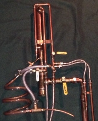

Here's an (ugly) picture of my combo head. You'll see I have a vinyl jacketed Liebig cooler for the liquid takeoff (it's the curly coil).

This is the condenser during the build. Notice I flattened some small tubing and soldered it around the 1-1/2" condenser inner tube. That's the condenser's inner wall. The pipe is open at the top and concentric with the 1" vapor tube.
Concentric condenser in work
This is the view from the bottom, where it will attach to the VM 2x2x1-1/2 tee.
Vapor inlet below the condenser
You'll not that I used rolled tubing to make some of my diameter changes because they're shorter and much less costly. I followed Rad's advice to do so and it worked great. But you've got to pay attention when soldering thing up.
It took me a long while to build my equipment. But that way, I got it right for the way I want it to function.

still_stirrin wrote: You want the cup sized to retain 1 to 4 ounces, but keeping it around 2 to 3 ounces will minimize the smearing. As this collection cup fills with condensate, which it will during your initial reflux stabilization, you adjust the liquid takeoff rate by the needle valve. It can be increased in speed up to the rate at which your condenser knocks down the rising vapors.
In terms of operating it, as the still stabilises, could I have the valve open to collect the condensate as its produced or would I still have to wait for it to stabilise first?
still_stirrin wrote: Here's an (ugly) picture of my combo head. You'll see I have a vinyl jacketed Liebig cooler for the liquid takeoff (it's the curly coil).
There's a lot going on there :D I like it. Why do you have a Liebig on your lm take off?

The idea of the Liebig on the LM side, is to provide extra cooling for the distillate. :idea:
A typical LM as for example a Boka would originally rely on the refluxcondenser as the only coolingmethod, thus the warm product.
Thoughts went in the same direction as my "aftercooler" i linked to in my post previously. I can use it as additional cooling on my Ethylisator, during the summertime when the tapwater is relatively warm.
He went with the more elegant coiled solution, think he wanted it to take up less space.
Putting a tube in a tube would be very difficult without special tools to bend/shape the piping, hence the vinyl hose as a outershell.

J4k3,
The Liebig coil cools the liquid...what ever liquid is collected off the LM valve. I built it this way for versatility. I can run purely LM if I want to...and I have on occasion run only the LM. It gives me operational options. The Liebig simply cools the product so I can collect it (when I measure the proof) in jars for airing and later making the cuts.
Without the Liebig, the liquid comes out hot....too hot to manage. If I was only running LM, all of the collection would be too hot to measure without secondary cooling.
Why? That's why I did it YMMV.
And for the question regarding rolling a coil and the concentric condenser...make both and see which is easier to make and which functions better. Go for it!

Cool, I had gathered it would be for versatility but don't like to assume. :)
