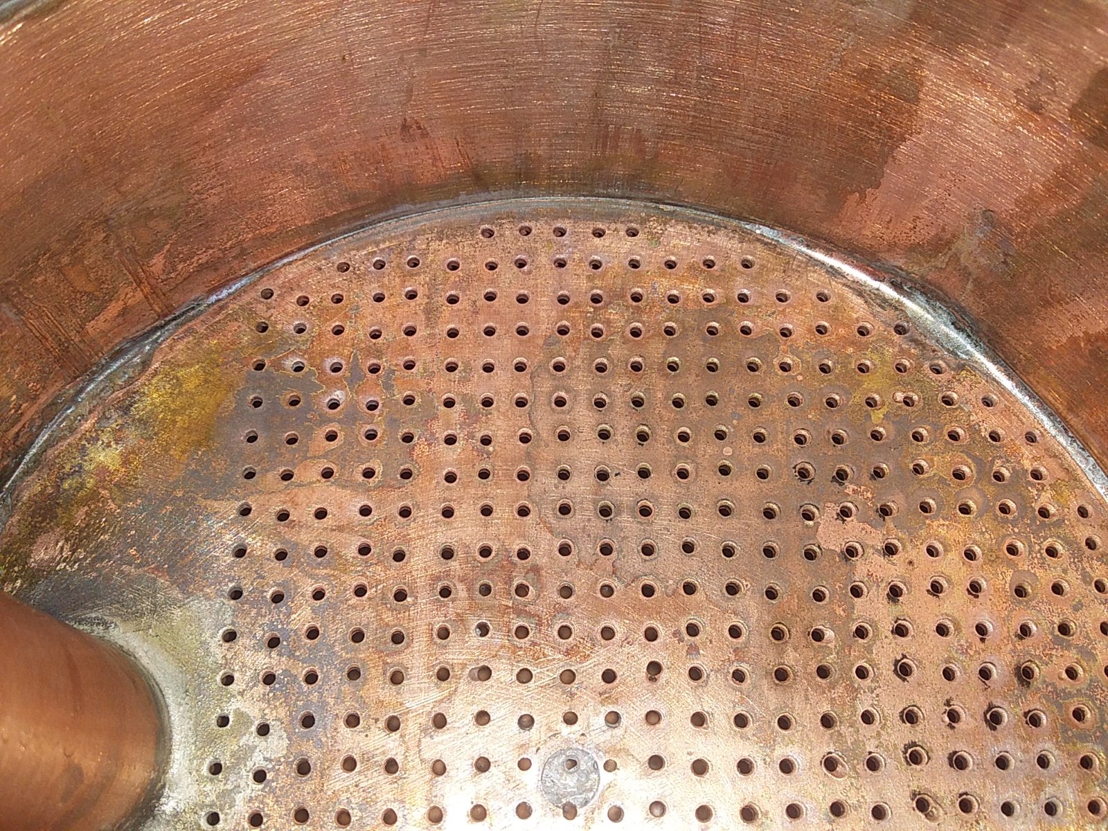

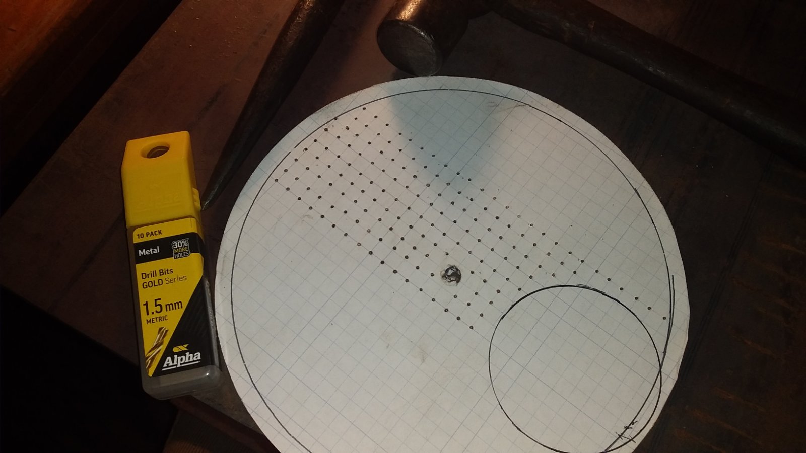

The idea is to build it in modular form, there will be 2 x sections with 2 plates each and 1x section with one plate. this will allow it to be run in any configuration from one to five plates. Mostly it will be used with 4, but I wanted to keep my options open experimenting with other amounts of plates. A few weeks ago I roughed out the plates using a jig saw and then had a mate turn them to size on his lathe. The plates will be made using 1.5mm holes on a 5mm grid.

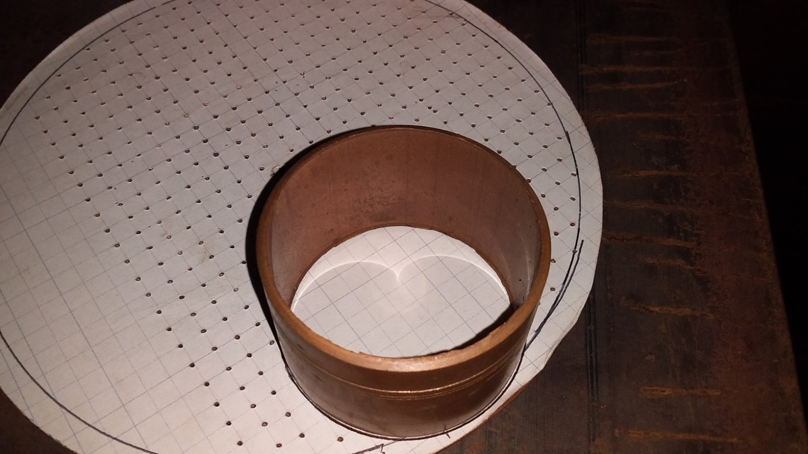

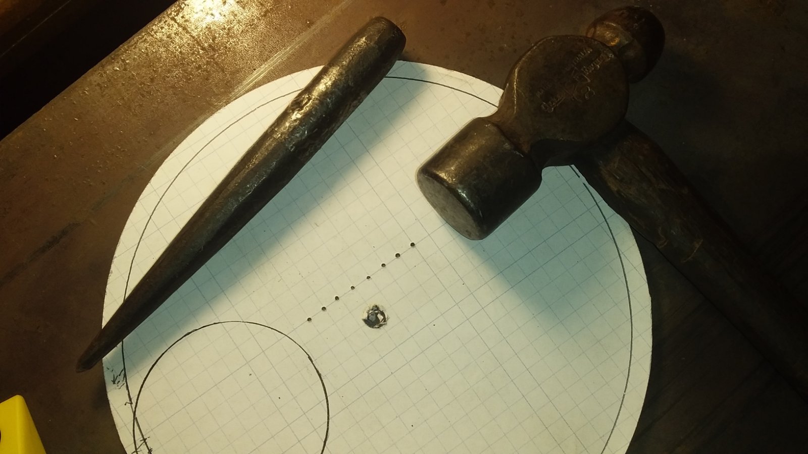

The easy way to get this right is to print out a 5mm grid using a printer , then glue that to the plate using something like Aquadhere wood glue.
you can then center punch and drill the holes. Each plate has approximately 520 holes. A total of approximately 2600 holes to be drilled. Got stuck into that job in my spare time and over the next week finished all 5 plates.

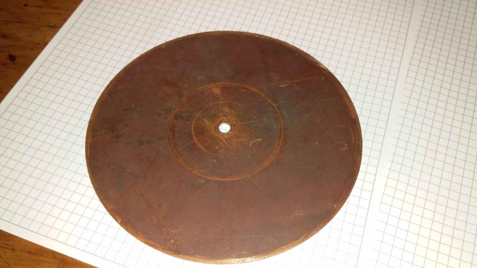

Salty , are you going to get your mate to re-spin the plates ? .... or didn’t they spread much ?
How much better was the Dremel compared to the hand drill you used last time ?
- Posts: 11643
Re: SBBs Column Build
They did spread a bit Yummy , as they do when you punch them. They are only out by a little bit so I will just spin them in a drill and hit the edge of them with a bit of emery paper or wet and dry.
The Dremel seemed a bit under powered but was lighter, easier and quicker to use. After the first thousand or so holes I was getting better at it. Did the forth plate from start to finish , including gluing in 1hour 44min....That also included de burring the holes by running through a second time from the opposite side.

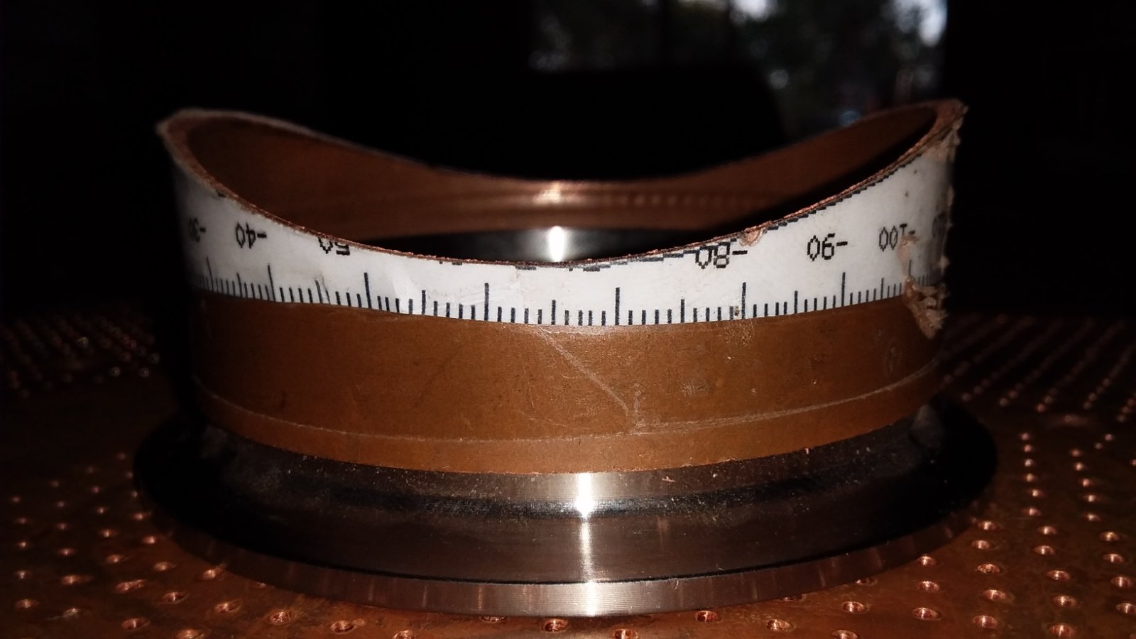

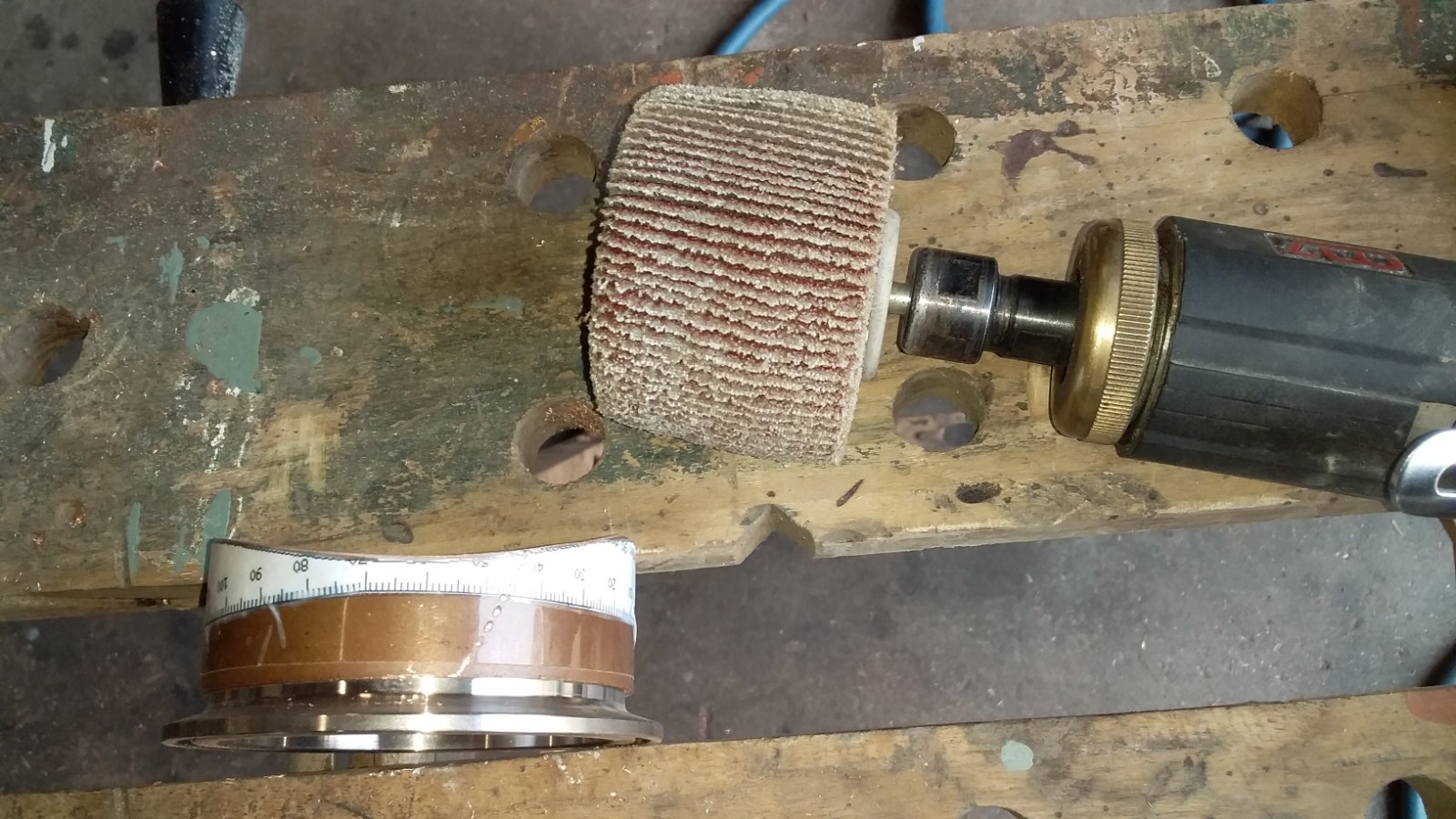

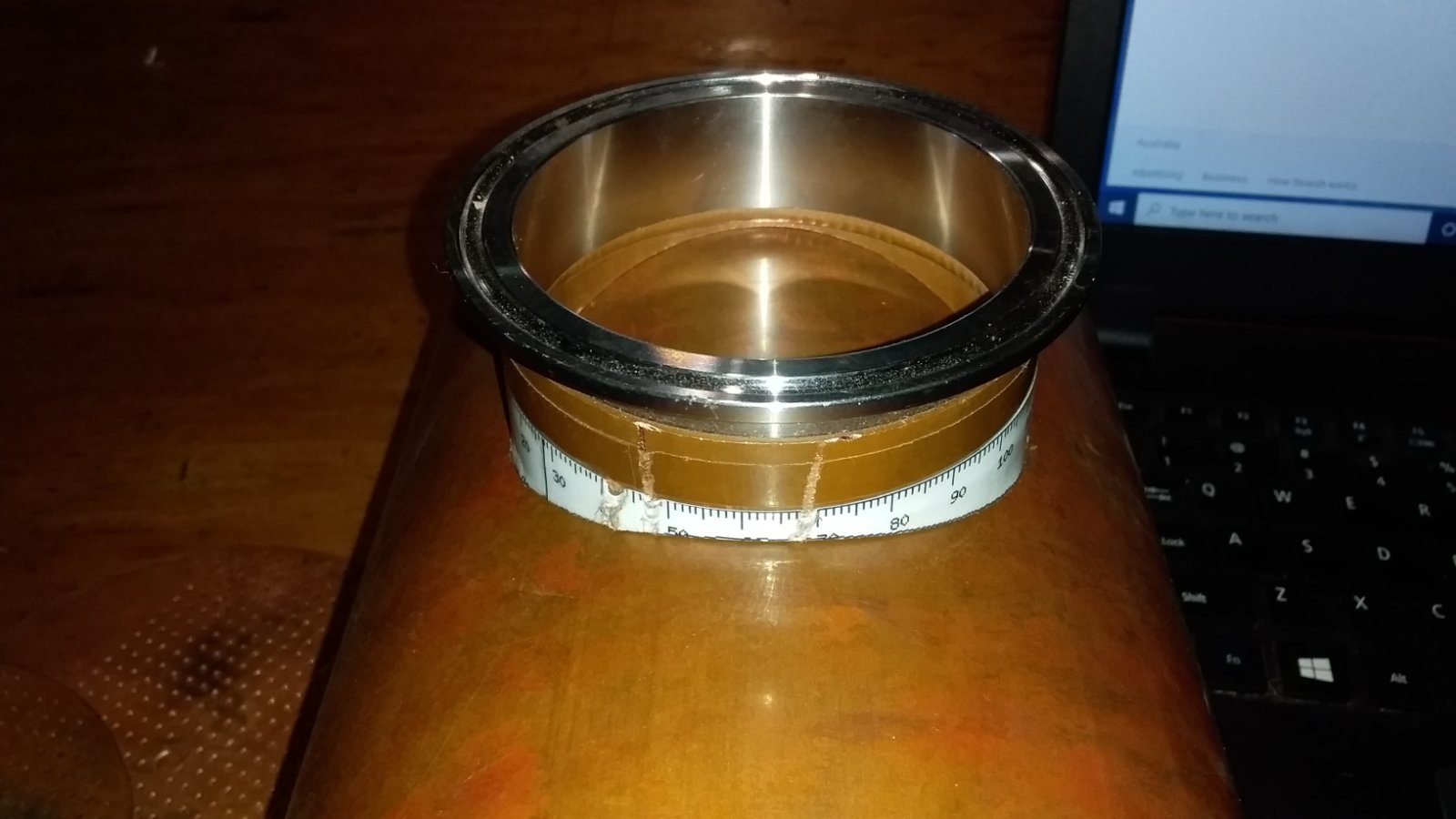

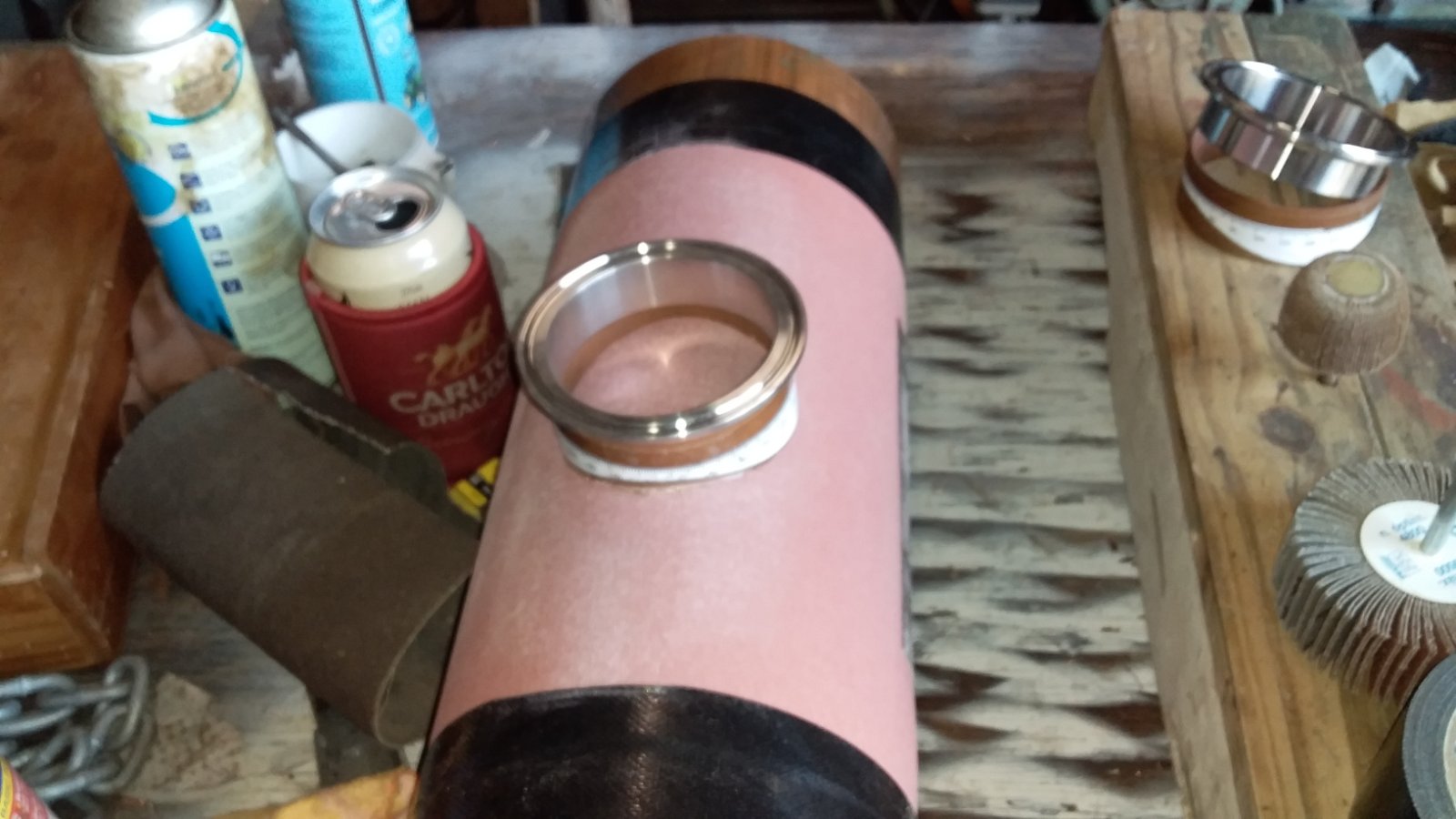

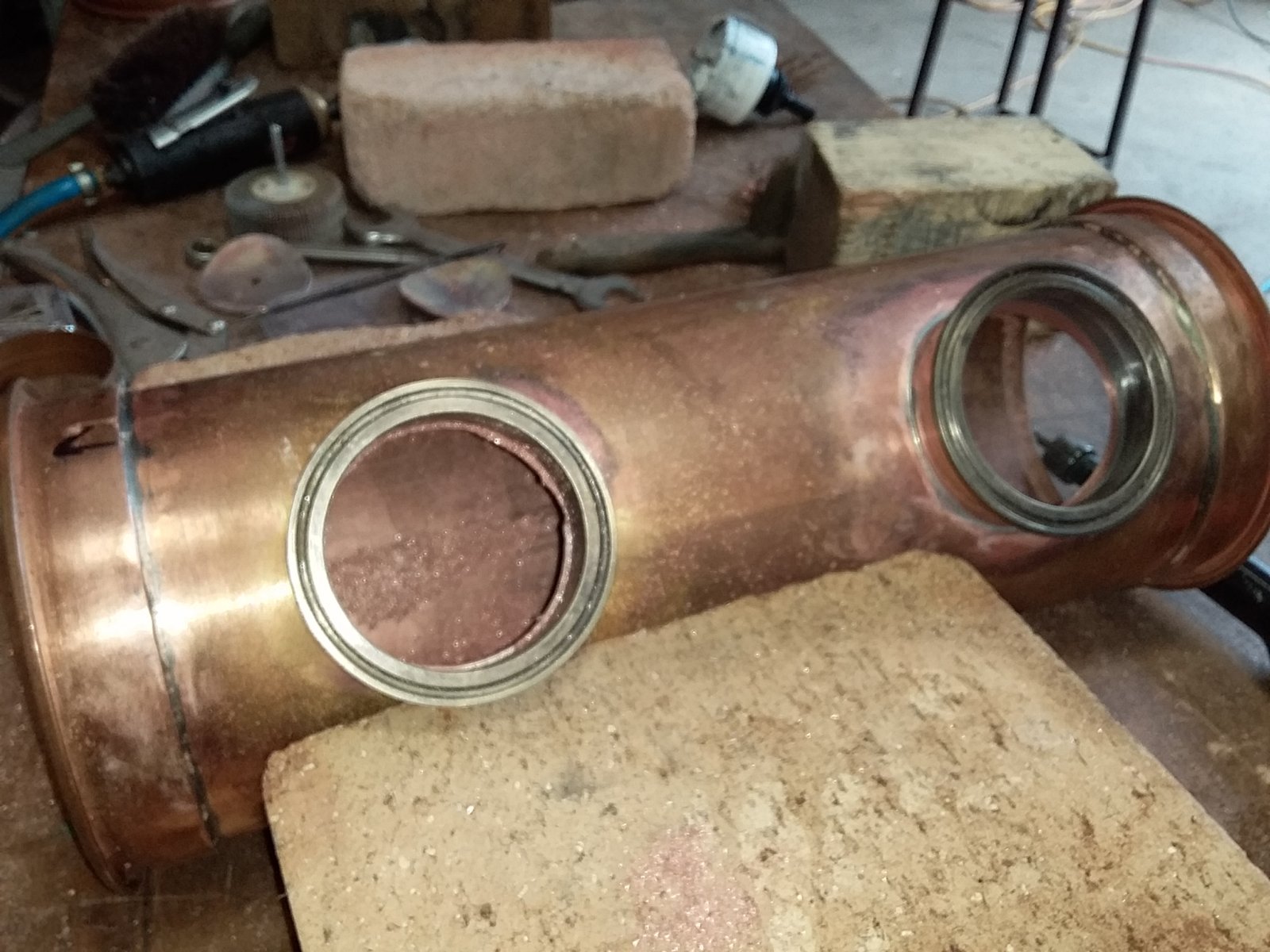

On to making the sight glass mounts, I'll stick to the same method that I used last time for this as it worked well. Sight glasses will be from Still Dragon, The ones on my old still were some of the first sight glasses that they sold, in the 8 years that Ive been using them Ive never had one fail. I would recommend them to anyone thinking of building a plated column. The copper rings used to make the saddles are just what is sold to join pieces of copper pipe in Au. A lot of them are bigger and chunkier....I like this type because they are nice and thin and keep the glass in close to the column.

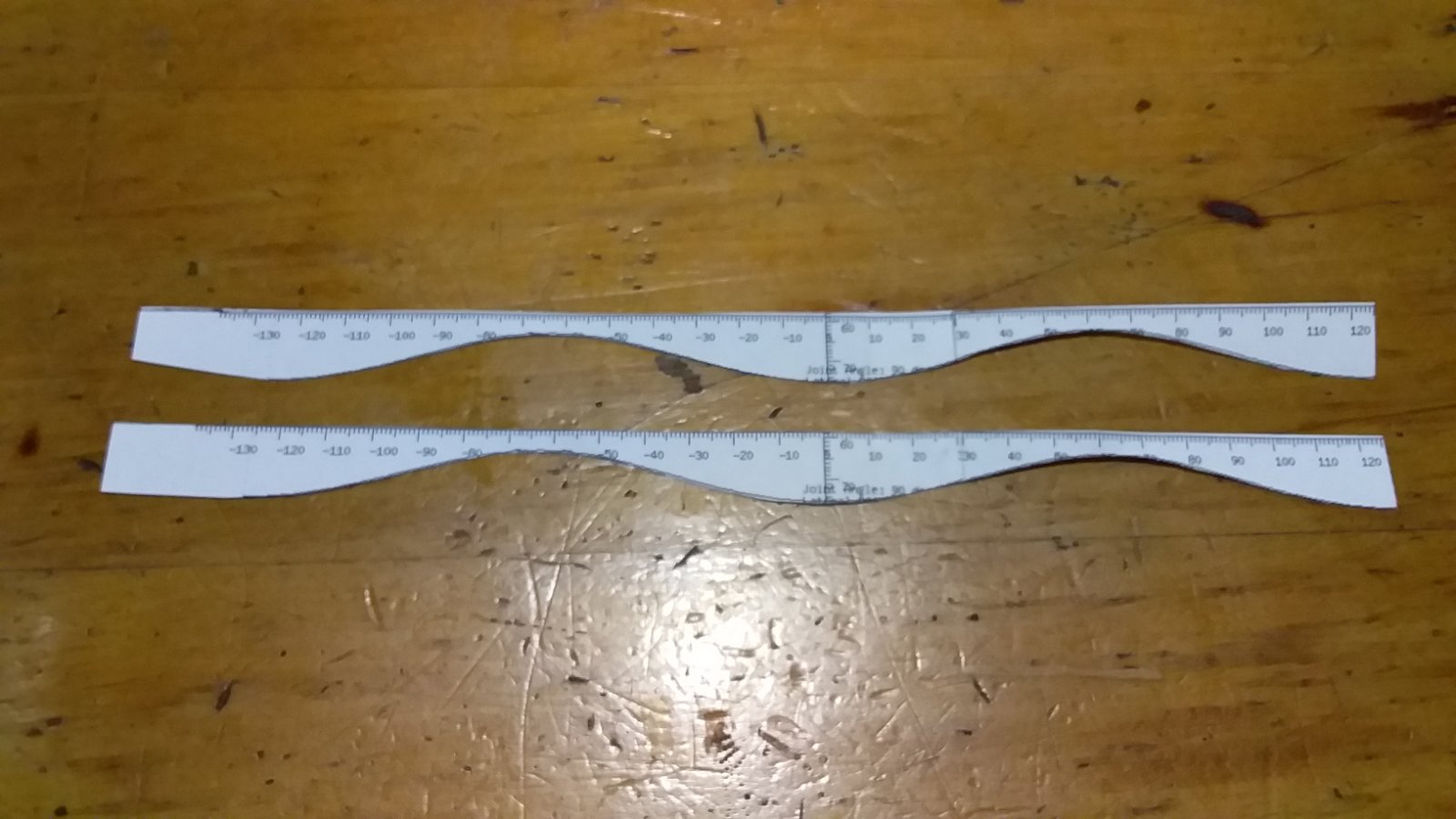

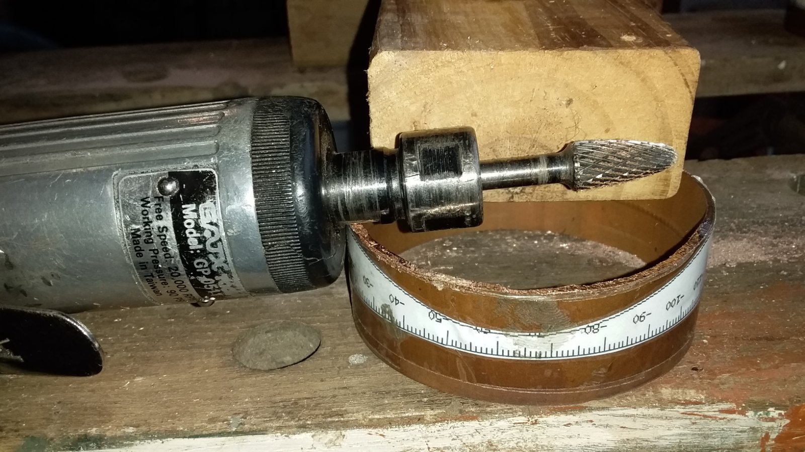

Templates for the saddles were made by using this, its been around a long time and works well. http://www.harderwoods.com/pipetemplate.php
Templates were glued on then a wrap of clear tape put around them for further strengthening.
There are lots of ways of doing these, I used this to rough out the cut away. Then tidied up using one of these. Finished off with emery paper wrapped around the main column for a perfect fit.

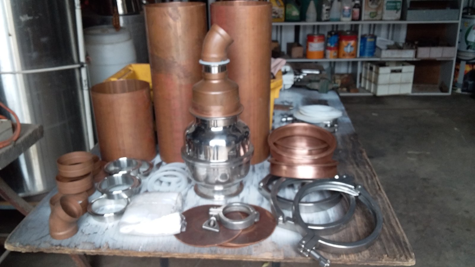

Life has still been busy and Ive had little spare time to work on this thing, Luckily a couple of mates turn up who pitched in and made it happen much quicker than it would have if Id done it alone. Without them helping this would more than likely still be a pile of parts on the work bench. Many hands make light work, Thanks Empty and Scotty
Did manage to get a few more photos as the build progressed so will put a few up now.

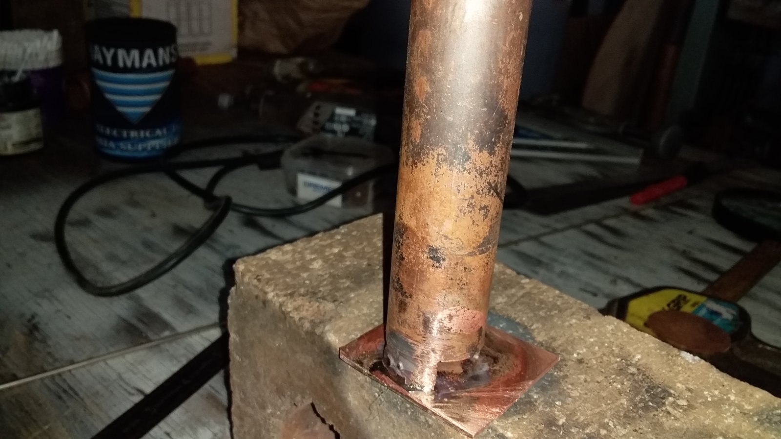

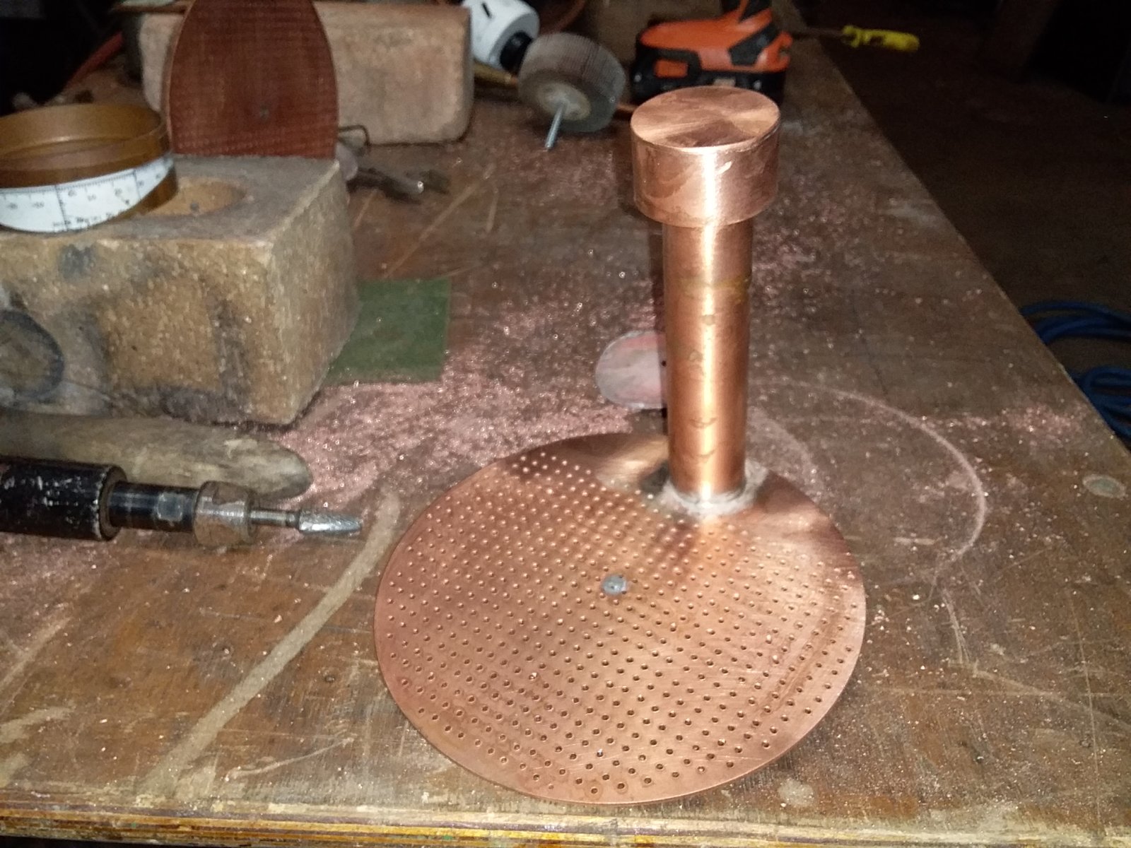

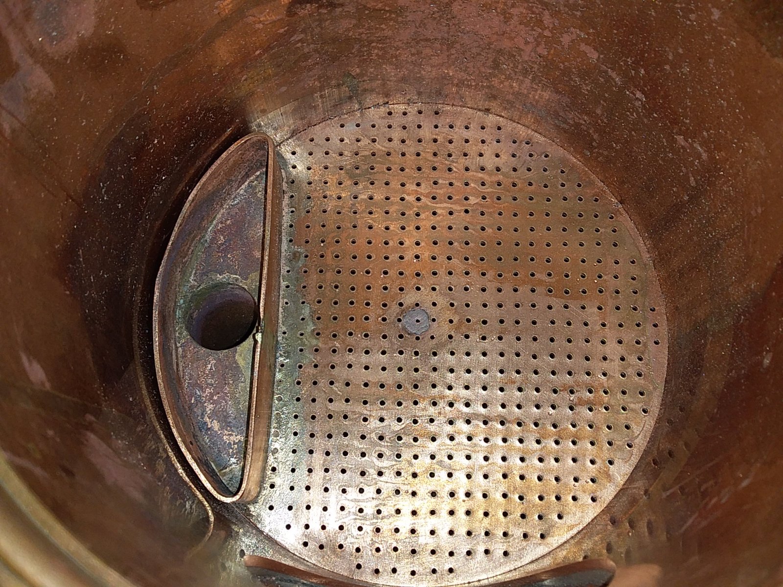

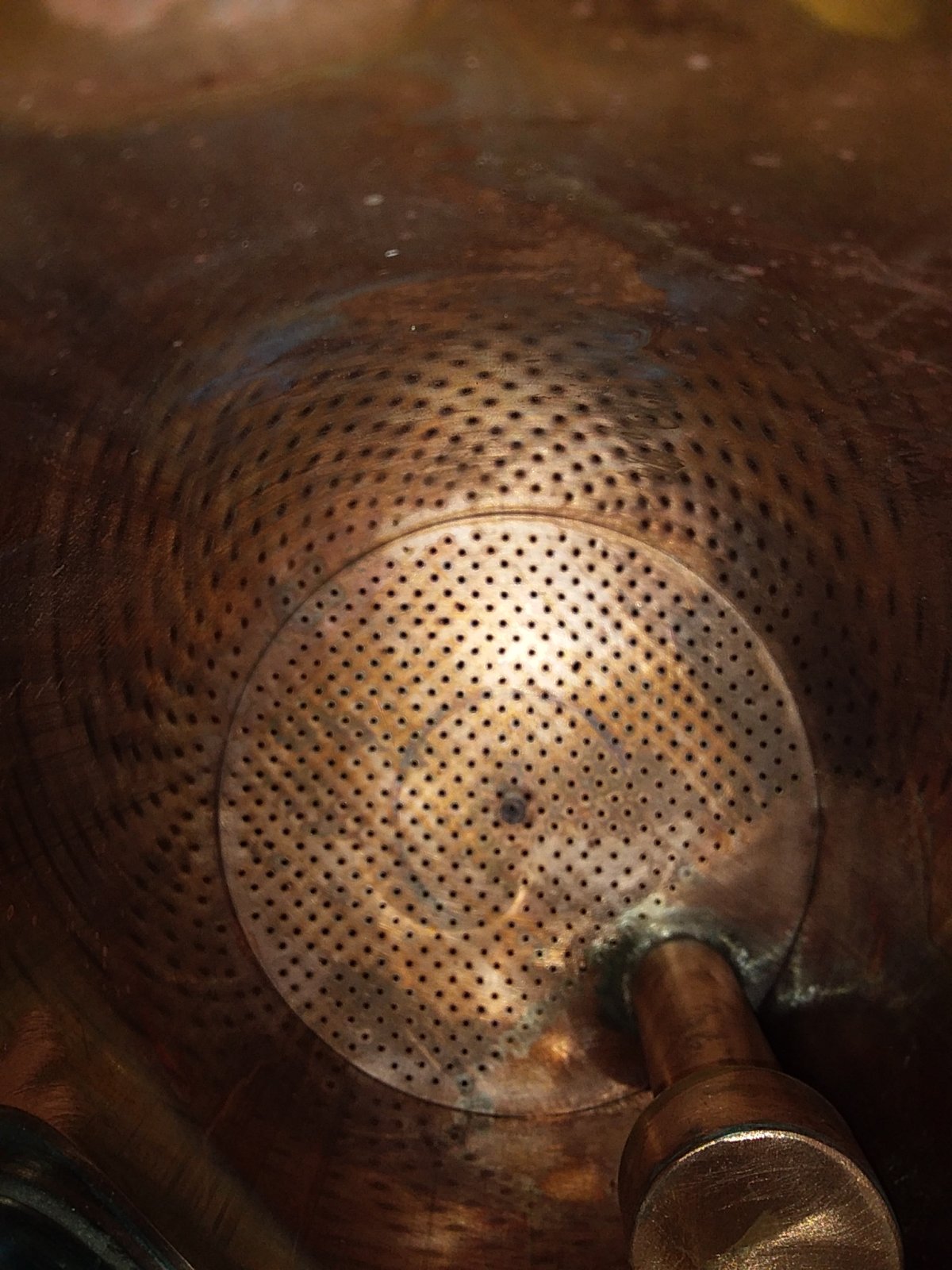

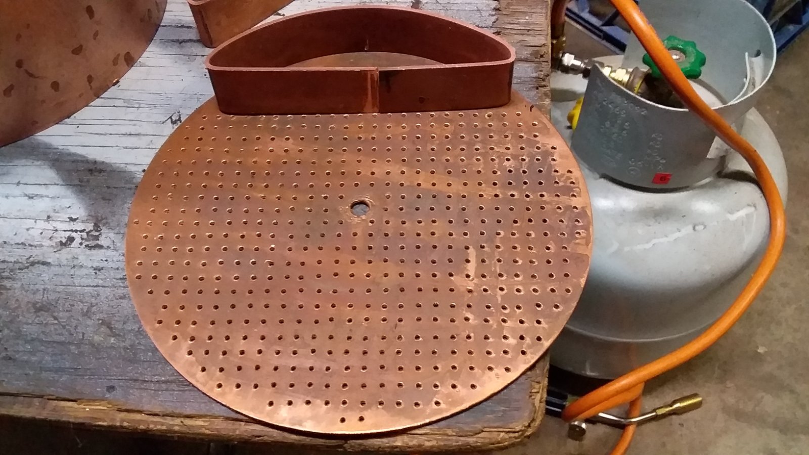

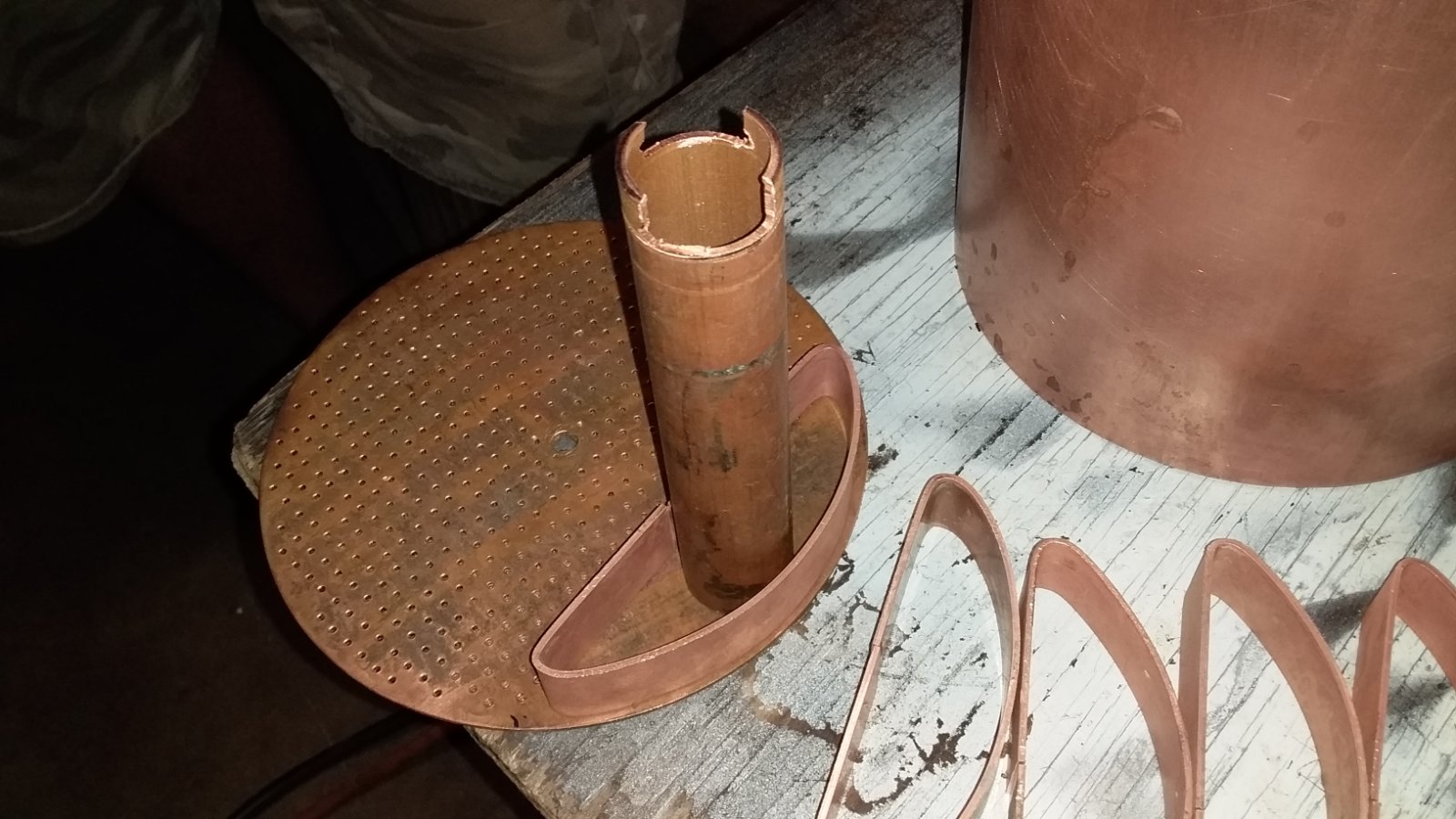

In the time I've been using my old 4 inch column Ive had a few issues with it flooding, this caused me to experiment at times with different downcomer designs. Inefficient downcomers cause flooding and in turn become a bottle neck in plated columns.
Too small of an opening at the mouth of the downcomer is usually the problem imo. For that reason I decided to do something a bit different and make mine a cross between a standard type of downcomer and a weir type. This allows for a larger collection area and lets everything work a lot better. I came up with two different options for this, one was to fabricate a weir like this. The second option was to use a slice of two inch pipe......something like this. Both cover roughly the same surface area of the plate.......I ended up going with option 1 View from the bottom

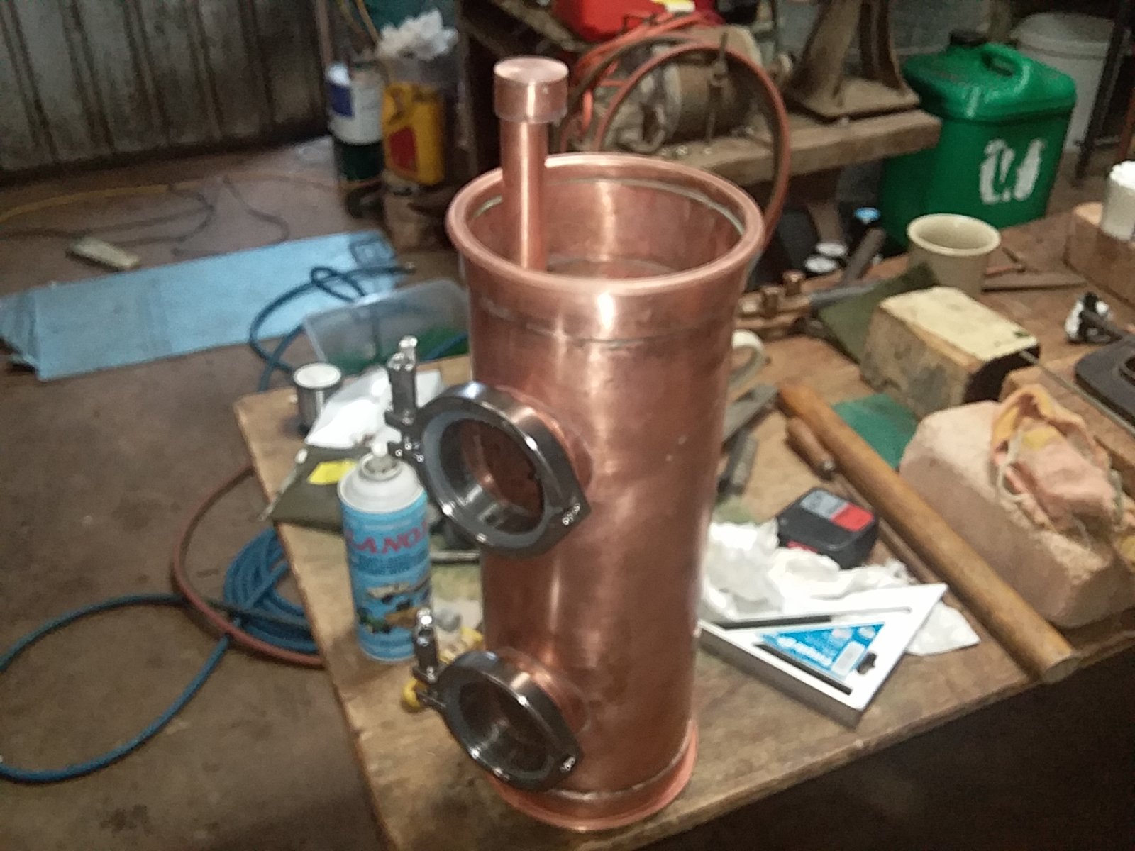

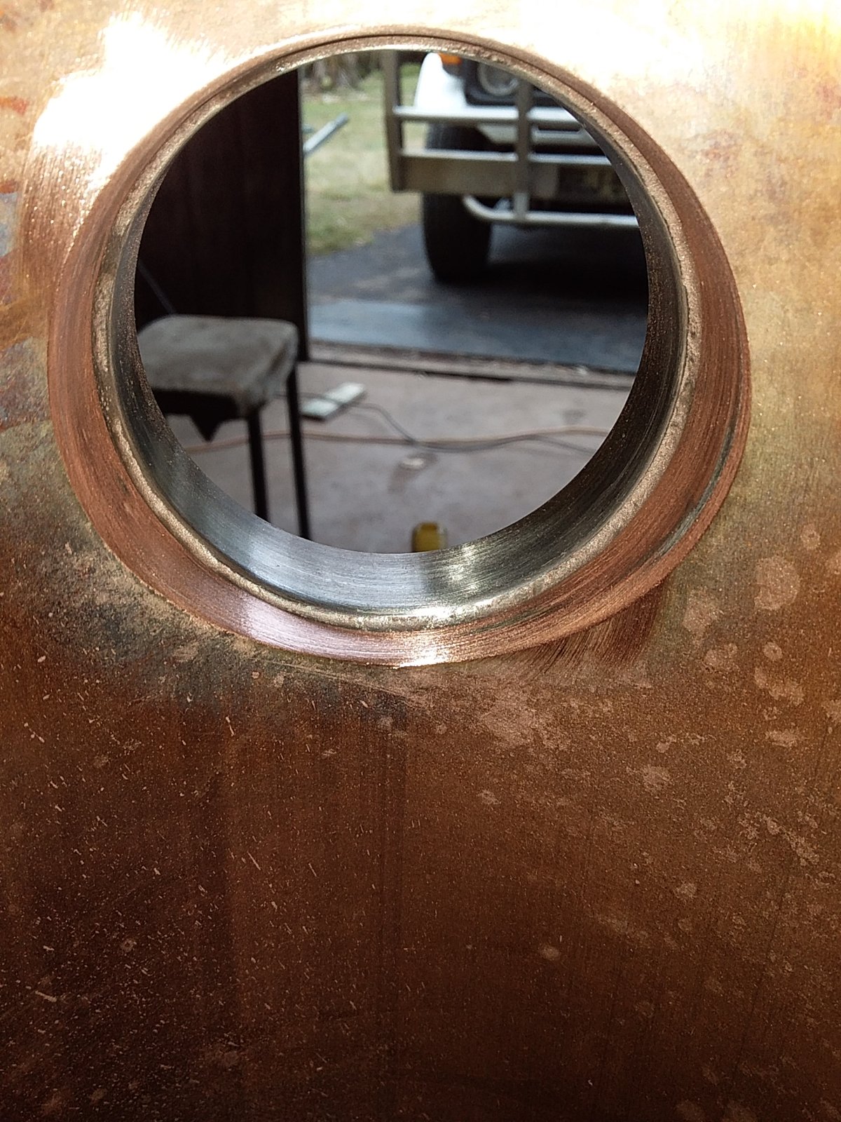

Bit of a mock up and then time to attach some sight glass mounts.
Was going to run 4 inch sight glasses but didn't like the way it looked , cut back to 3 inch and happy that I did.
- Posts: 18609
Nice reviewing all your photo’s, you have a lot of patients SBB.
- Posts: 11643
Outside looking in
Inside looking out

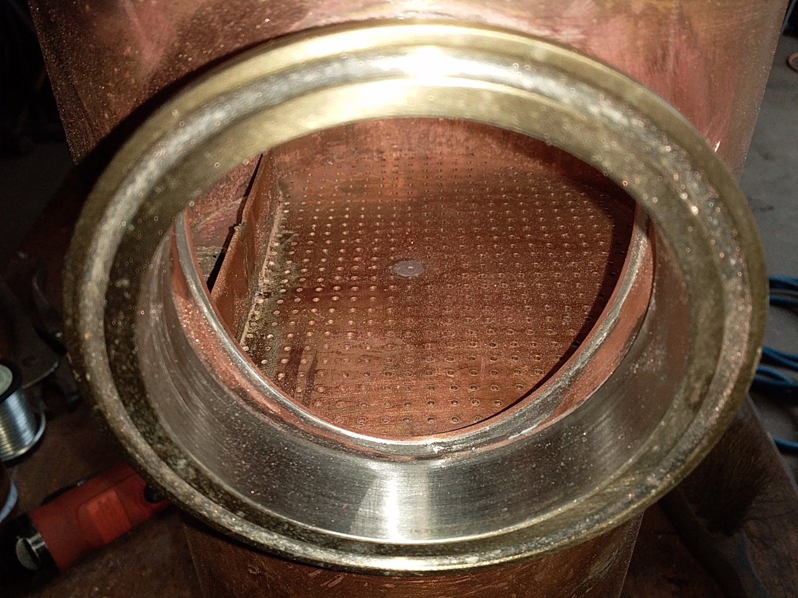

My first build had an old school plate tree, plates in this one are non removable, they are soldered in.

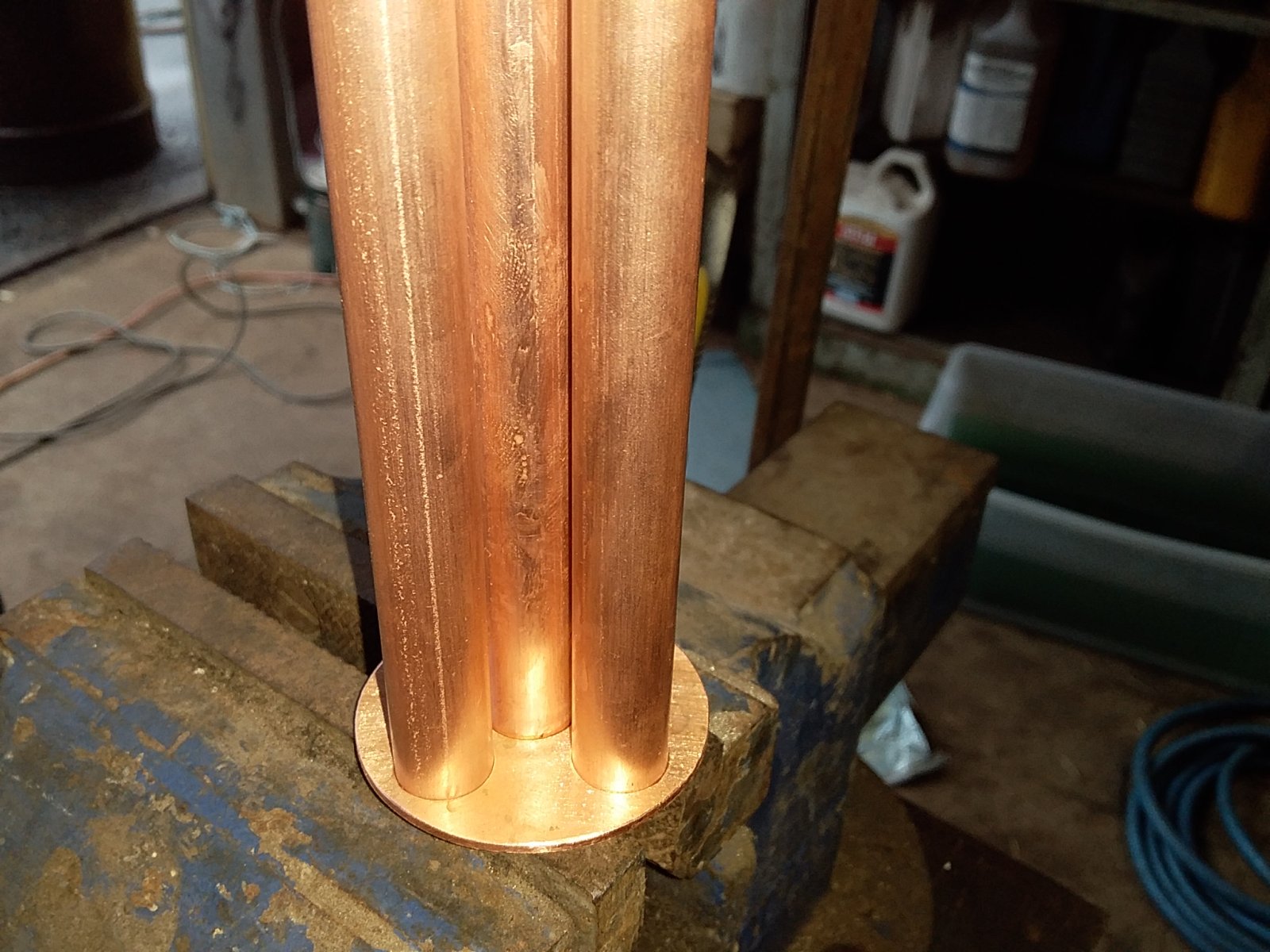

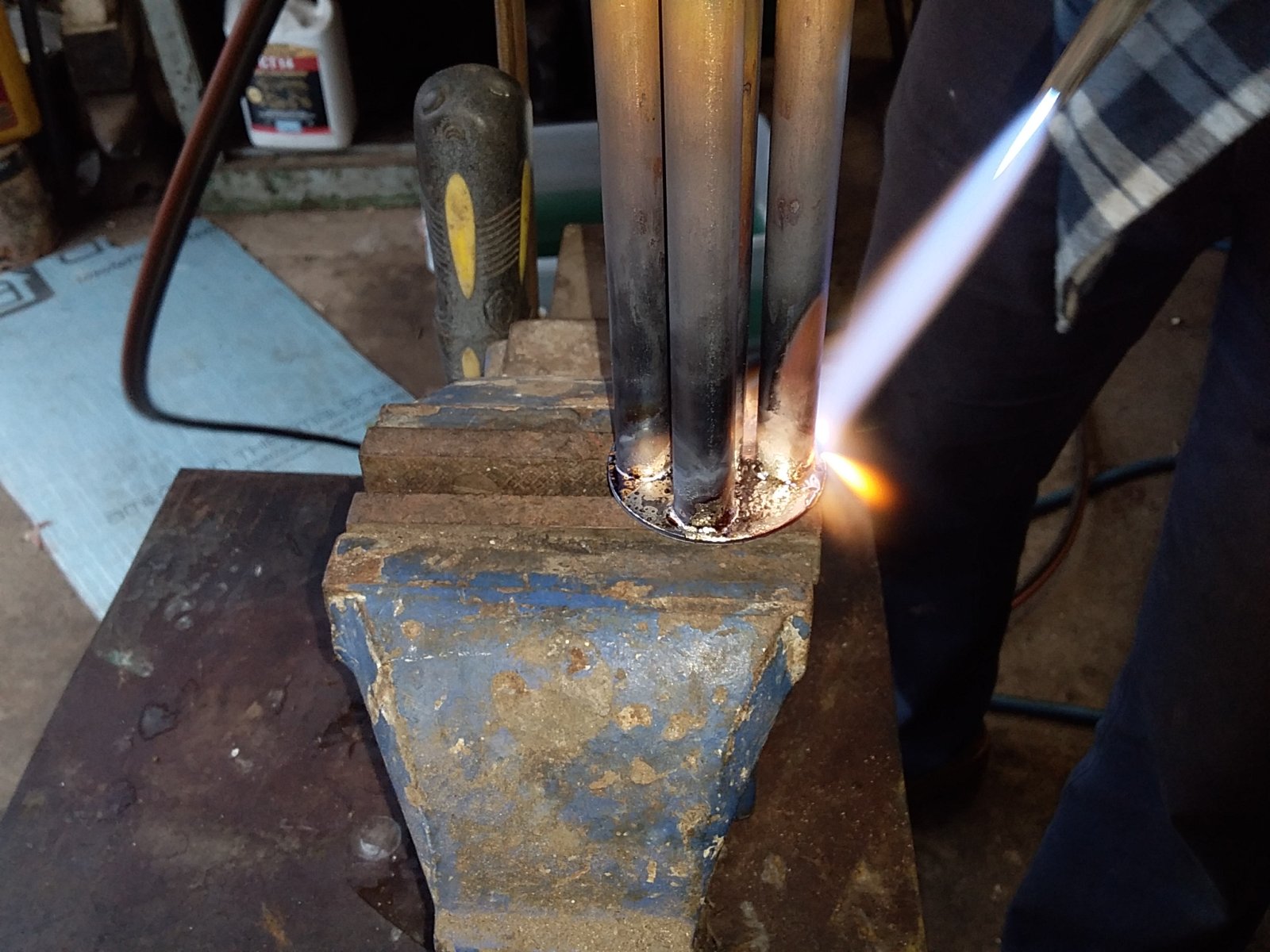

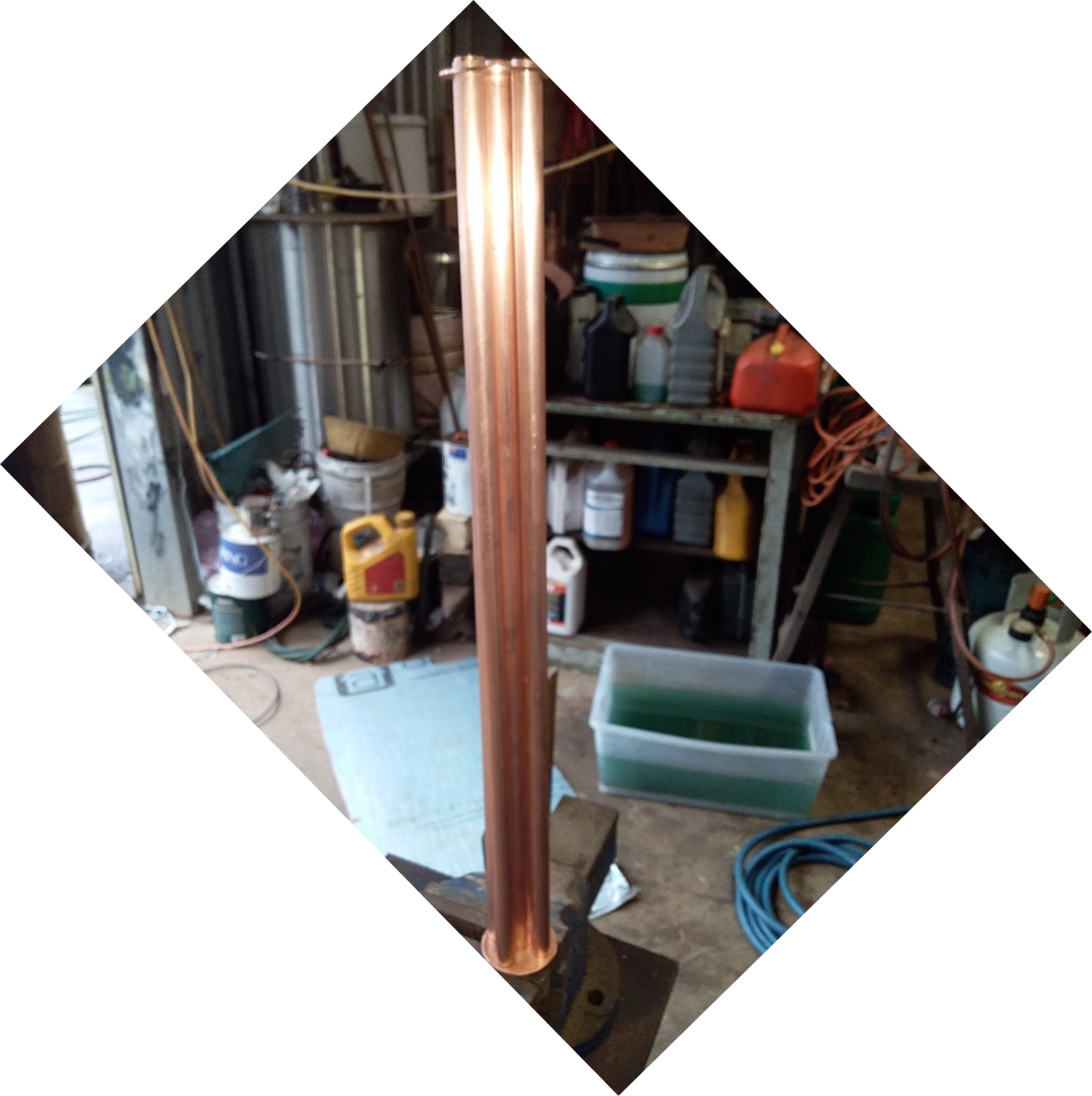

The next part of the job was the product condenser, this was made using 5 x 1/2inch tubes 500mm long inside of a piece of two inch.

I run LPG and a four ring burner under the boiler Tommy, I've never bothered to try to convert power input figures to watts.
I'm glad I made the downcommers on this one the way that I did, I can throw a lot of heat at this one if need be without any sign of plates flooding.
