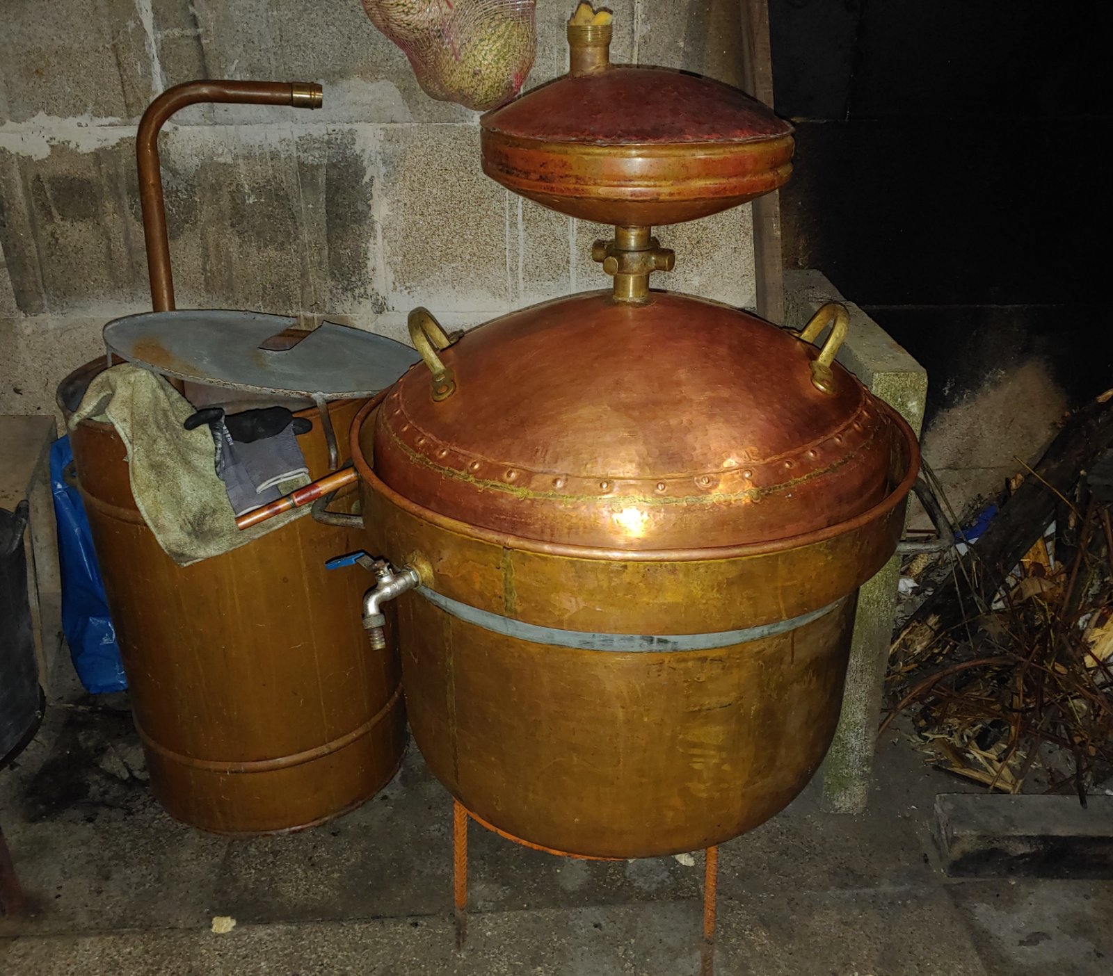

I didn't find a suitable still to buy within my budget, but luckily was loaned an old, 100 liter Alquitar still to use this season. The poor thing is full of holes and I had to fashion a couple of branches to hold the thing up while full of water so it wouldn't collapse on itself. Every distillation is preceded by the application of lots of Rye paste to seal the holes in the still. :lol:

The attached picture is of the Alquitar still that I used this season. Rustic eh? :lol:
