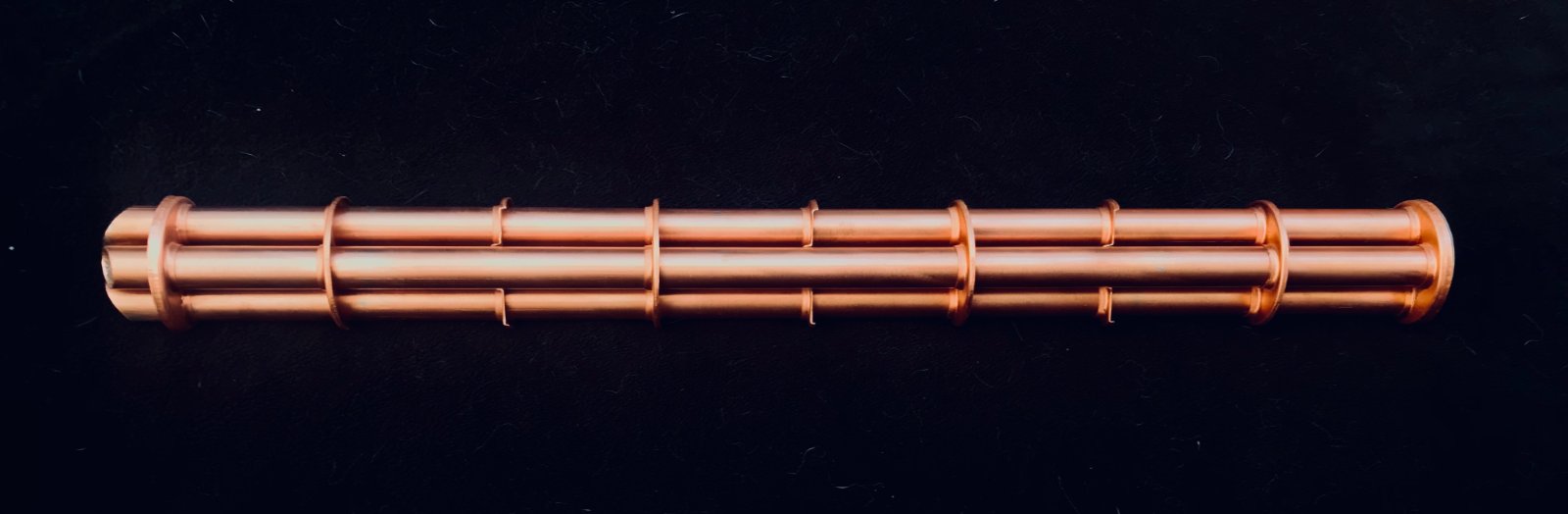

HPS actually slightly misquoted the dimensions of his condenser. The one in the video is 21".PuckJunkie76 wrote: ↑Thu Jan 12, 2023 2:13 pm Yes, I watched it..yes the sound was up...I missed it..was an honest mistake...
This would be correct. I have made a number of different sized condensers for members on request. A 24" shotty looks hella long compared to a 21", but in most cases, I feel the extra 3" is not needed.
Last edited by Twisted Brick on Fri Jan 13, 2023 11:43 am, edited 1 time in total.
- Posts: 3387
- Location: Ontario
Re: 2" shotgun built by our friend Twisted Brick. Unboxing and review.
I support that statement, having experimented with different length and size of tubing..Twisted Brick wrote: ↑Fri Jan 13, 2023 9:51 am but in most cases, I feel the extra 3" is not needed.
I presently use for stripping a shotty that's 7" overall length having 5 - 7/16" tubes, and can easily knockdown 4500w with a little less than a litre per min of water flow..
I'm an advocate of slower stripping speed, which is at 3500w and at that speed, I use less than 1/2 l/m of water flow..
Efficiency of any PC is directly related to the water flow and temp used..
The baffle design and placement are what makes a shotty either efficient or not, along with the water temp used..

God damn, that's some beautiful guts!Twisted Brick wrote: ↑Fri Jan 13, 2023 9:51 amHPS actually slightly misquoted the dimensions of his condenser. The one in the video is 21".PuckJunkie76 wrote: ↑Thu Jan 12, 2023 2:13 pm Yes, I watched it..yes the sound was up...I missed it..was an honest mistake...
I'm quite happy with the 24" I have and I can say without a doubt it'll handle anything I throw at it! Going to be putting it through it's paces with a 9kw element in the next couple weeks and I can't wait!

that head is a beauty! Nice and clean!StillerBoy wrote: ↑Fri Jan 13, 2023 11:43 amI support that statement, having experimented with different length and size of tubing..Twisted Brick wrote: ↑Fri Jan 13, 2023 9:51 am but in most cases, I feel the extra 3" is not needed.
