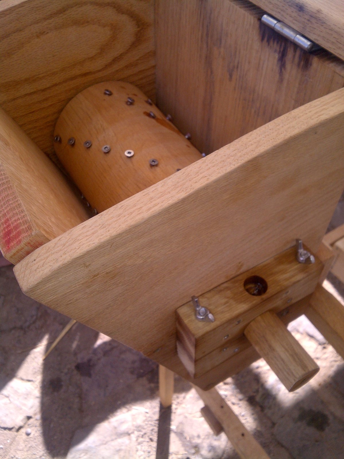

Made a DIY scratter years ago from a block of wood turned round with a axle through the middle and a whole heap of screws sticking out about 1/4".
Couple of pulleys and a motor and voila . The motor is underpowered and the apples need to be pushed in with another block of wood rather than self feeding but it processed about 50L of apple juice this year just fine and cost me practically nothing since I already had the motor and the rest is just wood and screws .

Don't have a photo of mine but it's essentially the same as this one I found on the web . Cheap easy and surprising effective as long as you can get/turn a cylinder. Everything else is basic woodwork
[attachment=0]F7F4WV6I12KKDWG.jpg[/attachment]

Knife_man wrote: Wed Feb 15, 2023 1:22 pm Don't have a photo of mine but it's essentially the same as this one I found on the web . Cheap easy and surprising effective as long as you can get/turn a cylinder. Everything else is basic woodwork
Agreed mate these scratters are super popular because they simply work well.
I turned my own as you mentioned, and it lasted well but the electric one just allows me to focus more attention on the press, which in my case is the much slower process.
