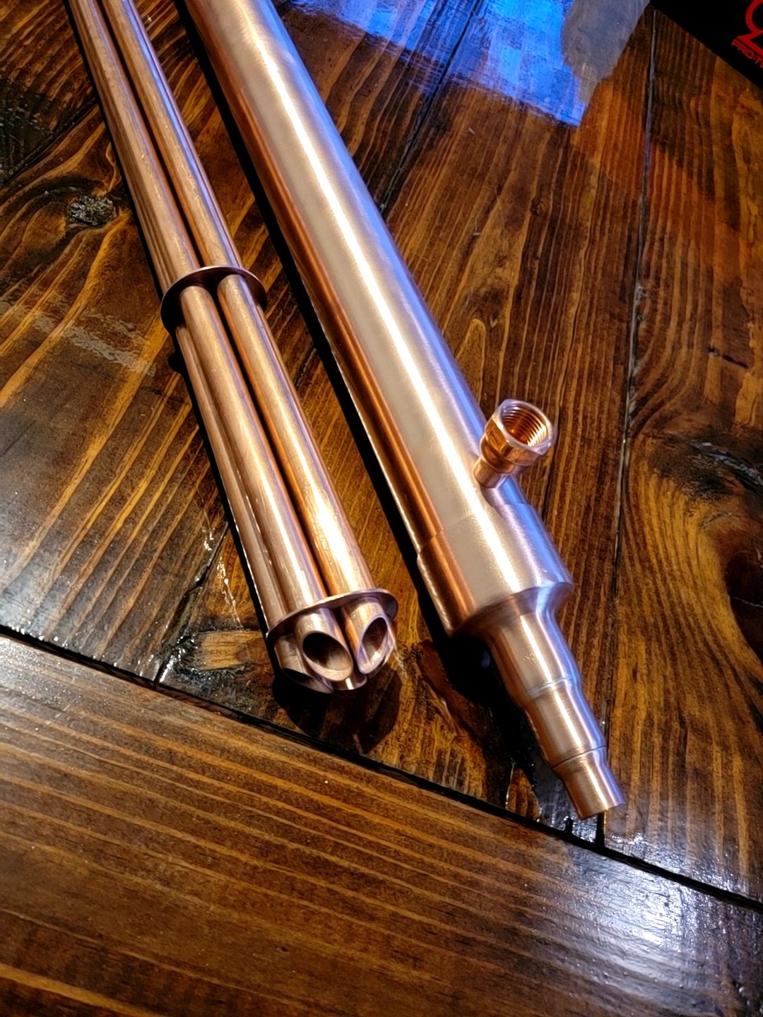

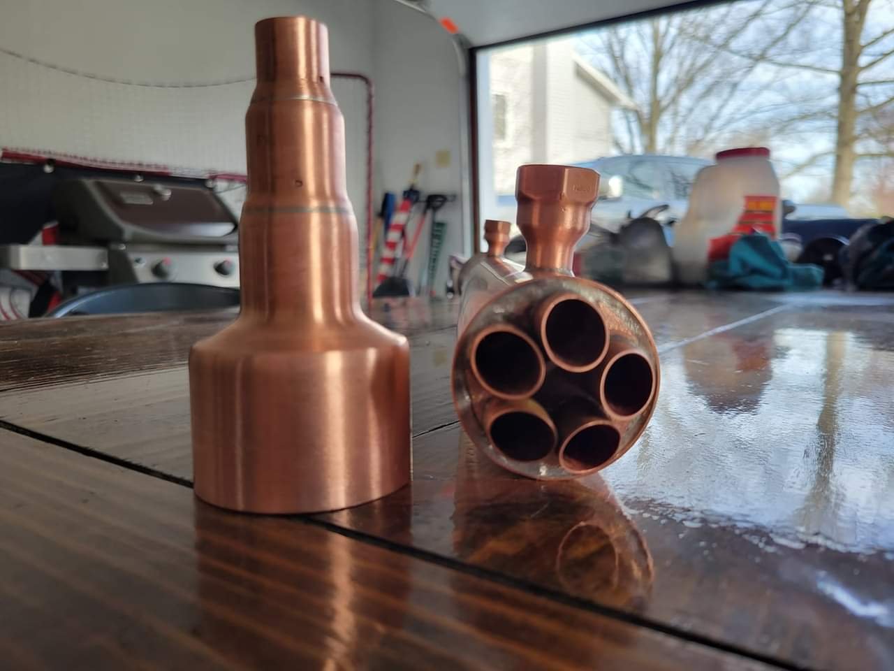

Excellent Advice!! I appreciate it!! I've been thinking about different ways to isolate areas. I also think I'm going to stand it straight up to solder the vapor tubes in order to ensure that are even at the tapered end and don't slide on me.

I found upright for the tubes and I do them in one go, just may need to re flux between tubes

Had the baffle plates been solder in place before placing them in the tube, the end don't move during soldering..

Nothing has been soldered yet..still have to cut the baffles into sections... Was just checking fit and seeing if I liked that angle for the taper

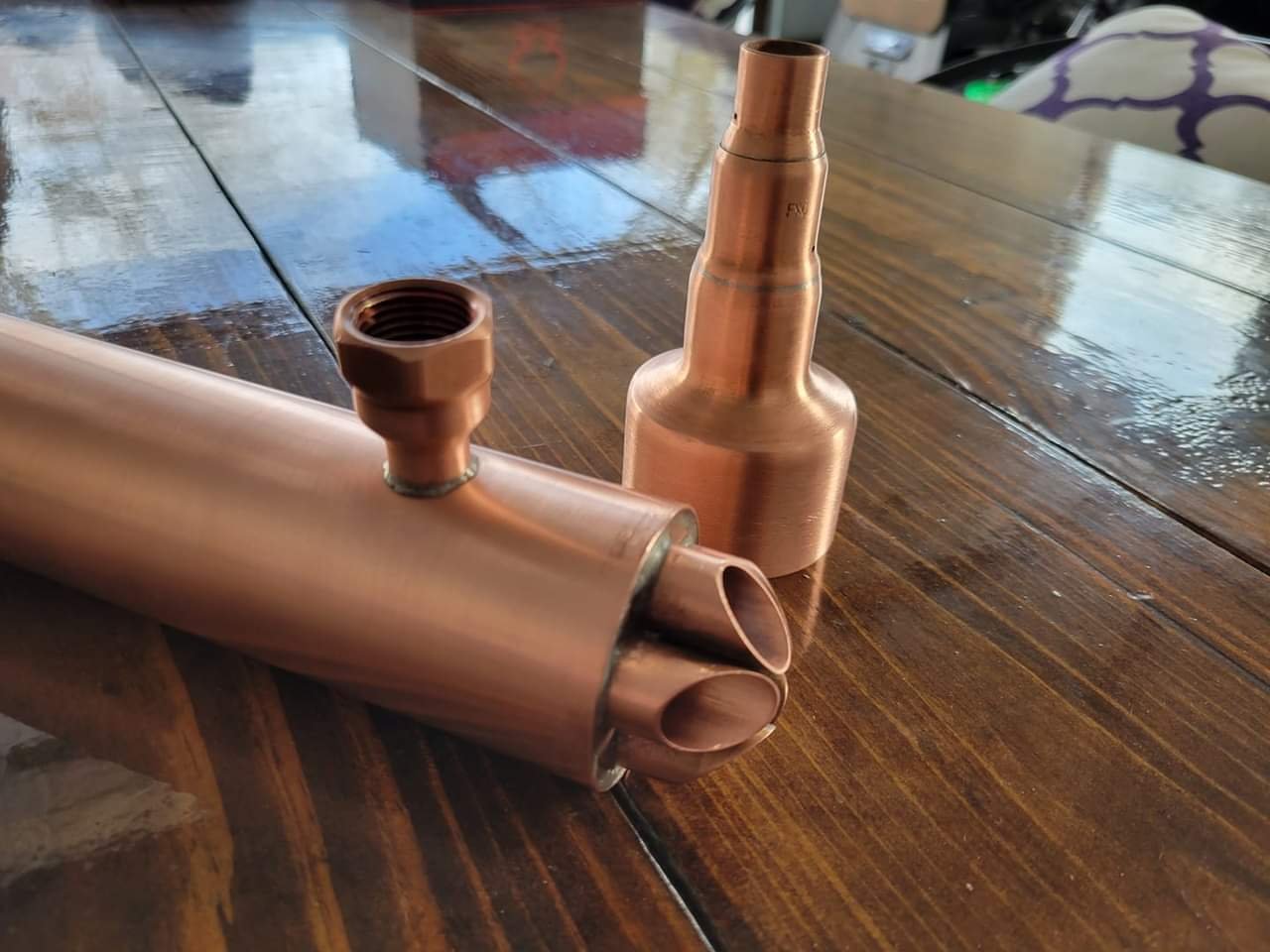

Ughhh.. finally got some time to do some more work on the shotgun. Cut the final baffle, ground them all to fit, and soldered up the vapor stack. I was a little concerned about the tight spacing and getting solder all the way around but it worked out and appears pretty solid (and not too ugly!!).
Tomorrow the plan is to solder the hose fittings, solder the vapor stack inside the water jacket, and if time permits solder the shim and ferrule. That will be the tricky part, I believe.
Really excited how this is turning out...fingers crossed it passes pressure testing.
Stay tuned!!

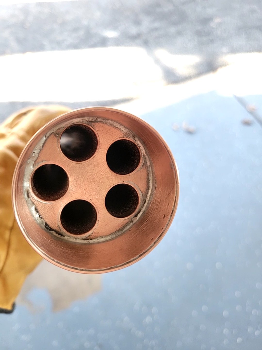

I got the vapor stack soldered inside the water jacket. I initially tried putting frozen pieces of a rag in the holes to keep their solder from melting, but it ended up not being necessary. So I had my son hold the torch and I spun the whole unit it got hot enough. I watched the solder from the vapor tubes closely and as soon as it started to turn from dull to bright I would back solder the cap joint and control the temp by adjust the distance of the water jacket to the flame so the tubes wouldn't get to hot. I also soldered pretty heavy because those joints won't be visible and more importantly, I wanted to be certain that I don't have any leaks. I ran out of solder so I still have to do the SS Ferrule and the hose connections, but I don't anticipate any issues. I'm getting really excited to see this thing finished and all shined up!!
Till next time!!

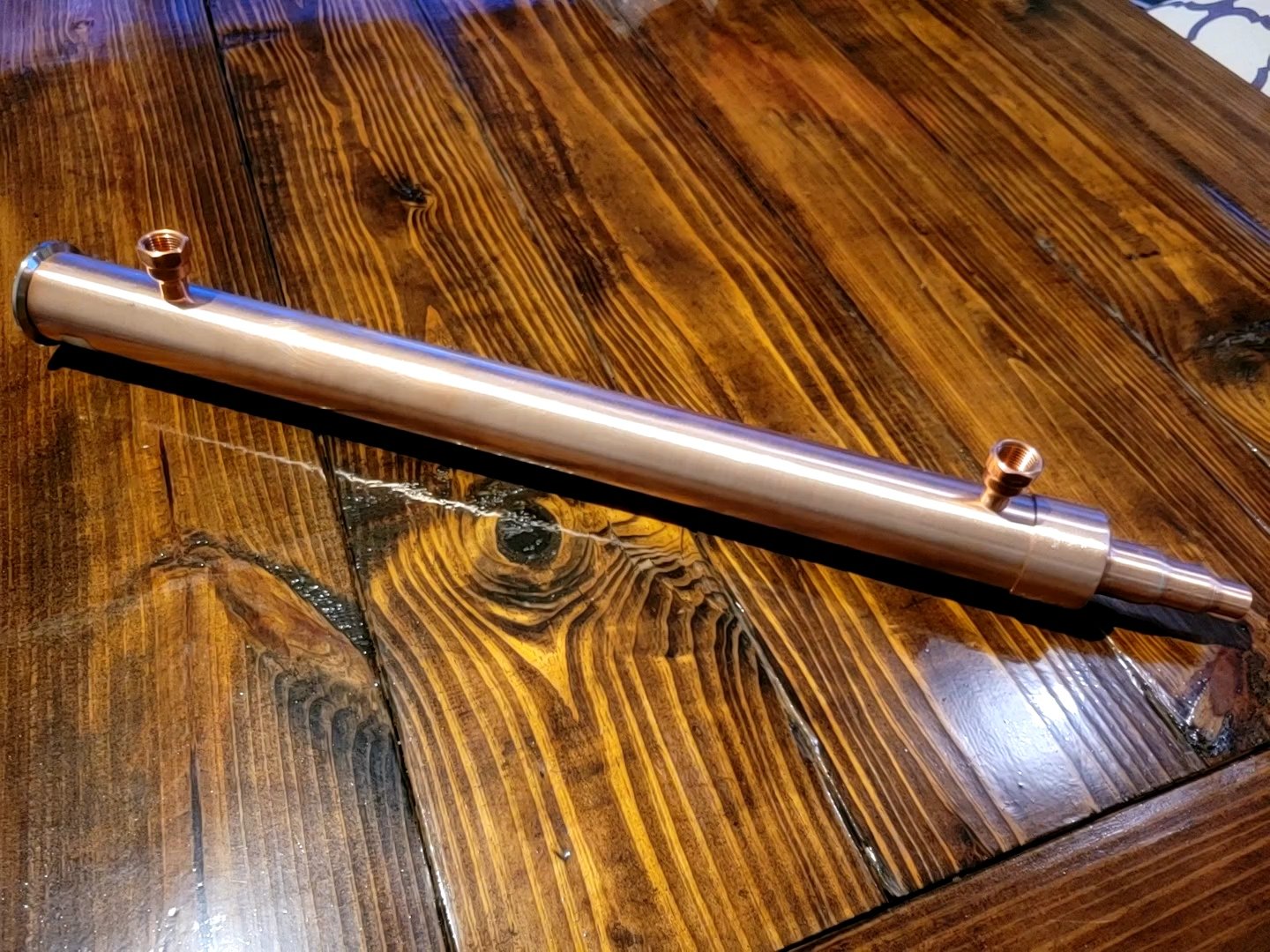

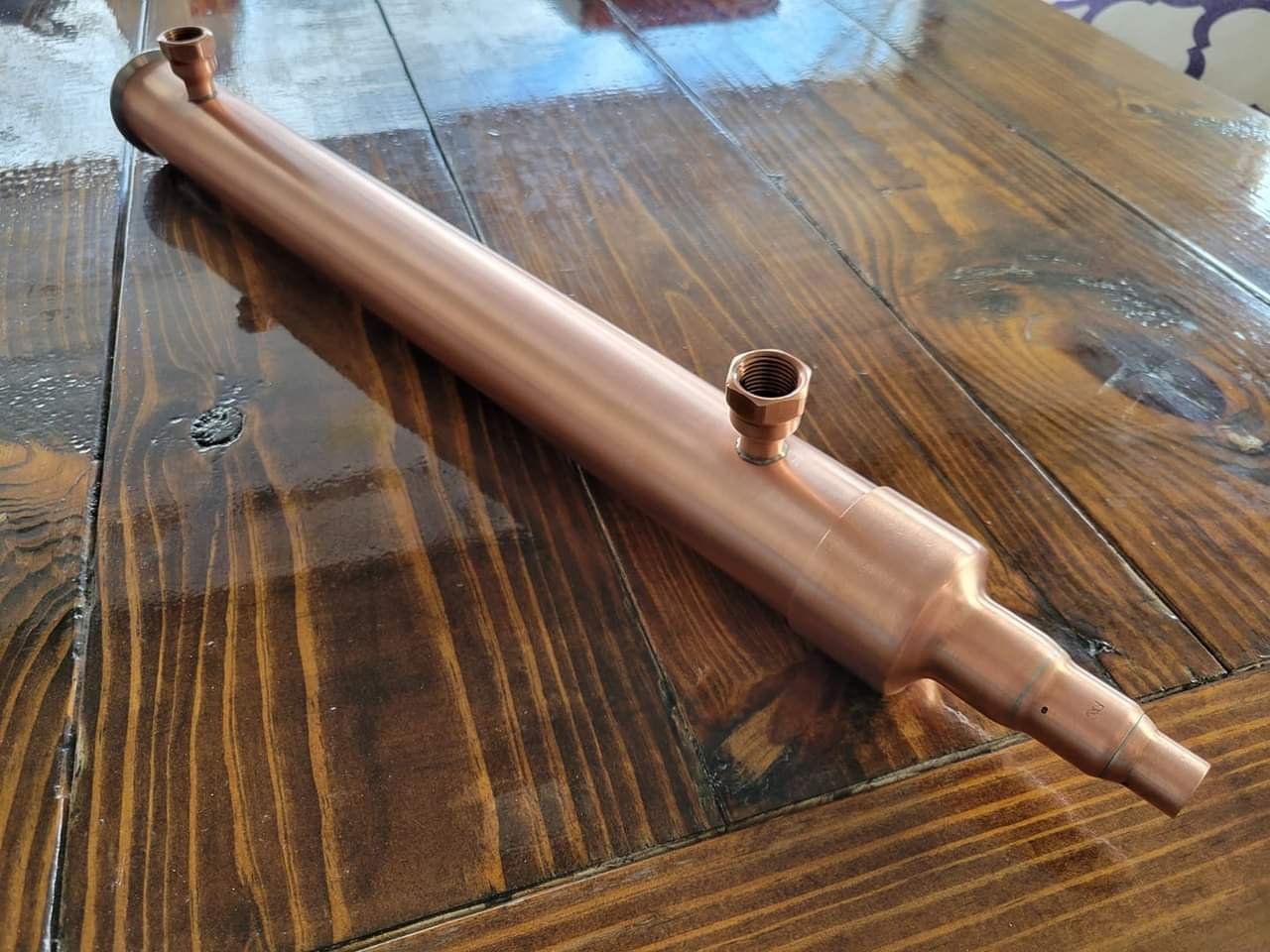

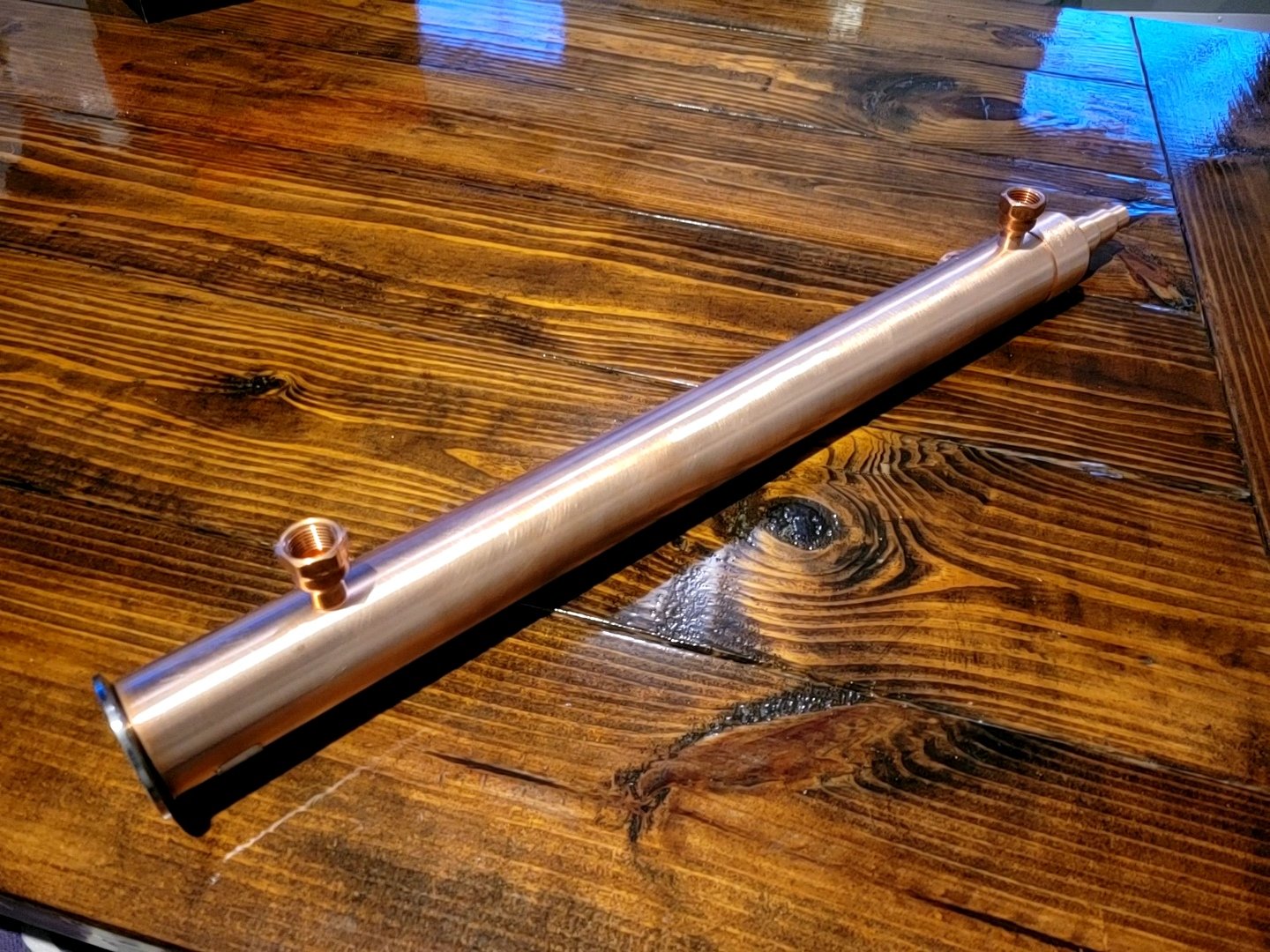

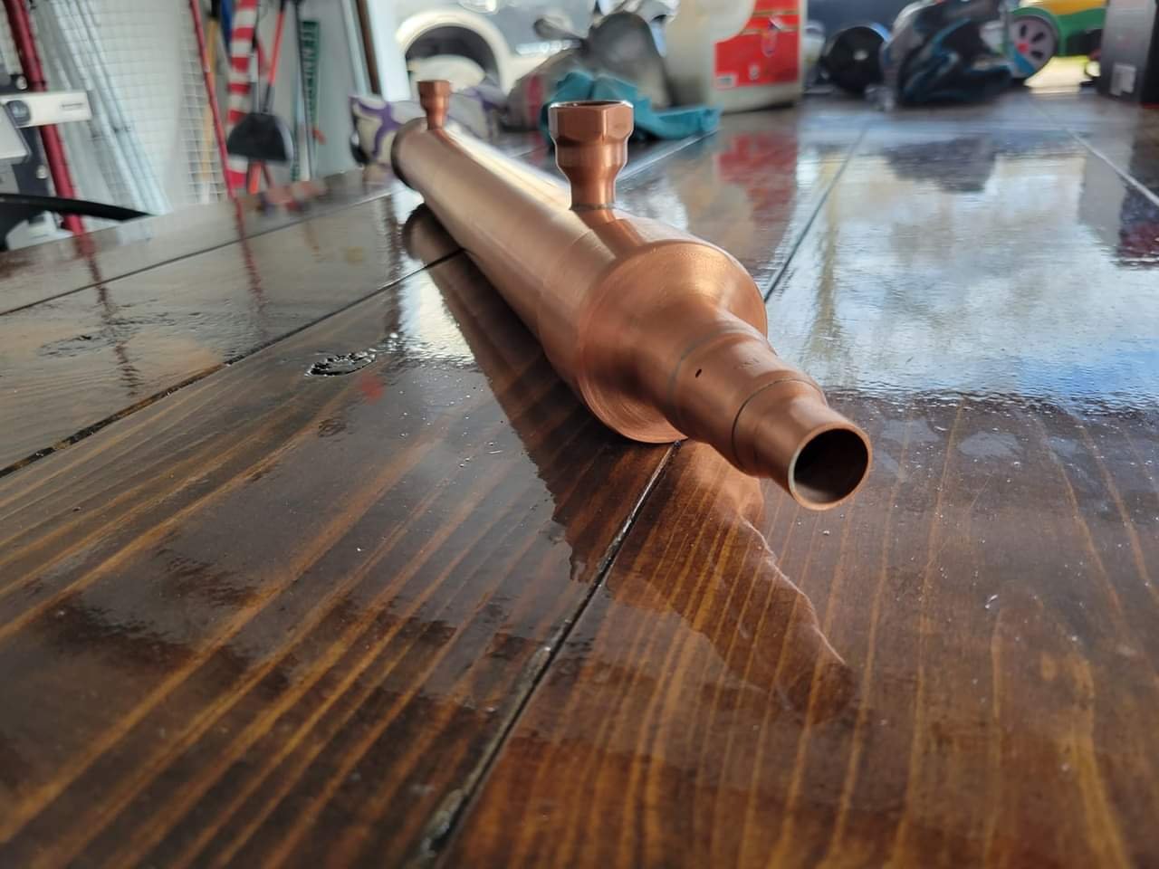

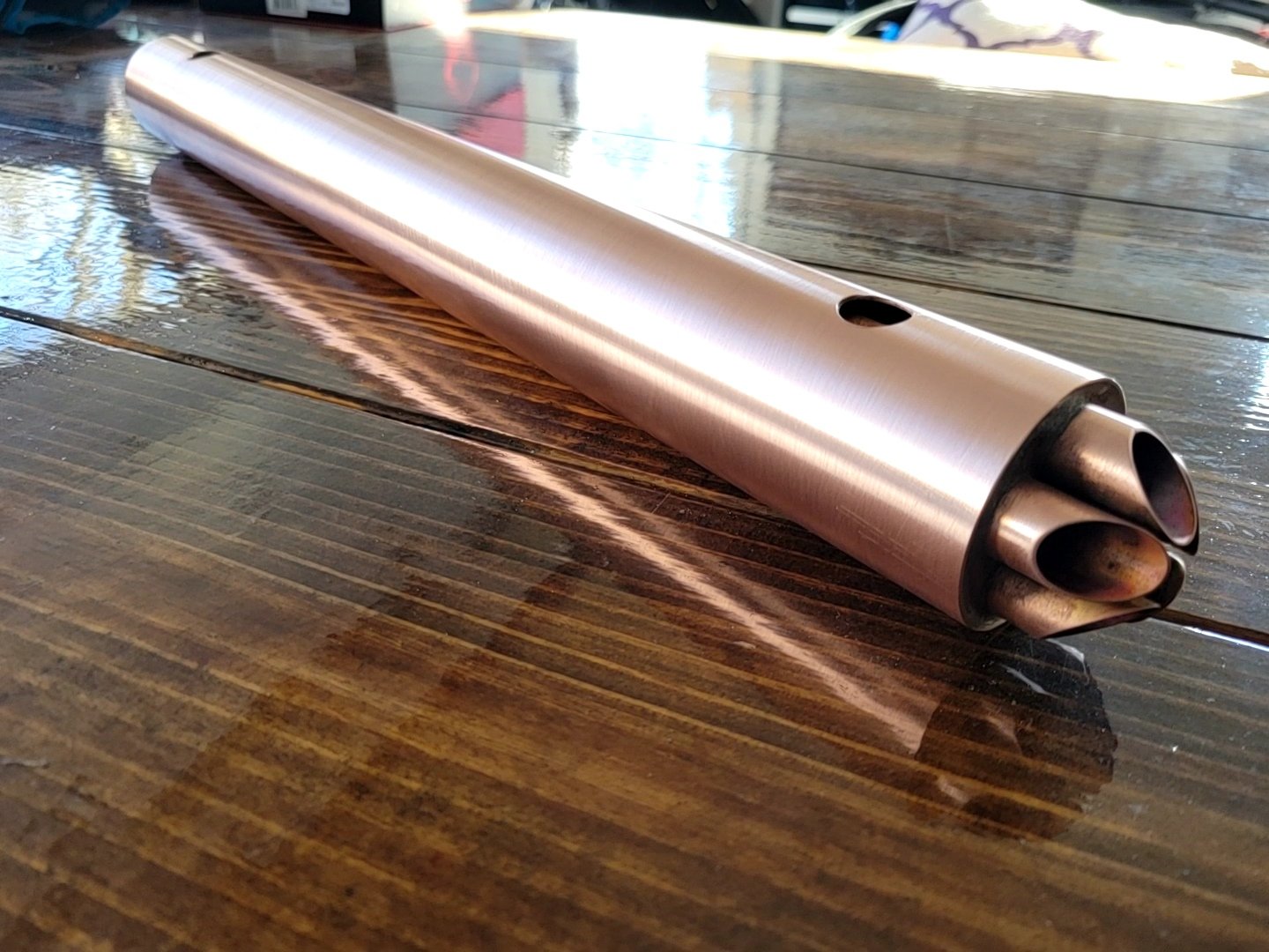

She is Finished!!!! Super Pleased with how it turned out! Thank you to all of you who offered support and advice. Now to get on with the rest of the still build!! Stay Tuned!!!
