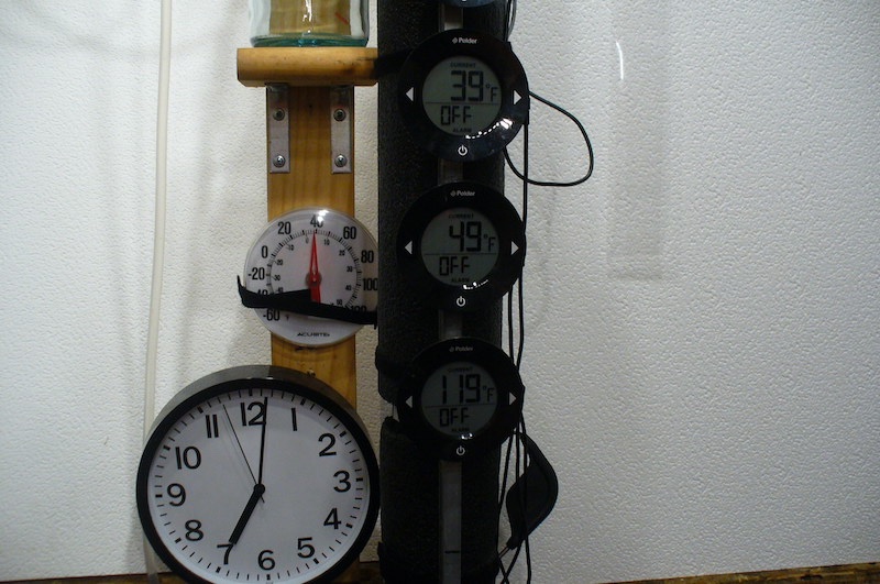

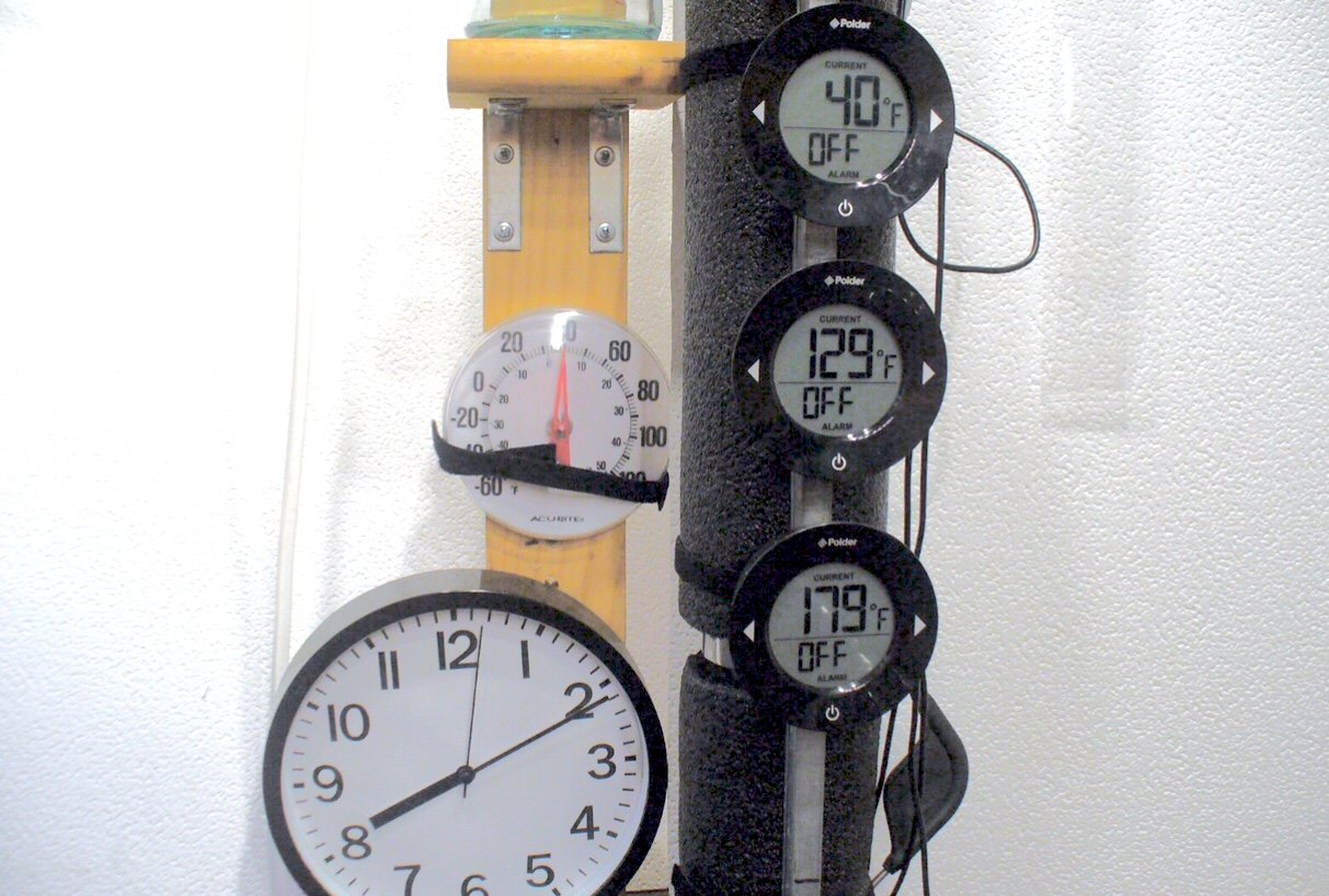

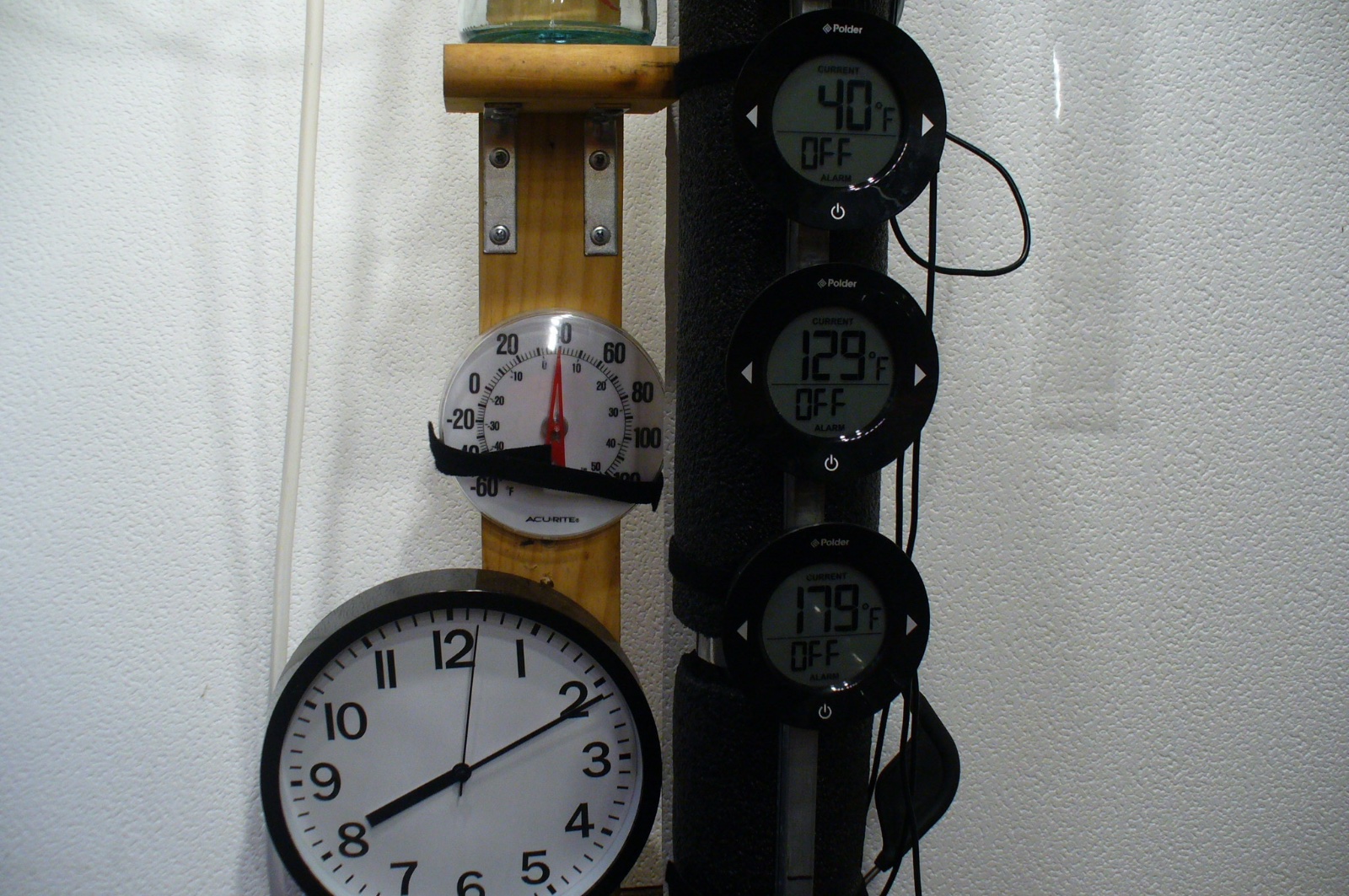

LM temperature photo essay
LM spirit run 28l x 40%. 1003w, spp 2" x 56" column
fores and heads collected at 200ml/hr.
Sunday morning start:
The lowest thermometer (#5) is in the boiler liquid charge
The next one up (#4) is about 6" up from the boiler directly in the spp
The top one in this pic(#3) is about 30" up from the boiler

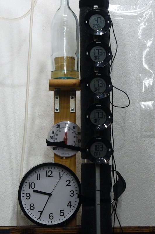

Re: LM temperature photo essay
Thermometer #1 on top is at the RC top end
Thermometer #2 is in the vapor above the spp
#3, #4, #5 are same as first pics.

Day#2
Another cold start
40, 41, 42, 80, 120
Totally un-eventful day collected about 7l at 560ml/hr, 97%ABV Day #3
Another cold start slightly better than yesterday
41, 42, 43, 82, 126
Collected another 2l to put in next run. Stopped when #3 thermometer moved up from 173 to 175*f
#4 and #5 were at 205 and 208 respectively.
Total collection was 1.5l fores and heads, 7.5l hearts 97%, and 2l also at 97% for the next run.
Another cold start
40, 41, 42, 80, 120
41, 42, 43, 82, 126

I'm sure some would be 211* and some would be212* and another 213* but the only thing that really matters is the change during the run, not really the specific number. I have to decide what, if anything to due when a change occurs. And then there's always the barometer to throw a curve every once in a while into your numbers.shadylane wrote: ↑Wed Dec 21, 2022 10:43 am I appreciate you taking the time to share.
And got a couple questions.
Have you tested the thermos calibration?These Polder Scan Rite oven thermometers are not DIY calibrateable. They are however extremely close to one another in readings possibly due to the consistent length of the probe's cables and/or close factory initial calibration.
Maybe dip all of the probes at the same time into boiling water.
Or better an easier yet. Do a water run and see if all of them show 212*f

Hey Bunny,
Those are some sweet thermometers! Not sure how accurate they are but they look cool as hell. As long as I can see .1 degree resolution that’s all I care about. When I first looked at the pics I thought they were sight glasses. Where would I be able to find those? I have a little screw on thermo port with a seal inside that allows the probe to go directly into the vapor, but it requires me to use a specific diameter probe. Do you know what the diameter is?
BrewinBrian44
- Posts: 729
After taking another look, it seems they only show whole number increments.
- bunny
- Posts: 412
- Joined: Fri Jun 26, 2020 8:28 am
Personally, I do not believe the 0.1* delineation is necessary unless your only using the temp in the vapor for your guidance. Lower inside the column the temp changes that are coming are in the form of a "wave" you can feel with your hand, so 1 degree that's moving in the direction of your take-off is way ahead of the temp change in the vapor above your packing, so you know a lot sooner and don't need 0.1*BrewinBrian44 wrote: ↑Wed Dec 21, 2022 12:08 pm Hey Bunny,
The diameter is consistent with Polder's replacement probes: 2.2mm on the short skinny tip and 4mm on the main shaft. They do not shut off by themselves except every once in a while. They take 2 AAA batts.

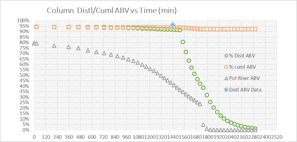

Bunny,
Thanks for posting your good, complete reflux column run data. I do not see posts with complete run data very often. I use posts of reflux column runs to check and verify the calculator models I am developing. See my posts in the thread " Plate Reflux Column Operating Characteristics". The program and information developed there will go in the HD CaIculator Section soon I think.
I have used your data to verify my Excel spreadsheet calculation of a reflux column run time operation and see how the key variables change with run time. To recap, here is your run information as I see it.
You ran a 28 liter, 40% ABV wash in the pot with a 2" x 56" reflux column that has a LM takeoff head. The vapor at the top of the column is totally condensed to a liquid, and that liquid drains down to a (plate ?) where part of it is taken off through a control valve. You set the take off rate and try to keep it constant constant all day. You run at a constant power of 1003 watts to the pot.
You ran the same pot charge over 3 days, stopping and starting each day. Here is each days data. The heat up time each day is not counted.
So, I used this data and combined it into one continuous run of 24 hours. First, what is the Reflux Ratio for the main Hearts run. I got this from my posts in the thread " A Quick Way to Find Reflux Ratio". Using pot power at 1 KW and a 40% ABV wash, gives a Vapor flow V of 3.0 L/hr. The distillate D is 0.56 L/hr, so liquid down the column L = V - D or 2.44 L/hr. So, RR = L / D = 2.44 / 0.56 = 4.4 ... Let's also run the Heads at this RR also, even though it is really about an 11 RR.
So, now I can do a computer simulation of your run. I developed this Excel spreadsheet for plated reflux columns but it also works for packed columns. I only go to four plates and that gets up to about 94.5% ABV. Packed columns will have more theoretical plates and get close to your 96% ABV data.
Here is input data sheet for my Excel spreadsheet.
Results are in graphs of the pot and product ABV and the amount of product made vs run time. The amount graph is in US gal. The 11 Liters amount were made in 24 hours ( 1440 min ). That is 2.9 gal at 1440 min run time and that is what the computer model predicted. The 95% ABV product from 4 plates would give the 96% data value observed for more theoretical plates of the packed column.
And, for complete disclosure, here is the information on this run from the "Plate Reflux Column Operating Characteristics" program modified for a packed column ( similar to a sieve plate column with 11% open hole area ).
So, of what value is this?
Well, this study gives me more confidence that my reflux column calculations are good. The Excel spreadsheet program and operating characteristics program can be used to study many sets of operating conditions and find good operating set points for a run .
We can study different reflux ratios, power settings, pot % ABV, pot riser effects, number of plates (2,3, or 4 for a whiskey run ) and can do this for different column diameters.
This visual run time graphs of a reflux column run combined with the information in the "Plate Reflux Column Operating Characteristics" web page can tell you a lot about what to expect in a Plate ( or Packed ) Reflux Column Still operation. I have not done a detailed study of the operating characteristics of a Packed Reflux Column still but this spreadsheet with four plates comes close to predicting the product ABV and the amount made vs run time.
This run data is just one of many posted reflux column runs that I have studied to verify my calculations and development of the plate reflux column characteristics. But, the bunny post studied here was good to study and describe in a post since all the significant data points and information were held constant, were accurate and were complete.

I'm glad you found a use for that info.haggy wrote: ↑Thu Mar 30, 2023 4:04 am Bunny,
haggy,
I made at least one reporting error: my column id is 1.87", not 2". (makes a difference when buying spp and determining vapor speed)
You were creative on your graphic stating my fores & heads take off rate was 250ml. In actuality it's slightly less than 200ml/hr.
Let me say your spreadsheets and charts have left me in the dust of ignorance.
Do your charts account for column id and number of theoretical plates?
I have a couple of items that are baffling me. Maybe you can help?
If I run 40% through an empty 1.87" riser at 1003w with zero reflux I collect less than 3l/hr.
If I run 40% through 56" manu's spp in my 1.87" column at 1003w with zero reflux I collect 70+ml/minute. (4.2l+/hr)
Can you help me understand what I'm seeing?
Second:
Since I have 56" of manu's spp in my 1.87" id column, how many theoretical plates would you guess I have ( I'm thinking 70+) and what reflux ratio would i have to maintain to collect true azeo?
