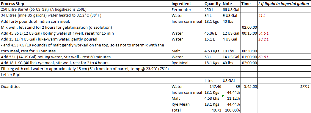

Re: Has anyone made Washingtons rye whiskey before
I have extracted the process into the 21st century!
After all, the US had just split with the English - who obviously used the imperial gallon.
Total time for mashing looks to be 5:45 to 7:45 resting time + actual mashing time.
Water quantity is a thing to be clarified. Did the US already use the US Gal (3.78 L) or since they were still using the Imperial Gallon (4.54 L)? After all, the US had just split with the English - who obviously used the imperial gallon.
