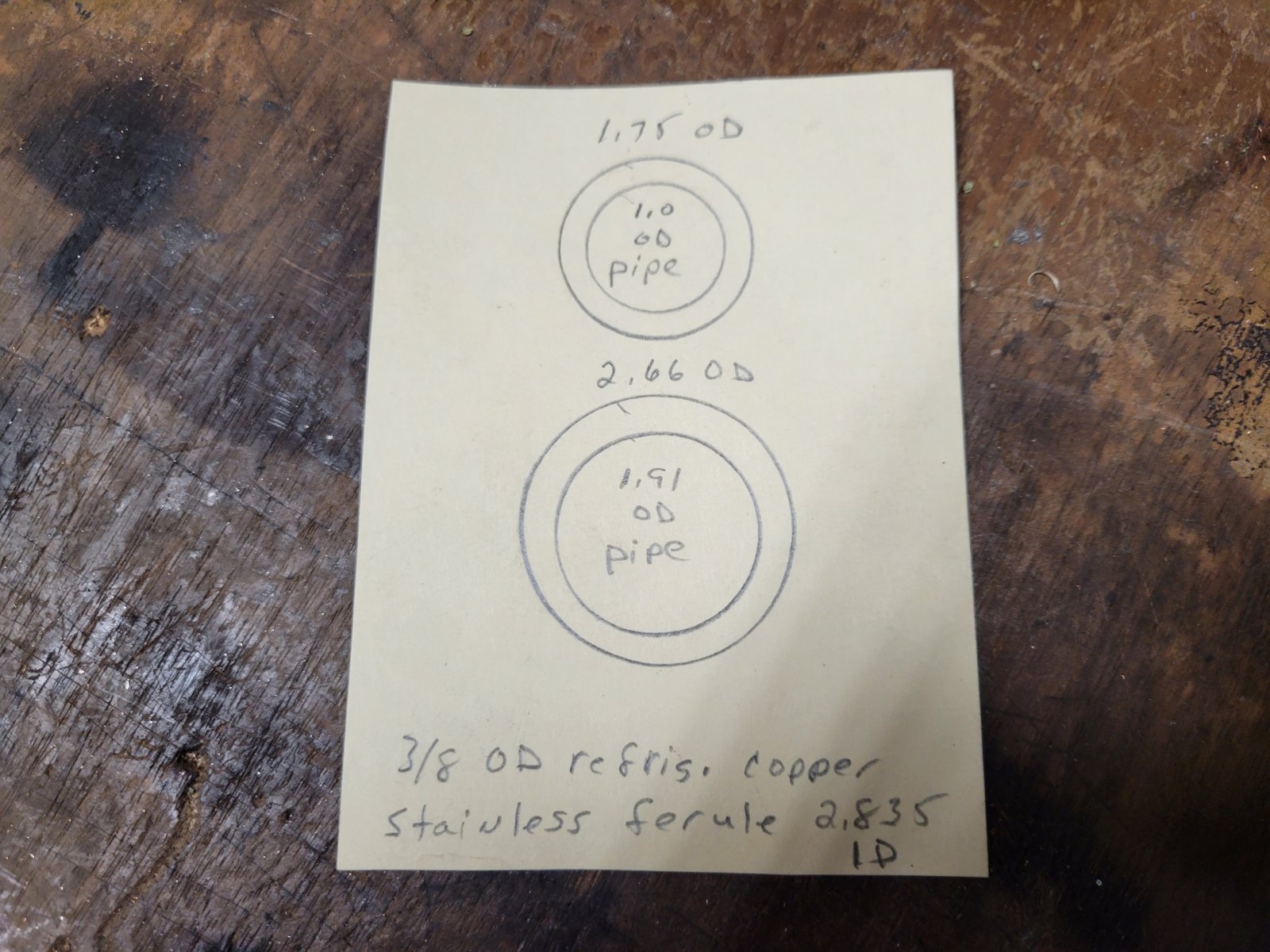

messing around with some pipe i had for a mandrel and decided to make some rings to see the clearance i would have, outer ring went good. when doing the inner ring it was going good to decided to roll with the rest of the spare tubing i had. ended up with a 8" length coil, salt was used. Have a 20' roll on hand so should be good to go.
cheat sheet and pic of inner coil

thanks for the feedback guys
Searching the archives don't know if cold finger would be the right term, would call it a supply line to the bottom of both coils. Now thinking will use a 3/8 line down the center going to a tee to connect the coils together, i wound the coils in opposite directions to accommodate this. still a bit more work to finish the condenser.

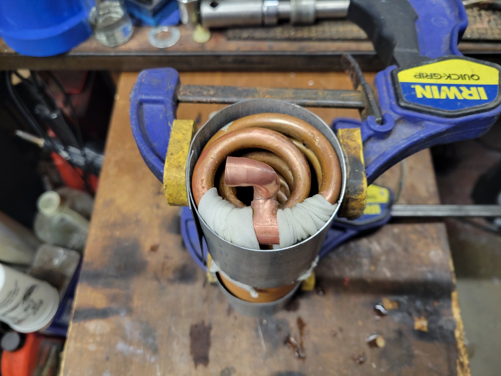

thanks guys yall are giving me encouragement. took the day off and did some needed yard work, decided just to have a few cocktails tonight and have the rest of the weekend to work on it so just did some prep tonight to get her ready to soldered up. Built this jig out of some scrap sheet metal to hold the coils together at the tee's when soldering so the joints don't move and to level it when soldering. Will solder the double 90's first then fit the offset supply line.
Kimbo good eye and on time, your curiosity made me weigh just the coil and wouldn't say it is overly heavy at under 2 lbs, think final weight will be a tad over 2 lbs. Saying that the support was my next step and has evolved to this layout, it was one of the reasons i decided to build a copper coil to allow a copper plate that was easy to adapt to the coil to accept a stepped motor like in this thread here, thanks @Mereside.

Re: 3" CCVM
tacked the supply tube to the top before soldering the elbow on bottom of coil. next up fit the last elbow on the supply to match the other side.

couple minute soak in a 4 to 1 hydrochloric acid bath then a wipe down witch a scotch bright pad.

going to call this a wrap for now, cleaned up and ready to try in my LM rig in a couple weeks.
