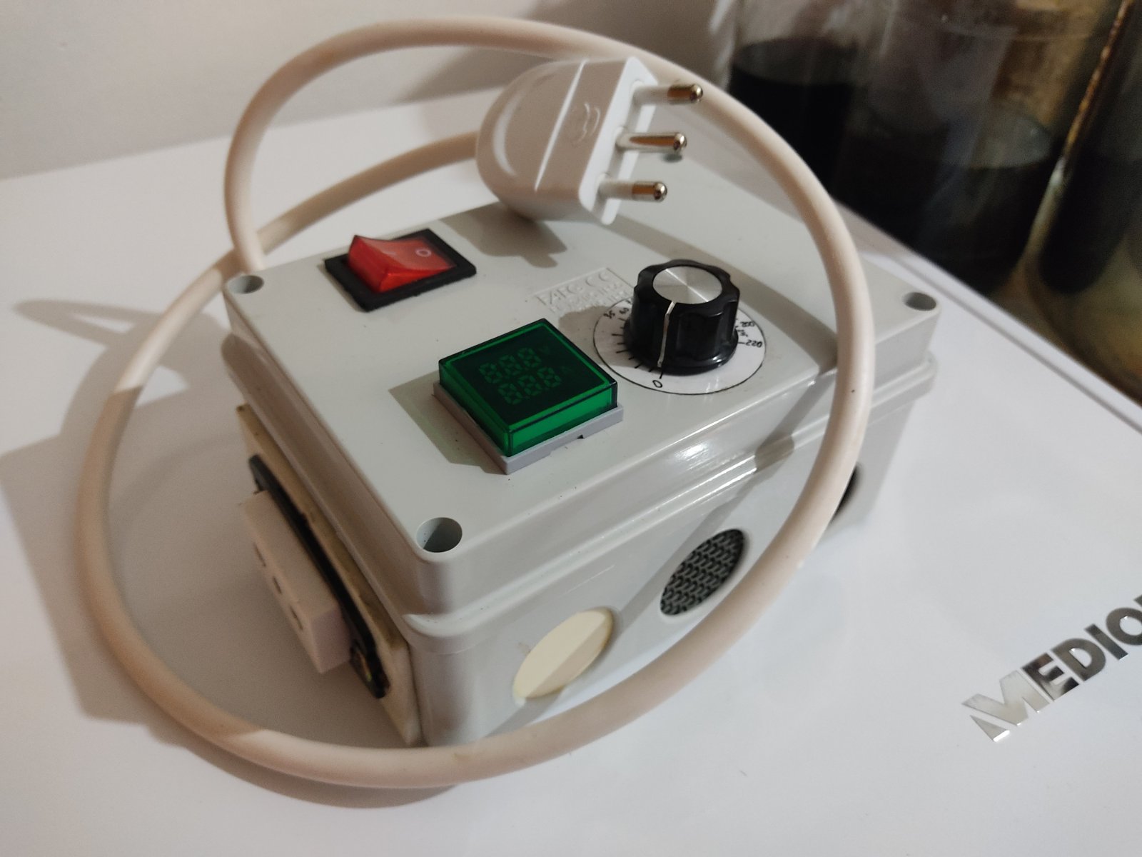

I finally got around to building my heating element controller yesterday. Nothing special, but a couple people have said they wanted to see it when it’s done, so I’m sharing what I did.
It’s built around a 40A SSR, with a 30A rating on most of the components since that’s the largest circuit I expect to have access to for the time being.
I added a power switch in the potential water circuit, since 30A 220V switches are expensive, and I realized that most of them are 40A SSRs anyway.
The bus bars are rated for 150A, so even if the stated rating is 400% exaggeration, it should still be safe. I opted for bus bars for two reasons. For one, it made connecting things like the potentiometer ground and fan (110/220v rated) leads clean and easy. More importantly, it made it easy to connect both a 110 and 220 power cord.
All power wires have solid copper ring terminals crimped on and heat shrink tubing over the joint. I’m relying on the ratings on the terminals I bought, but they definitely seem heavy enough to do the job, and far heavier than the typical hardware store items.
I designed this to run on either voltage, depending on where I’m working and what I have available. Obviously, it’ll be severely limited on 110, but I think it’ll still be more power than I have been using for a spirit run, so hopefully still well within the usable range. There are two power cords, and the plan is to have whichever one is in use extend through a hole in the side of the lid while the other stays neatly and safely cooled inside. That’s the primary reason for putting this inside a plastic tool box, as the top tray and lid serve as an effective enclosure for the exposed pins.
While I realize that there are ways I could electrocute myself by being ridiculously careless and stupid, that risk also apples equally to most of the rest of the hobby, including drinking the final product. By only having one cord exposed at a time, and by ensuring that the case is latched before plugging in, I consider it a reasonably mitigated risk.
I have yet to test it under load. It does work to heat the element in free air, and the power switch does work. So at least I know I’ve got that part right. Hopefully, if I’ve missed anything obvious or serious, someone will point it out here. I’m always willing to learn.

That's a fine job.
But I didn't show us any vent holes.

Is that better?
When I started looking for a safety cutoff switch, one of the things that popped up was a three position rotary selector, rated for 32A. I realized that I could use it as a master power switch and also to isolate the two power cords. And it was cheaper than a 30A double pole light switch. So that was a no brainer. All I had to do was make up a couple short leads, and drill the holes in the case for the switch. Easy modification.

I wired in a meter today. Thanks for the recommendation, Setsumi. I found something nearly identical on Amazon that was a couple dollars cheaper with shipping, so I went with that.
I opted to connect it to the output of the SCR, since I didn’t know if the output voltage would vary or not. It does, at least according to the meter. I needed a shim to get the meter to fit properly, so I opted to 3D print it. Since I was doing that, I figured I’d make myself a nicer knob as well. And I went ahead and rewired the potentiometer so that it turns the right way. A quick test on 110V (with the element connected, so that there is a load on the system) seems to indicate that only the last 20% of the pot travel is actually useful. Is that common, or just a fluke of the meter I’m using? I noticed that when using this on 240V during a stripping run, I kept it at about 50%, so obviously there is SOME usability below the top 20%.
While obviously it would be nice to have accurate information, the primary reason I wanted the meter was for repeatability. And curiosity, of course.

Steve, Looks like a nice build. The wiring is neat and doesn't look like a plate of spaghetti. I do have a question though about the buss bars. I was trying to see if the bolts that hold the buss bars to the bottom of the box are common to the buss bar. It appears the hold down bolts that attach the buss bar to the box bottom might be common. Does the bottom of the box have a false bottom so the bolts that hold the SSR and buss bar bolts don't extend outside the enclosure? There are a lot of smart people on HD, I hadn't considered using a 240 volt SSR for a dual voltage controller.
- Steve Broady
- Site Donor
- Posts: 1104
- Location: NC Piedmont
Re: Dual voltage controller
The bolts on the bus bars are insulated from the wiring. The last thing I want is a live 240V terminal exposed on the outside! I see why you’d think that, but in fact the bus pat is a piece of plastic, with a metal plate on top for the terminals to connect to.
There is no false bottom. The SSR is screwed to the heat sink, which in turn is bolted to the box. While I have not personally checked, I am operating under the assumption that the case of the SSR should be at ground potential, or at least not connected to one of the live terminals.
