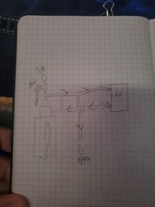

No need to delete it at this time. I do have a concern with the difference between open and close systems being confused. Diagram above is for closed with condensate return.

acfixer69 wrote: Fri Sep 22, 2023 3:21 pm No need to delete it at this time. I do have a concern with the difference between open and close systems being confused. Diagram above is for closed with condensate return.
My idea is a open system with two outputs
one leg is open to atmosphere, the other would run through a heat exchanger with the condensate running back to the open boiler.
There is no risk closing off the main output and causing any over pressure situation. Worst thing that would happen is that I don't have enough heat where I want it.
With a steam trap and condensate return pump the system is closed, and not what a home distillation system would typically be.

acfixer69 wrote: Fri Sep 22, 2023 4:04 pm With a steam trap and condensate return pump the system is closed, and not what a home distillation system would typically be.
Not a closed system

Post by zach »
It looks good except the part you have open should be trapped with a few feet of water to provide the back pressure you need for the heat exchange to prove the capacity needed. The deeper the column the higher the steam condensing pressure and higher saturation temperature.

zach wrote: Fri Sep 22, 2023 4:30 pm It looks good except the part you have open should be trapped with a few feet of water to provide the back pressure you need for the heat exchange to prove the capacity needed. The deeper the column the higher the steam condensing pressure and higher saturation temperature.
Thanks Zack, yeah it will be, this was just a quick drawing to show it wasn't going to be unsafe.

Hey Bolverk, I don’t want to be a negative Nancy, but I struggle to see how this design will work. It looks like the steam supply and condensate return are both connected to the boiler, so will be at the same pressure, so nowhere for the steam to flow other than out the vent, without going through the hx. If you want to recycle condensate back to the boiler you’ll need a condensate pump.
For safety’s sake, I’d suggest sketching out your full design and do the maths to estimate the temperatures, pressures and flows you’ll have through the system. Or else use a known design where someone else has done the hard yards. Steam is awesome, but it really is a dangerous beast.

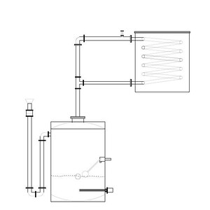

There is a reason most jurisdictions require an operator's license for steam boiler operation and contractor or engineering license for design. My first post in this thread was an answer to a theoretical question, but as been pointed out is not practical or affordable for this hobby, especially for those who don't fall in the first three categories.
It is possible to feed steam to a heat exchanger with condensate return in a one pipe system if the the piping allows gravity return. This piping needs to be purged of air on start up. Many older heating systems use one pipe radiators. In effect it is like a reflux condenser.
If it's not possible to get the condensate generated in the heat exchanger back to the boiler because of geometry, then a separate water trap can be used to provide back pressure and accumulate condensate. Again air purge valves may be needed to remove non condensable gas. This type of feed is less efficient as condensate does not return to the boiler, and the boiler feed water is at a lower temperature.
