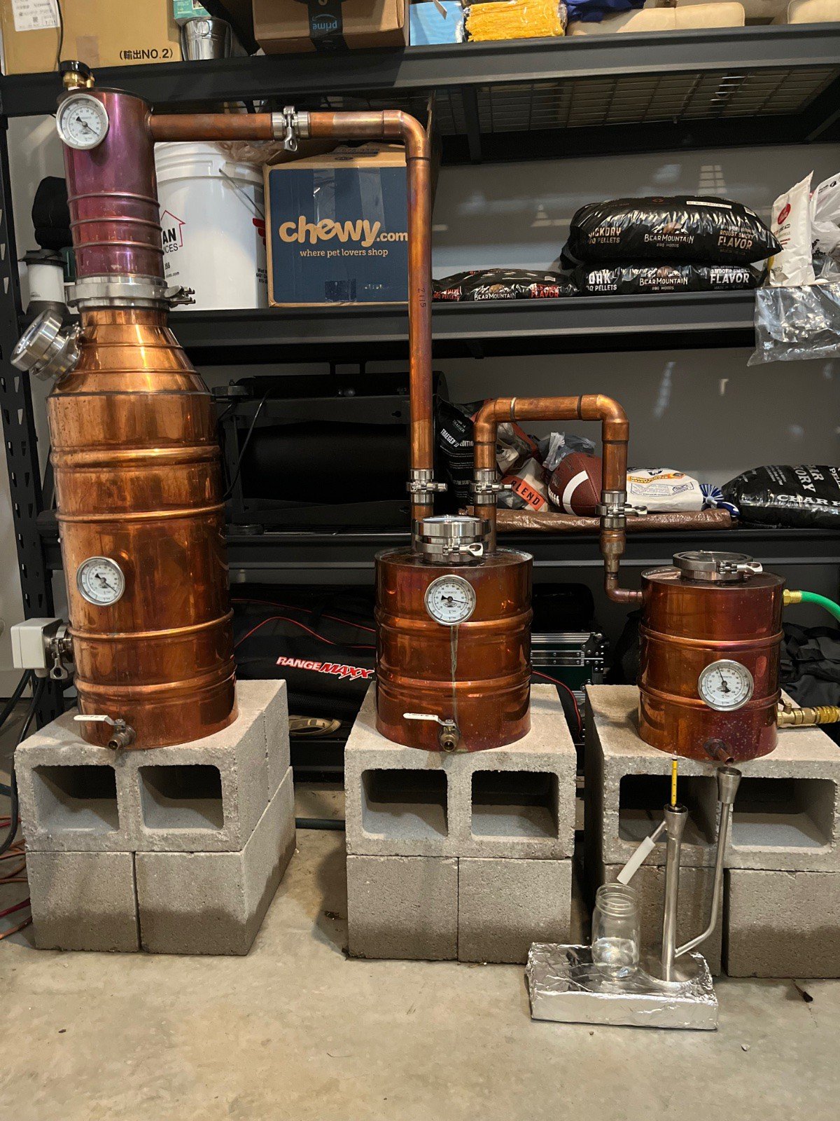

- Posts: 219
- Joined: Wed May 24, 2023 9:40 am
Re: New pot and thumper, second run issues
Pic of the rig for reference
