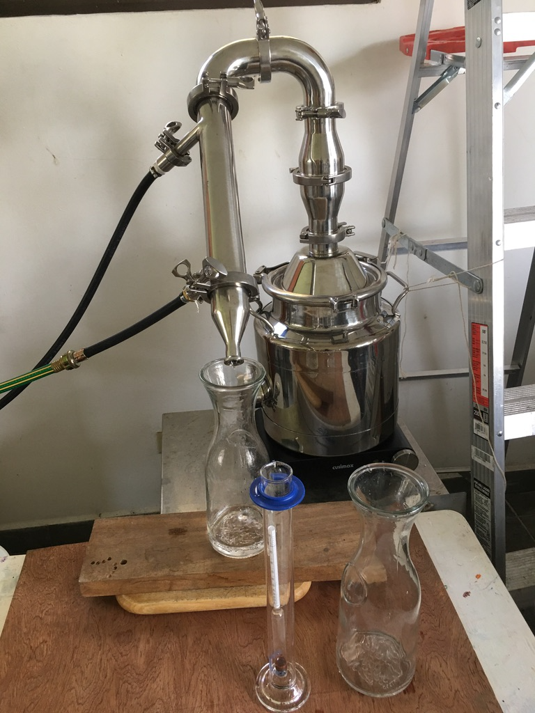

Since you already have a good supply of GNS, a 3 gallon stainless milk can boiler on top of an inexpensive 1500W hotplate is a great way to go. For condenser I recommend one like the 2" diameter Stainless Steel Medium Product Shotgun condenser that Stilldragon makes.
ginfitz
Posts: 20
Joined: Sat Jun 27, 2020 1:59 pm
Re: Heating element vs botanicals
Post by ginfitz »
Here's a picture of my gin setup with the 1500W hotplate under the boiler. I also have a gin basket but rarely use it.
