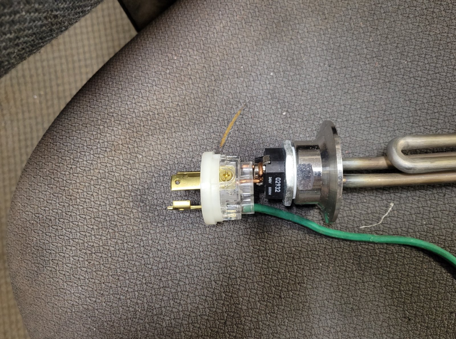

My last stripping run, after shutdown I noticed the heater cord was warm.
This post reminded me to investigate. I found this:
It should look like this:
In the first pic the failure of the heater post connection to the screw terminal can be seen.
Going forward, I'm soldering my crimps, though this wasn't a connection failure but rather a component failure.
Edit: upon further inspection of my new replacement heater, I found that one of the heater post connections to the screw terminal has broken away. If I would have hooked it up and turned it on, I would have had the same issue again. Just dug out my big soldering iron, hopefully I'll get some time tomorrow. Don't know if I'll be able to get a good pic of the break though. If possible I'll post it.

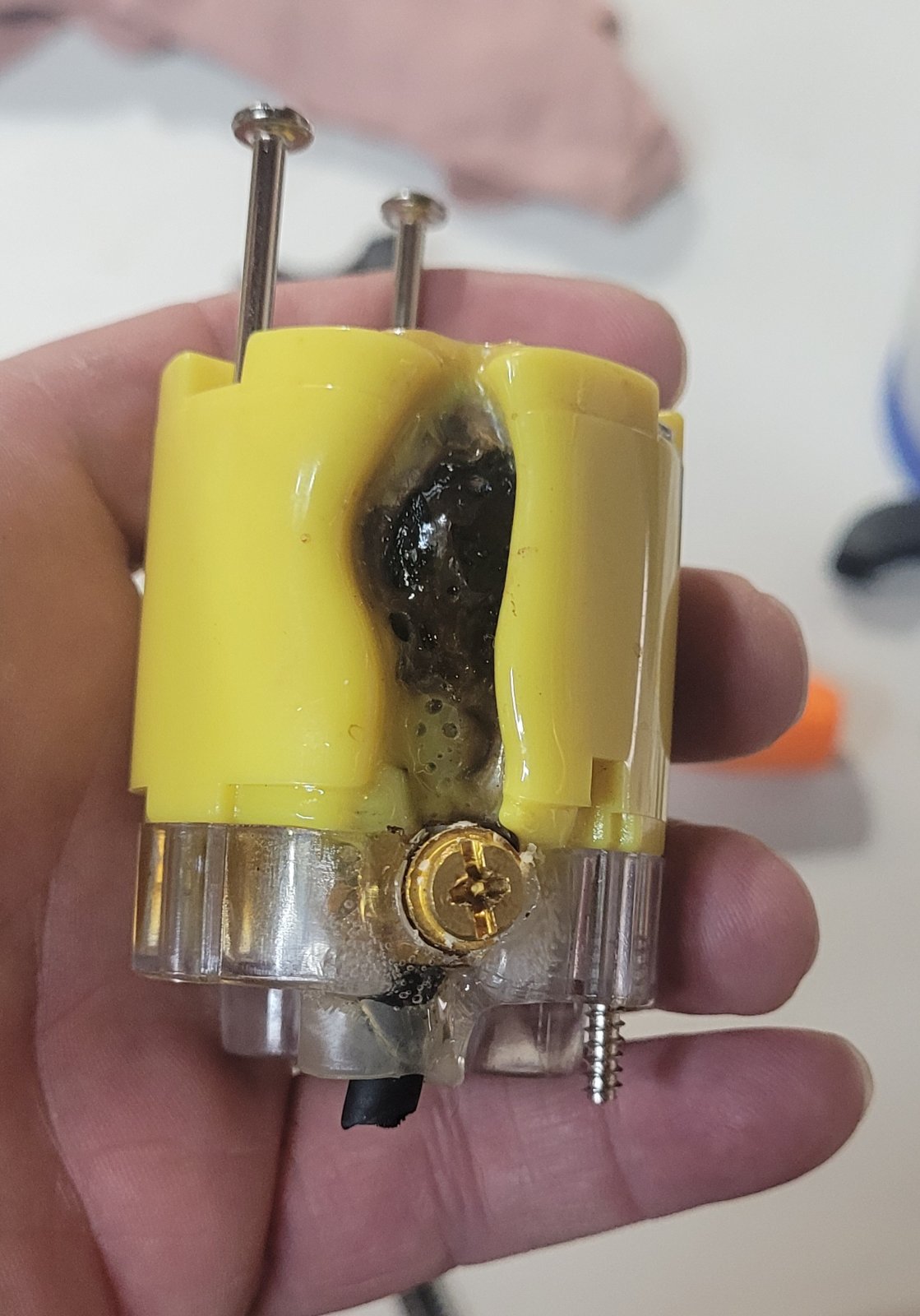

Always check your wiring, never leave a running still unattended, and keep a fire extinguisher within reach.
While stripping my CROW bourbon today, I'm putzing around in the garage when I smell burning plastic.
I turned around and saw smoke coming from my L6-30 plug at the element.
Killed power at the controller and unplugged from the wall.
A quick trip to the hardware store, and in 30 minutes I'm up and running again.

WOW fried plug!! Bet that CROW is gonna be fire though! :D Glad it all turned out good.
