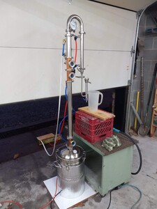

My Frankenstein still, ready for her first neutral spirit run.
Column is 38" tall. Ran vinegar and sacrificial today. The RC worked like a charm (I think). I was finally able to control the reflux, fairly precisely, with the needle valve. The windows let me see how much was being dropped back into the boiler, so I could get an estimate of reflux ratio. Whoot Whoot! Just 1/2 a turn open on the needle valve was enough to put the still in full reflux.
Now is my ability to put this still in full reflux for the first time due to the fact that I have a new larger deflag? Or is it that the still was charged this time with10% low wine (diluted feigns) rather than the higher 40% I had been using weeks ago? Regardless, I think I am on the right track, and anxious to try my hand at a few spirit runs in the very near future.
Will certainly be taking NormandieStill and Yummyrum advice. Will shoot for a 25%-30%ABV charge, little less than a full boiler. Thanks again guys!

PoolGuy wrote: Sun Dec 10, 2023 3:36 pm
The higher the ABV the lower the boiling point thus a lower condensing temperature and a smaller PC becomes equally effective.
... and when you get to running a keeper be sure to lose the plastic collection pitcher and use either glass or stainless.

looks like you rig is very similar to mine, as in height, deflag, PC.
i think the 8-pipe condensers are much more effective, both my deflag & PC are these.
the PC can handle everything my 2400w can throw at it.
the deflag can handle reflux power levels easily, but can't quite handle full power.(not that i use full power on reflux obv)
i have pipe insulation on my columns, i have seen the effect of wind, but i distill outside.
it looks like you're distilling inside, but it still might be worth insulating.

If this column will house packing you should insulate the packed section of the column. I'd make a run to Lowes for instance. You can find pipe insulation there. The best insulation I've found there was like a slightly rubbery, Neoprene pipe insulation. That stuff is truly amazing insulation. It costs more than the Polyethylene foam insulation, but that's because it is MUCH better. For my 3" column I needed two pieces (I forget the exact size) to wrap completely around my column and it fit perfectly.
I bought a roll of Velcro strap from Harbor Freight to aid in securing it to my column. I think you can find that stuff on Amazon too.

Column insulated: Check
No plastic pitchers: Check
Started with 4-1/2 gallons of feigns at 27% ABV this morning. Everything worked beautifully. Collected around 4 liters at better than 93% ABV. The clean neutral I was looking for has been found. I am convinced that the 1-1/2" short 3-tube deflag that came with this "HooLoo" still is woefully small for the task. And the taller packed column also seemed to be a key ingredient to achieving my goal. I am a happy camper.
I did learn (with help from Haggy and his calculators) that today's run had more power than needed (2094 watts) and thus required more RC cooling water volume than needed (about 1L/min). I will back off on my next run. But the job got done!
I have more SSS stripped and ready to run, and also a first generation UJSSM, just for the heck of it, that I should probably focus on getting into the still.
Un so, my original post "Troubles running my new CM still" has been solved. Thanks to all who provided there two cents along the way. I feel like I have graduated to second grade.

Saltbush Bill wrote: Sun Dec 10, 2023 3:53 pm Some time in the future, once you learn to run it a bit better, try running two or three plates under the packed section......you might find that you like it that way and that it produces an even better neutral.
It doesn't seem to be a popular idea here but plenty of folk have good success doing it that way.
I hear what you're saying, But not "those" 2" sieve plates. :lol:
Posts: 8903
Re: Troubles running my new CM still
PoolGuy wrote: Tue Dec 12, 2023 4:20 pm Way to bust my bubble Yummyrum. I actually read a solid 94% at one point today. So there. Take that.
95% must be a second grader or third grader lesson. I'll get them plates back in the bottom as Saltbush Bill suggested. Maybe that will help.
For now I am just basking in today's progress. But seriously, thanks for the nudge forward.
Hee hee
A solid 94% puts you well ahead of the T500 crowd already :thumbup:
shadylane wrote: Tue Dec 12, 2023 5:07 pm
Tend to agree Shady . Also , plates on a 2” won’t like being run higher than 1kw without seriously smearing while the remaining column is needing closer to 2kw to run efficiently . So the plates will either contribute SFA if ran to satisfy the packed section or seriously compromise the packed section if run to keep them happy .
Better to throw the plates and pack the modules IMO.
