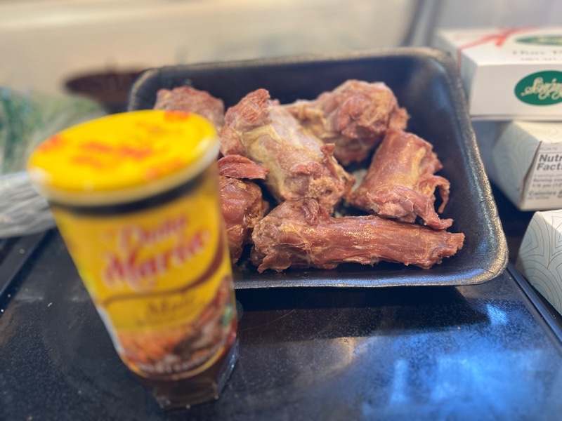

Smoked turkey neck, pineapple, and cranberries from Kroger.

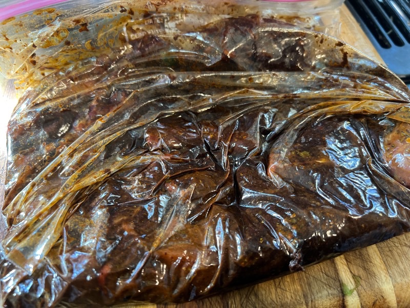

I’ll marinate the turkey necks in mole and spice based marinade overnight and i’ve got some mesquite chips to also infuse a bit more cold-smoke into the mix before running it.

Cut the meat off the turkey necks and added a section of neck bone into the marinade for the run.
