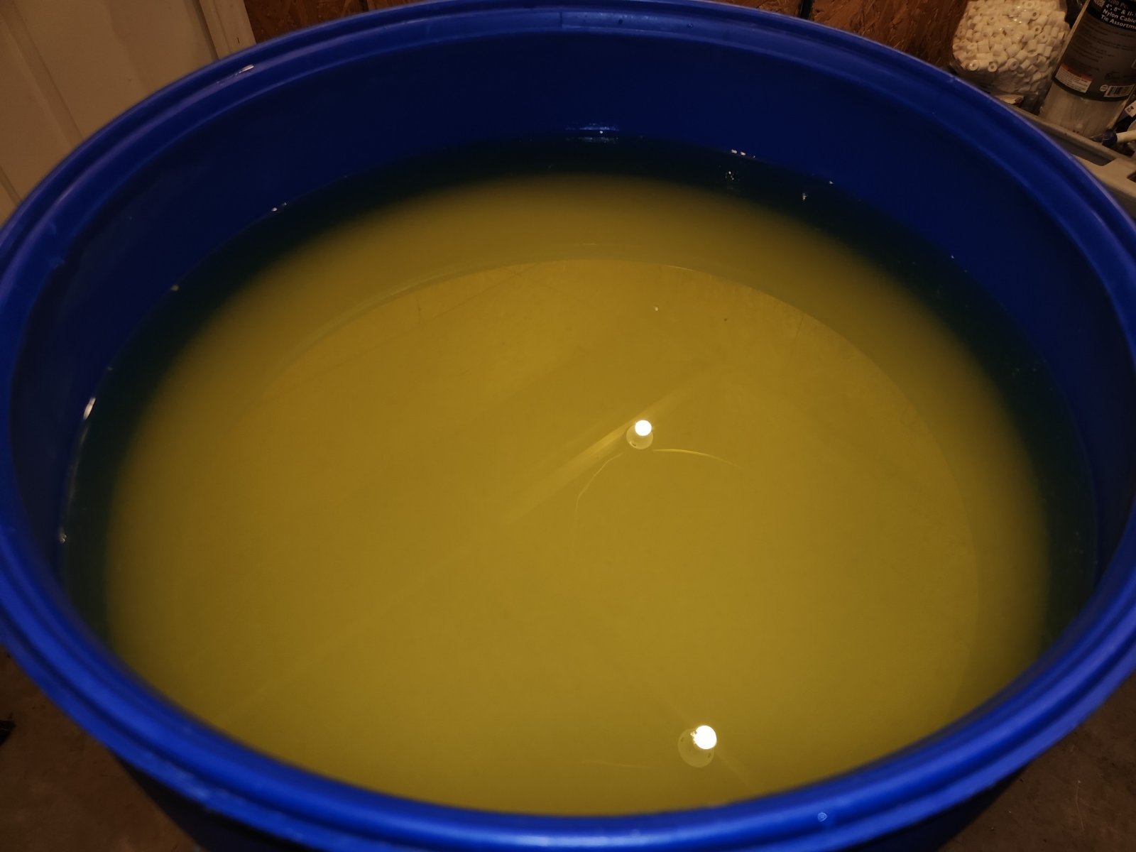

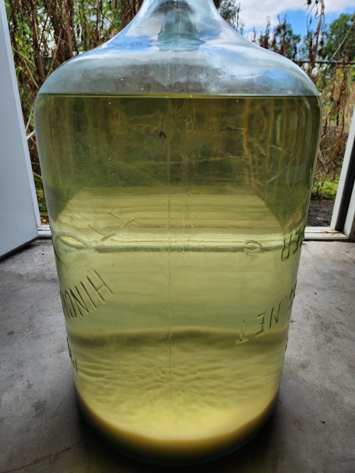

When I remove the pump, flocculation begins instantly right before your eyes. Here's a pic just a couple minute or two after removing the pump. The top inch or so is crystal clear and you can see the wash flocculating.
Just a couple minutes later you can see how much more has cleared.
The following day, not even 24 hrs later, I can see everything settled to the bottom of the drum so I typically rack it. This timeline shouldn't encourage the sediment to stick. When I do rack it relatively close to the trub, if I tip the drum at all, the trub immediately seeks level without sticking to the bottom.

Same here Salty . My outlet is about 2” above trub settling height . I wait until the wash is a few inches above the outlet then tilt barrel and stick piece of 3x2 under it . ( any sooner and it’s too heavy to tilt …… I like your wedge Shady) Keep moving 3x2 forward as needed . Trub stays pretty much a solid cake .Saltbush Bill wrote: ↑Wed May 15, 2024 1:33 am screenshot.png
What your suggesting there is what Ive done for years Shady. It works particularly well if the tap opening is tiny bit up from the bottom of the fermenter.
Let the wash / mash settle for a while and you can then drain it off getting 99.99% of the wash out without any yeast.
In short , its low tech but works as well as any method that Ive seen or used to separate what you do want from what you don't want.
Never needed Bentonite or other clearing agents .
BTW , do the same with barrel of Rum wash .
Mind , I do let ferments rest for a week or two after finishing .

But what works best depends on how firm the trub is, a sugar wash usually flocculates quickly after it's done. There's nothing left to eat and nothing to cling to.
If the fermenter is tilted away from the valve, there's fermented wash trapped that can't be saved.
This also causes problems with rinsing out the fermenter after use.
- Posts: 11541
Re: Clearing Sugar Wash - Are Conical Tanks Effective?
Had to go to the stillhouse and look, cane in right hand, beer in the left and flash light in the other.Saltbush Bill wrote: ↑Wed May 15, 2024 1:33 am
The drain tube extends almost an inch above the fermenter floor.
