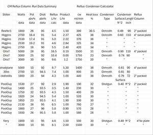

I will keep posting a lot of the reflux condenser run data that I have collected and show everyone how the the calculations fit with the data. That is all I can do, judge for yourself the viability.
Sorry, but I think there is a place for something like this in HD as an addition / update / improvement to the current Condenser Size calculator, so I am putting the information forward for evaluation. I can take the heat.
More and detailed information about this condenser calculator is posted in the thread "New Condenser Calculator". You can check out that thread also.
So,
Here is a post from OtisT that is very similar to shady's run. A packed reflux column at total reflux. His Dimroth condenser is discussed in a different post. This is a VM column.

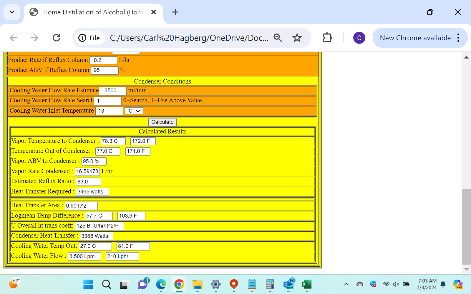

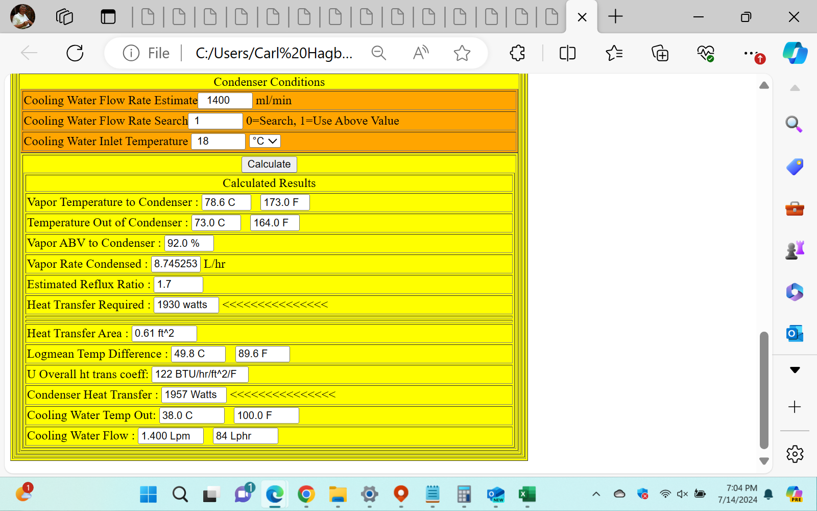

Next is the Condenser Calculator inputs and results for this run using a 3.5 L/min cw flow rate. Notice the watts for the Heat Transfer Required ( 3465 watts ) and the calculated Condenser Heat Transfer ( 3388 Watts ) for the 3.5 L/min cw flow rate. Not a perfect match, but pretty close. And again, this is not the 5000 watts pot power. And the cw exit temperature is warm.
This is good data, one of the few stillers who post the condenser cw flow rate and the measured product flow rate for a strip run, but this is a total reflux run and the product flow rate is not included here. I will find some stripping runs where the product from the condenser is measured and also reported so my vapor rate correlation can be checked.
And,

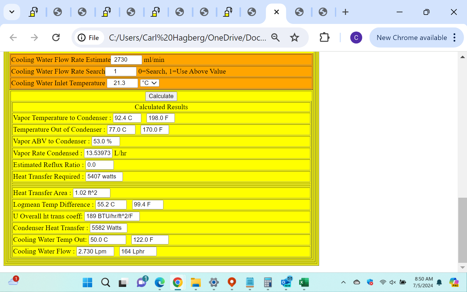

About a year ago, Yummyrun ran a stripping run for me and took a lot of condenser data, and then sent me the data. I found in my files several data points of the run. I put the data into this new condenser calculator and report the results here.
He used a shotgun condenser for the 4" unit. The good thing here was the measurement of the product rate in L/hr so we can compare it to the pot strip rate estimated by the condenser calculator.
Data was taken at the start and during the strip, so we can see the effect as the pot abv decreased. The run was made at a high 6000 watts power, cw flow rate of 2.73 L/min, cw inlet temperature of 21.3 C . I cannot find the cw exit temperature data. These were the same throughout the run.
The copper shotgun condenser was 7 x 0.5" tubes , 13.4" long in a 2.5" shell.
Here are data for three points during the run:
Here are results of the condenser calculator for these data points:
You can compare the calculated product rates L/hr above and see a good enough agreement with the data. Also, the calculated Shotgun Condenser Heat Transfer using the 2.73 L/min cw flow rate is close enough to the Required Heat Transfer. For points 2 and 3, the lower pot abv% was input in the calc to give the product abv% of the data.
And for this strip run where there was little or no reflux, the calc heats are close to the 6000 pot watts used. There probably also was some subcooling, but that would be a small addition to the heat required vs the larger effect of the condensation heat.
The Condenser Calculator results for the three data points are shown next.
And this was real, accurate stripping run data.

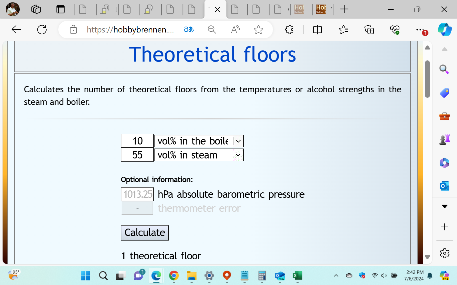

I stopped by the hobbybrennan.ch web site and looked over the Calculator section. And I saw two calculators that drew my attention.

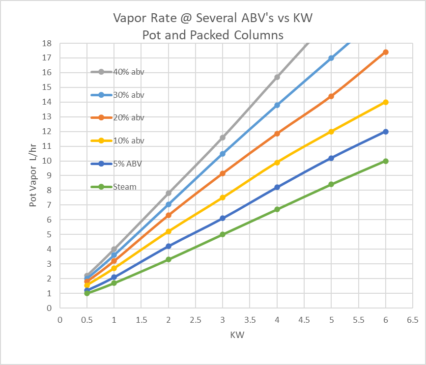

The first calculator ( Theoretical Floors ) can find the equilibrium vapor abv% from the pot abv% if the result is one theoretical floor ( plate / distillation step ). So, the vapor abv% is just a function of the pot abv%. They are connected at the equilibrium conditions. The hobbybrennen calculator says that for a 10% pot abv%, the equilibrium vapor abv is 55%. Ok - That agrees with the value that I calculate also.

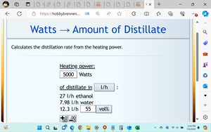

The second calculator ( Watts -----> Amount of Distillate ) Ok, that is what we are looking for for a pot strip operation. But you need to put into the calculator both the Watts and the vapor abv% also. So I ran that calculator with 5000 watts and the above vapor abv of 55%.
So that says 12.3 L/hr distillate rate for 5000 watts at vapor abv 55% ( or pot liquid abv 10%). Let's check this out with the multiline chart two posts above. Well, at 10% pot abv and 5000 watts, we get a vapor/distillate of 12 L/hr, pretty close. That lends some credibility to the chart above.
___________________________________
Let's do it again. No pictures this time. Check it out yourself.
For 20% pot abv, the equilibrium vapor is 68.6%, from the first hobby calculator.
For 3000 Watts and 68.6% vapor abv, the distillate rate is 8.7 L/hr, second hobby calculator.
The chart above at 20% pot abv and 3000 watts gives 9 L/hr. Not exactly the same but not bad.
________________________________________
You can do this many times and get similar results, not an exact match, but close.

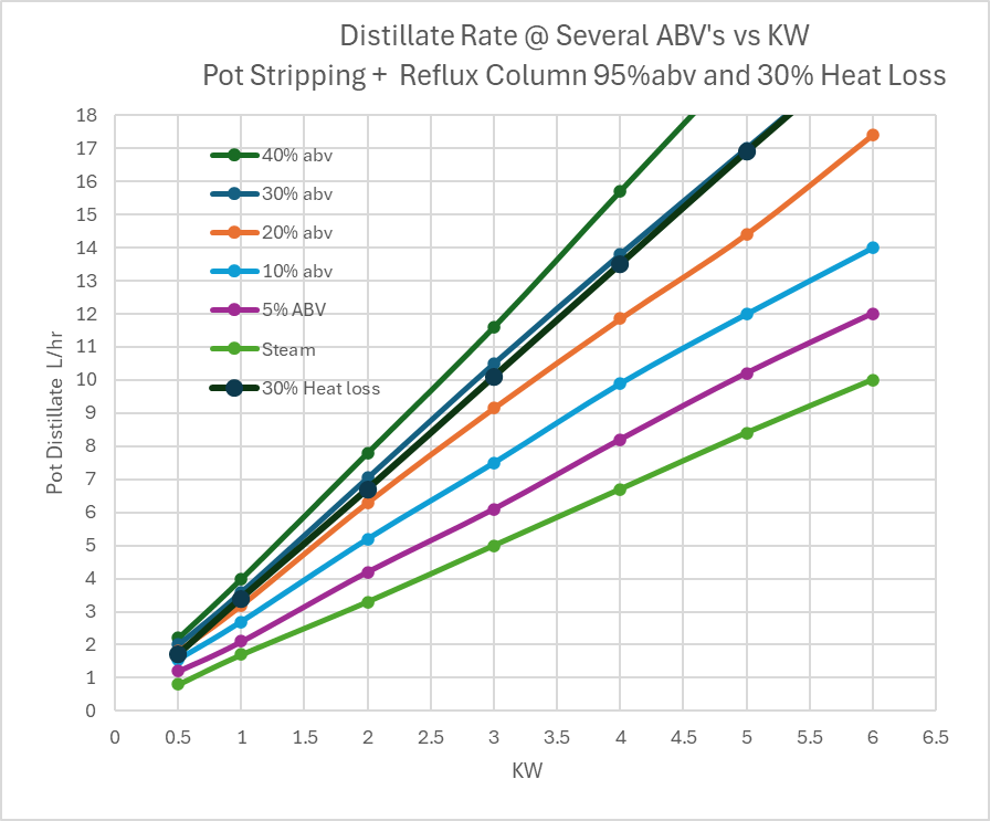

The moral of this story is that the chart above which is based on an HD calculator does have credibility ( via hobbybrennan calcs) and can be used for the condenser pot strip operations. Yummyrum acknowledged this also. He said ( That graph looks pretty much in line with what I have found ) in the post I referenced above.
And the chart above is based on the pot abv% and the pot watts.
I developed a correlation equation to predict very well the lines in the chart above. This equation uses the pot abv% and the pots watts. The chart and correlation equation agree fairly well with hobbybrennan calcs, so It must not be a mistake.
haggy

I am looking at the green line of your chart (water steam):
And I see that with 0.5kW you get 1lt/hr. And when you use ten times the power (5kW), why don't you get ten times the vapor? Why 8.3lt/hr instead of 10lt/hr?
At those wattages (0.5kW and 5kW) the hobbybrennen calculator calculates 0.8lt/hr and 8lt/h.
The hobbybrennen values are what physics say. It's theoretical by means that no heat losses are taken into account, at least in this simple watts -> amount of distillate tool. But also your calculator doesn't try to consider heat losses, right?
There is a physical constant, how many Joule you need to evaporate one mol of water. And there is another constant for one mol of ethanol. I think you know those constants. I would start to calculate with those and then check if practice differs. And then perhaps you have to think about why it differs and if it matters for your calculator.
(By the way, there are English versions of the hobbybrennen calculators too. You don't have to auto-translate them. Then it doesn't say "theoretical floors" but the right term "theoretical plates". And some of the English calculators have also °F, gal and lbs implemented)

I have been reading more and more and have just found some stuff that might explain some things about the reflux column that I had not realized before.
The stuff I have been calculating for a pot stripping operation using the distillate rates in the above chart should be valid - there is little or no reflux. The input heat by the pot watts is about equal to the calculated heat condensed. :thumbup: Good
But that chart probably does not apply to a reflux column :thumbdown: - it gives too low a vapor rate at the top and does not give an energy balance.

That info did not sink in until I found this article that explains something about a reflux column and the vapor rate out the column and heat dissipated in a reflux column:
https://www.brewiki.org/fractional-dist ... 5%20water.
It is hard to understand everything in that article, but it gives a way to calculate the reflux rate at the top of the column.
I am current updating my reflux column calcs for several sets of real reflux column data - more sets will be done later. I have modified my calculations based on some information from the article and I do calculate that the pot watts vs the heat dissipated by the RC and PC condensers are about equal to each other. :clap: Yeah
The vapor rate we want for the reflux condenser is the vapor rate at the vapor abv at the top of the column and the pot watts. The vapor rate along the column can also be calculated if we know the vapor abv at that plate or packed length.
The article helped me to better understand what you were saying Hugelwilli. Sorry that I did not get it right away. I was thrilled with the fit to most of the reflux condenser data using the pot still vapor rate, but it did not meet the criteria that you mentioned.
I will post some discussion of what I think the article is saying and post some of the data set results and update my Condenser Calculator and update the Packed Reflux Column HD file.

Hugelwilli said while I was writing my mea culpa:
The curve values below 1 kw are not as accurate. The curves should probably go from the value at 1 kw down to zero at zero watts, they don't.
I think most pot strip stillers and reflux column stillers are more concerned with > 1 kw watts than the 0.5 kw. Hmm Maybe I am wrong there also.
I like the 8 vs 8.3 L/hr comparison at 5 kw.

This last update was for the reflux column flow rate to the condensers. It depends on the pot watts, vapor abv at the top plate or packing and the pot/column still heat losses.
So,
At the bottom in this post is a graph of what to expect for the flow rate to the condenser for reflux columns at 95% and 80% top column vapor abv run conditions and for three heat losses. It has been seen that a 30% heat loss fits data from many reflux columns.
I did a lot of studies early this year to find a good model calculation to predict / estimate the heat transfer in a reflux condenser. Much of the data for those studies came from many runs that PoolGuy made on a 2" CM packed reflux column. He took complete run data including cw flow rate and cw temperature in and out the condenser. We worked together to find good run conditions to give 95%-96% abv product and he sent me all the run data.
From the PoolGuy runs, I determined the vapor flow out the top of the column from the reflux condenser data and the product rate. All of those runs were made with low wines and in the watts range of 1500 watts to 2100 watts. Also some other run data from higgins was studied and that was from low wines plus wash in the pot and a watts range of 2000 to 2700 watts.
So what!
Well, the reflux column vapor flow rates in the runs I studied were very similar to the what was expected from a pot strip run, the values given in the above curves.
If you take the reflux column curves in the first graph below for 30% to 35% heat loss and 95% vapor abv and superimpose them on the pot strip graph above - you get the second bottom graph.
In the range I studied, the two lines ( pot strip and reflux column ) give about the same vapor flow rate. So that is why I thought the pot strip and packed column had about the same vapor flow rate.
I will post some more run examples and show that the New Condenser calcs are valid for both the pot strip condenser and the reflux column condenser.

With the new reflux condenser vapor flow calculation, we can get a better result using shady's run data. :thumbup:
The run data post was:
Re: Reflux Condenser Sizing - Packed Columns
Post by shadylane » Sun Jun 30, 2024 5:38 pm
10% wash, 4" packed column. 5kw
The dephleg flow and temp for just barely 100% reflux is 4.1ltr/min and 44'c.

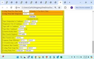

The run was 92% at 5.3ltrs/hour during this time the cooling flow was 1.4ltr/minute at 58.8'c.
The updated Condenser Calculator for the steady run at a 38% heat loss is:
Results next show a good agreement in the Heat Required and Condenser Heat Transfer at the 5.3 L/hr product rate and the 1.4 L/min cw flow rate. The vapor rate condensed here is 8.7 L/hr vs 6.9 L/hr before. And that increased the Heat Transfer Required to match the Condenser Heat Transfer close enough. The total vapor rate at the top of the CM reflux column into the condenser is 14 L/hr.
So, the calculations are on the right track now and we can understand shady's data. The low reflux ratio of 1.7 could lead to the 92% product abv. But the cw exit temperature measurement can be better, it seems too high.

One more example of the Condenser Calculator for reflux column runs, then I will give a summary of almost all the data sets I have studied.

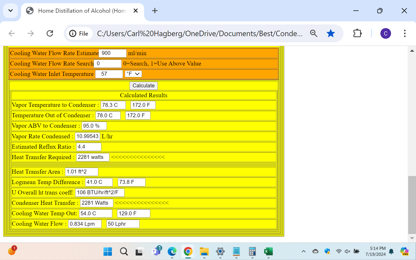

This example is from a run by Reefer1. He has a nice 2" CM reflux column with a Dimroth RC deflagmater. I suggested some set points for him to run and he made the run and sent me the complete run data in good detail. Here is his CM reflux column condenser:
The run was at 1800 watts with 26% low wines in the pot and had a steady product takeoff of 1.5 L/hr at 95% abv. the cw flow rate was at 300 ml/min most of the time.
Next is the Condenser Calculator info for that run. It was found that 30.5% Heat Losses give a vapor flow rate off the top plate of 6 L/hr and 1.5 L/hr takeoff subtracted from that gives condensed reflux flow of 4.5 L/hr. When 4.5 L/hr of 95% alcohol condenses it gives off 940 watts heat. And this dimroth condenser operating with 300 ml/min cw flow rate can condense 938 watts heat. The heats are balanced. :clap:
Input Data
Results
So the Condenser Calculator agrees with the data using a heat loss of 30.5%. :clap: If other heat losses were tried, like 25%, the cw flow rate at 300 ml/min would not give the same condenser heat duty as required, the heats would not be balanced.
The vapor flow rate at the top of the column of 6 L/hr (using my updated calc) is about the same as I found for PoolGuy's 2" reflux column runs at about the same watts and top vapor 95 abv%. And that is also about the same vapor / distillate rate you would get if it were a pot still at 1800 watts and 26% pot abv. Like one of the above graphs shows.

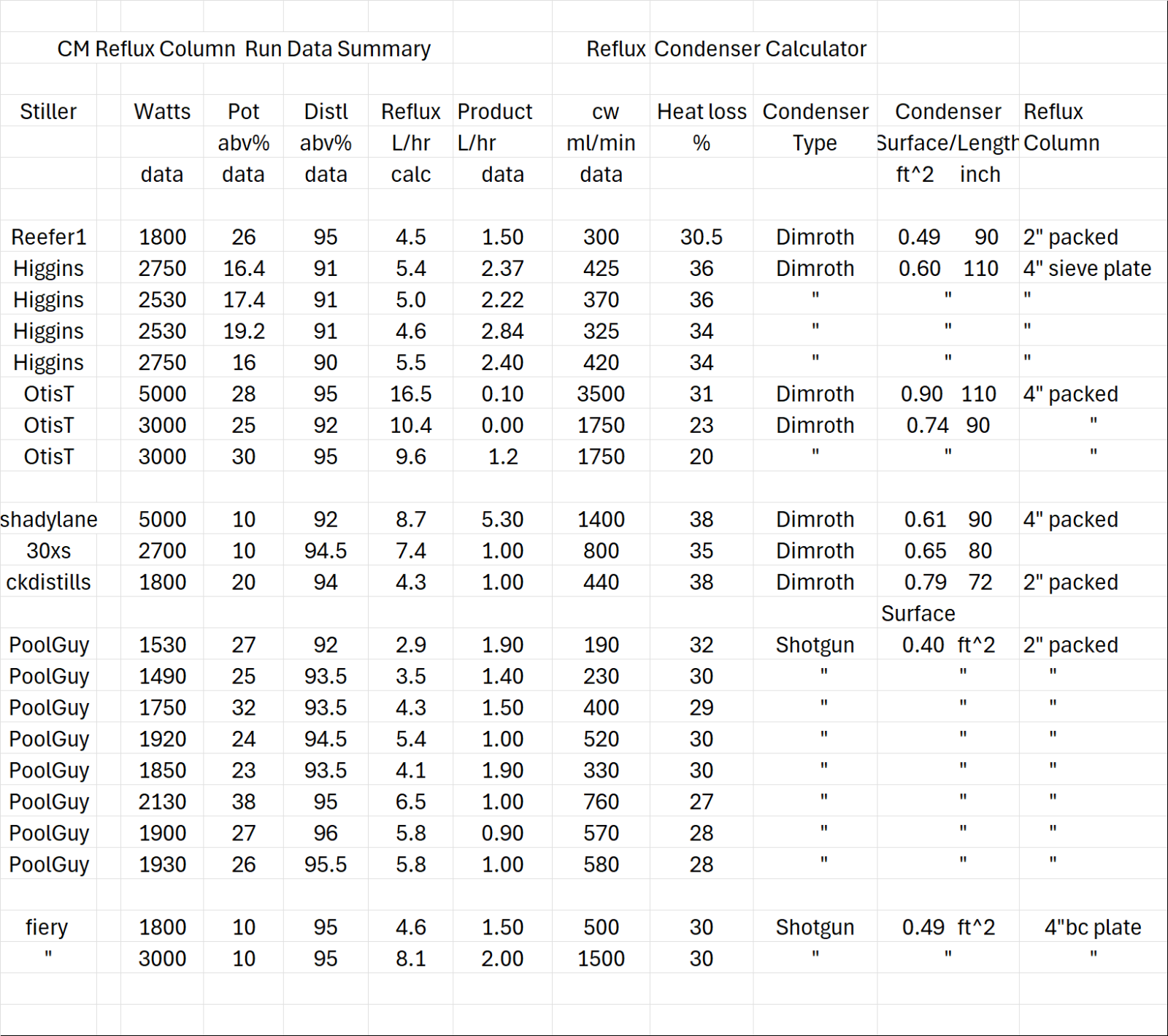

The updated Condenser Calculator has now been tested with several/many real run data sets that I have collected. I will report here CM reflux column data where the "Deflagmater" Condenser Heat Transfer about equals the Required Heat Transfer from the condensing reflux vapor. Good data to test the calculator includes the cw flow rate, and that is not reported very often. But several stillers have sent me good data and I have summarized the test runs here.
The run data was input to the calculator and a still heat loss % was found which gave the cw flow rate reported in the data. There is only one value of the heat loss % that will give the reported cw flow rate and balance the required heat transfer with the condenser heat transfer. Here are the results for both shotgun and dimroth condensers:
The Heat Loss% results varied from about 20% to 38%. OtisT data had low values and shadylane and ckdistills values were high. The average of all the runs was about 31% heat loss and a many runs were around 30% heat loss.
So, using a 30% Heat Loss in the Condenser Calculator should be ok for many reflux column stills and give good ballpark or better results that should be close enough to the real still operation.

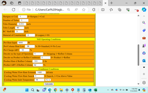

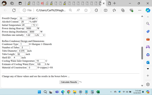

So, with the updated Condenser Calculator ( new calc for top column vapor flow rate), do the initial Condenser Sizing charts in the first few posts still apply.
YES, .... why?

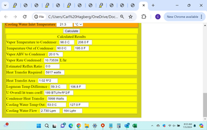

For the shotgun condenser in a 2" CM reflux column operating at 25% pot abv and 1000 to 2200 watts, the vapor rates were found from real data and are about the same for the initial calcs and the new updated calcs at the expected 30% still heat loss. So the 2" shotgun sizing chart is ok.
For the shotgun condenser in a 3" CM reflux column operating at 25% pot abv and 2500 to 4500 watts, there may be a difference at higher watts. Let's check it out.
Here is a 4000 watts, 25% pot abv and 2.5 L/hr product rate case run with the updated Condenser Calculator at a 30% heat loss. A 1 ft^2 surface area shotgun is used and is a good size for this set of conditions based on the condenser settings graph in the first post.
Input Data
Results
The 3" Shotgun Condenser Sizing chart above at 4000 watts with the 1 ft^2 shotgun had the cw exit temperature at about 120 F. Here we get 129 F due to a little higher vapor flow rate now, but that is acceptable. The above 3" shotgun sizing chart is ok. :thumbup:
This same validation procedure can be done with a Dimroth condenser. I have done this and compared the results with both the 2" and 3" Dimroth Condenser Sizing chart. The charts have the cw exit temperature about 120 F and the new calcs give 120 F and 123 F. So, we are ok with the Dimroth charts also. :thumbup:
I am now satisfied with the new Condenser Calculator and will check with Uncle Jesse and try to include it in the HD Wiki Calculator Section for all to test, evaluate and use. I hope it helps with your evaluation and sizing of new and current condensers and determining what to expect from your operating set points.

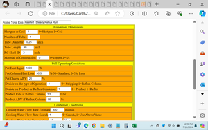

And, here is more details of that run with the Packed Reflux Column calculator:
Input Data
Results
Look through the results and see all the run information that is given. The reflux ratio is about 3.1 and 95+% product abv was estimated. About 2.9 Liters of hearts could be made and there are no column flooding issues and low entrainment. However, these conditions are fairly close to the flooding point, so the watts should not be increased too much.
The Dimroth reflux condenser calcs for this CM reflux column accurately showed the heat required and the condenser heat removed were about equal at the 300 ml/min data cw flow rate. So the dimroth coil calcs are ok. :thumbup: The cw exit temperature is a little hotter than desired. About 30% heat losses ( a typical value ) were used in the input data.

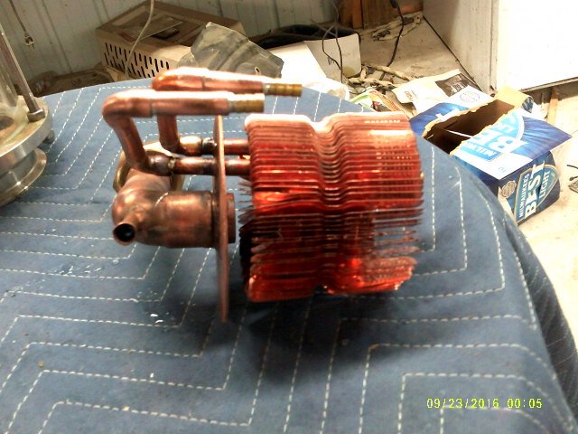

I greatly appreciate the formulas and math for figuring out "Reflux condenser sizing"
But something that hasn't be talked about is the 800 pound gorilla in the room.
A formula based on surface area exposed to the vapor works in theory, but in reality things are often different, due to the variations and design of reflux condensers.
A good example of a bad design looks like this, lots of surface area but the fins are too close together.
The reflux fills the gap between the fins and doesn't have enough room to drain and gets in the way of the rising vapor. Basically it causes localized flooding in the reflux condenser.
Posts: 11547
Wished I'd taken pics, but another bad example was a shotgun with 3/8" tubing.
It also had the same problem, everything looked good until it was pushed hard and suddenly the knock down power crashed. Liquid reflux draining down the small tubing inhibited the rising vapor from cooling.

I'd recommend 0.500" or larger for all shotgun dephlegs, even those that only need to knock down 3 or 4kw. Dephlegs are a two-way street. Smaller than that and the rising vapor impedes the falling reflux.

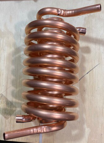

I have to send out a thanks to OtisT.
Almost always, he includes the cooling water flow rate when he posts results of his reflux condenser runs. This helps me confirm or update my condenser calcs to agree with the run data.
He made a novel dual coil dimroth condenser with two independent coils and reported some run results. It has a 4" shell and was used on his 4" packed reflux column. It was used in both a VM and a CM column configuration. Here is a picture of that dual coil dimroth condenser.
The tubes are both 3/8" diam and the inner coil is about 45" long and the outer coil is about 60" long.
Here is the thread describing this condenser along with some data that I will use to check my packed reflux column calcs.
Re: Otis’ 4” Column Condenser - RC / Dephlegmator
Post Wed Dec 01, 2021 5:17 pm
MidnightThunder wrote: ↑That condenser is a beauty Otis! Can you supply any figures on how it performed? Perhaps max knockdown power and water usage.
Hi MidnightThunder. I think I will need to take measurements on a future run to give you detailed specifics. I’ve only got some early notes on this and have since been running by senses and not bothering with measurements. I only recorded data from my CM runs, and did not record any data from running this above my VM head. Here is what I do know from my early CM runs:
My max power output is 5500W and this condenser handles that with no problem.
I can knock down 5500w with a flow under 5 lpm. I think it was closer to 4 or 4.5 lpm for 100% reflux. Max flow potential is about 34 lpm.
Either coil independently was able to knock down all 5500w. The inner (smaller) coil required about .5 lpm more flow for the same knockdown. I tested this by seeing how low of a flow would keep any vapor from passing to the Product condenser (PC).
At 3000 watts I set the flow to roughly 1.75 lpm to achieve a reflux ratio around 8 to 1. I think output shut down to the PC at around 2 lpm flow.

I will show next the Packed Reflux Column Calculator results for the last run mentioned which was at 3000 watts. Both the total reflux case at 2 lpm cw flow and the steady run case at 1.75 lpm cw flow and about 8:1 reflux ratio will be studied.
The cw flow rate is split so that each coil would see about half the total cw flow. Input data to the calculator is two coils and the total cw flow rate. An average coil length of 52" for each coil was used to condense the reflux flow. From seeing other photos, the pot and column were both very well insulated, so a 24% still heat loss was used and a 95% product abv ( similar to other runs ) was likely made.
The Total Reflux Case
Input Data
Results
You see that 2 lpm cw total flow rate was fed, 1 lpm to each coil and the total heat knocked down by the dual coil condenser was 2266 watts. The 11.25 L/hr reflux rate needs about 2308 watts to condense it. So this was a good heat transfer match for the CM column calcs at total reflux, within 2% of each other.
The Steady Run Case
Input Data
Results
The distillate rate was input at 1.22 L/hr to give a reflux ratio of 8. The cw flow rate of 1750 lpm was equally split to feed each coil and the total knocked down was about 2168 watts. The 9.92 L/hr reflux flow needs about 2067 watts to condense it. The predicted condenser duty was a little higher, 4.9%, but right in the ball park. Other results not shown are the run time, hearts made, no flooding, etc.
So, the Packed Reflux Column Calculator is better now and good enough. I will update the one on the HD wiki. Also, there is a separate Condenser Calculator ( see above posts ) that is also good to go, and I will try to put that on the HD wiki.

Now that we have a better Condenser Calculator, I have updated the Reflux Condenser Sizing Charts that were given in the early posts. The sizing results have not changed too much, but we can now see the effect of heat losses in the still. You can use the chart to size a new reflux condenser or to see where your current reflux condenser fits.
The attached charts are for shotgun reflux condensers. There are three charts, for a 2", a 3" and a 4" reflux column. The run conditions the charts are based on are the following:
Item....................... ..2".............. ..3"..................4"
Condenser tubes.......5x 0.375".......10x 0.375"..........9x 0.50"
Condenser MOC............SS.................SS..................SS
Pot KW..................1.0 to 2.2.......2.5 to 4.5...........3 to 6
Pot ABV%................... 25................25..................25
Heat Loss................0%-30%...........0%-30%............0%-30%
Product L/hr.............. 1.0 .............. 2.5 ............... 5.0
Product ABV%..............95................95..................95
CW In Temp F..............57................57..................57
CW Exit Temp F..........120...............120..................120
The charts give the required shotgun reflux condenser ft^2 surface area, A.
A = 3.14/144 x tube diam x tube length x number of tubes
So, after you find the required surface area, you can get the tube length in inches from this equation and your tube design.
First you decide the pot watts you will run, then get the condenser surface area from the proper chart. But your run conditions may be a little different, so the following changes can be done while still adjusting the cw flow rate to give the 120F cw exit temperature.
If you want to run a higher takeoff rate, then decrease the chart surface area by 8% per 1 L/hr increase, but no change if it is a very low watts run. If you want to run at 130F exit cw temperature, increase the chart surface area by 15%. If you think you will get 90% abv from the still ( 5% abv less ) decrease the chart surface area by 4%. There is no change to the surface area if a different pot abv% is used.
The charts give the required condenser surface area for a CM reflux column at the above run conditions where the heat removed by the condenser equals the heat required to condense the reflux vapor. The best line in the chart to use is the 30% heat loss.
For a VM or CCVM reflux condenser, you need more surface area than the chart shows, so multiply the ft^2 by 1.5 or 2 times to insure complete vapor knockdown. A top section of the condenser tubes will not be used.
The updated Dimroth coil reflux condenser sizing charts will be given next.
