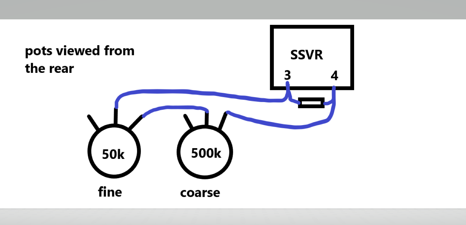

Re: SD 240V Controller Pot: 50%=0, too sensitive
pickled wrote: Fri Jun 19, 2020 7:30 am
shadylane wrote: Mon Jun 15, 2020 11:07 am Try putting a 500k 1/4w carbon resister in parallel with the pot
The value doesn't have to be exactly 500k just some were in the ball park
Thanks for all the good info Shady.
How should I attach the resistor in the controller? Which terminal to which terminal?
Here you go, sorry for the delay :lol:
Loosen the screws and slip the resister leads in with the wires going to the pot.
Try a 470k resister rated at 1watt or more.
Posts: 11542
Here Ya go blackstrap
Post by BlackStrap »
Perfect...exactly what I am looking for.
