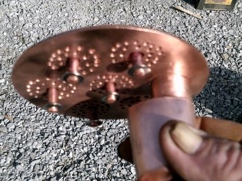

I made these 10 or so years ago
They worked fine, I only used them for spirit run and they had a great turn down rate.
They are not a fixed valve plate,but I'm not sure what a fixed valve is.

Since the post has drifted a little from fixed plates. Here's a valved plate I did awhile back.
It needed several more valves and more open area to work faster or have lots of extra small perf holes between the valves.
It would start and load just like a well designed bubble cap plate.
Turn on the power and reflux water and the plates would load top to bottom as you watched with no drama.
