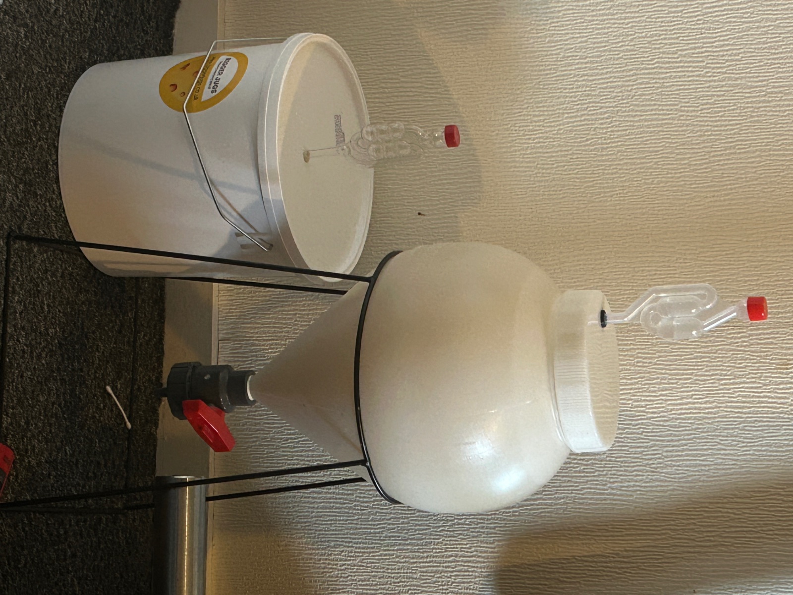

I’ve got a cheap plastic 5 gallon fast ferment conical fermenter and I love it for small batches . It’s got a little yeast catching jar at the bottom incase ya wana use ya yeast again also to remove it when it’s settled . I tend to only use it for the second ferment but I’ve also used it solely . It’s a great bit of kit and it as allways fermented out quicker than my other normal buckets .

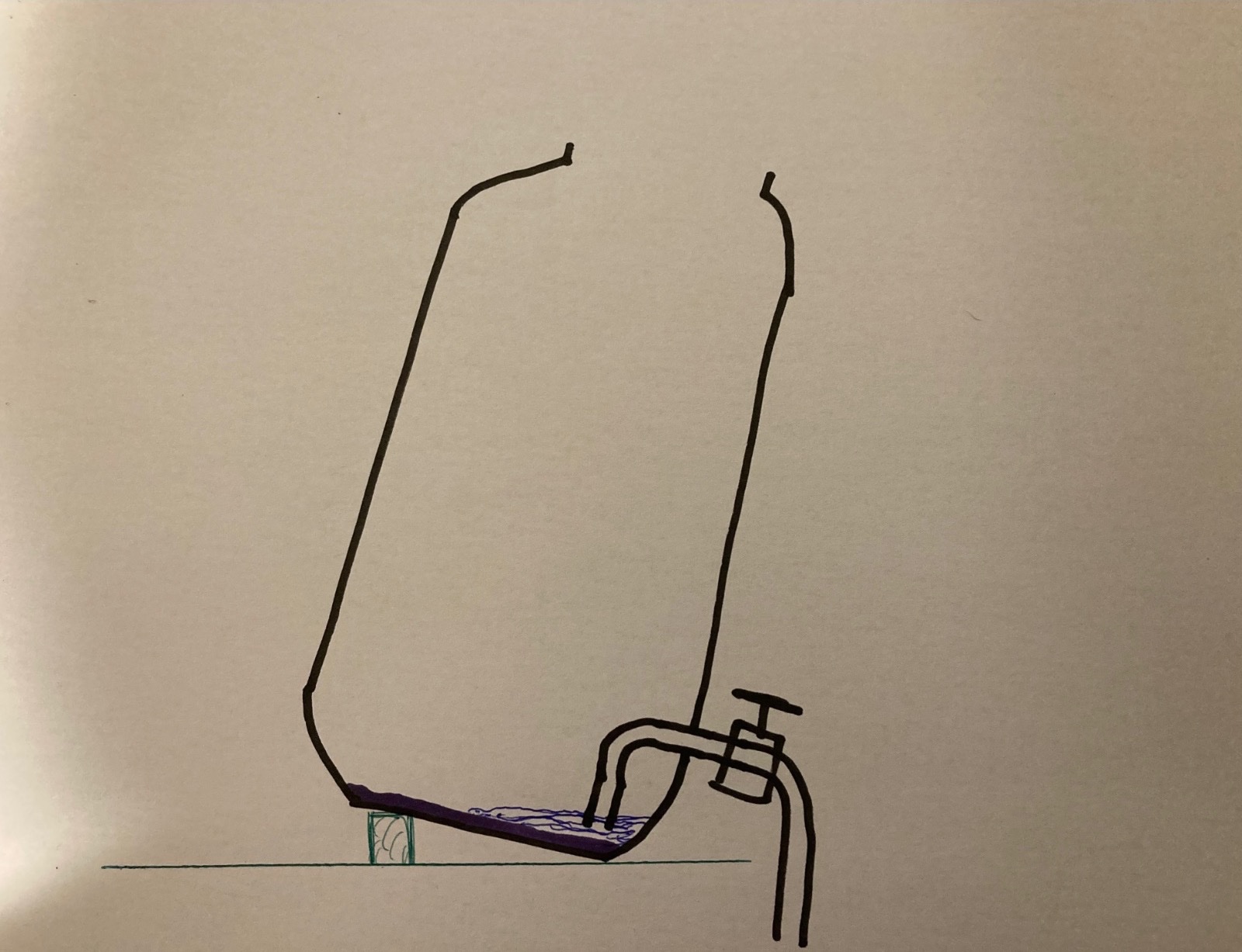

A flat bottom fermenter with a wedge to tilt the fermenter a couple degrees towards the drain valve.
Well, that's weird. I tilt away from the drain.
Why push trub toward the drain if the point is to decant off it ?
I can understand your thinking greggn iff’n you are looking at the pic Shady posted …… the drain is at the trub level .
Can’t speak for Shady , but my outlet is a few inches above trub settling height , so tilting towards outlet is very effective at separating off the last of the cleared wash . I have a setup as pictured below on one fermenter while the other is a straight hole in the side at about the same height as the bottom of the bent one .
Trub if settled , won’t move faster than the cleared wash can be poured off . :thumbup:

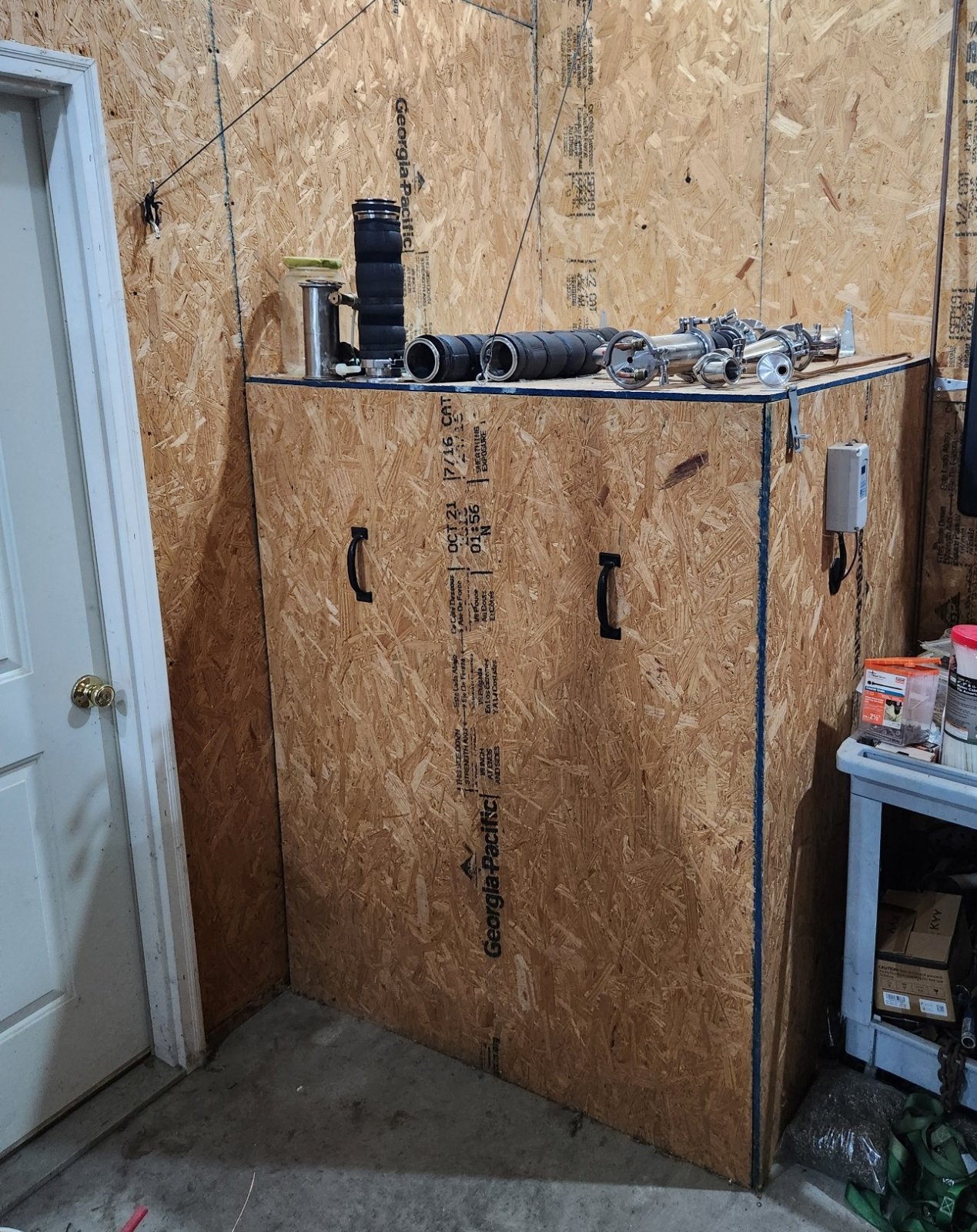

I hear ya, but I don't intend to ferment inside of it at this time. I ferment inside of two 55 gal drums with swiveling casters. The drums are wheeled inside of a wood box with a space heater and temp controller. I even have a little fan inside that helps to recirculate the air within the box when the heaters kick on. It's not insulated, but it maintains temp very well.
Once fermentation is complete, I drop a submersible pond pump (1,340 gph) inside the fermenter/drum. It thoroughly recirculates, degasses the wash and kicks up all settled trub into suspension. I intend to then use that submersible pump to transfer the wash over to the 55 gal conical tank. I then add Bentonite Clay slurry to wash and let it mix for 20 min. I'll let it clear overnight in the conical drum then use it to drain off the trub and pump the cleared wash into the boiler.
The next day (or while the first batch is being stripped) I'll do the same with the 2nd batch of fermented sugar wash.
The reason I don't intend to ferment inside of the conical tank at this time is because I mainly need it to just separate the trub. I also want it to be tall enough to slide a 5 gal bucket under it if I wanted to. That height would make it too tall to fit inside my fermentation box. If I did ferment inside the conical, I still need to toss a pump inside to degass it, mix in the Bentonite Clay slurry, mix it all again and leave it overnight to clear. I have considered fermenting the first batch inside the conical and if I choose to do that in the future, I just have to shorten the legs on the stand to make it possible. That will be a decision I'll leave to the future if I find that allowing a bucket to fit beneath it is of no use or value. I've given that option a lot of thought so I left it as an option.

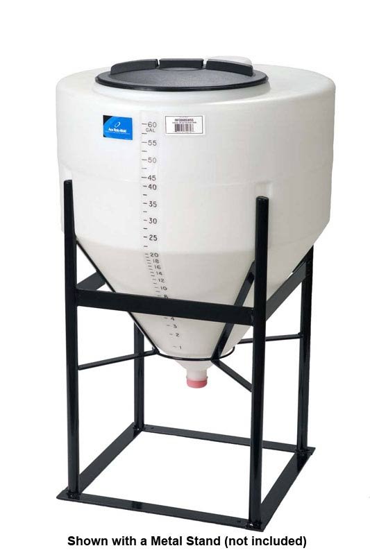

I just called the company and they cannot say if or when a 55 gal tank will come in stock for local pickup. They do however have six 60 gal tanks in stock ready for pickup.
60 gal tanks are 38" tall and the 55 gal tanks 47" tall. 60 gal tanks are 30" in diameter and the 55 gal tanks re 24" in diameter. It looks like 60 gal it is.

It looks like I'm picking up that 60 gal conical inductor tank this Monday! I'll be constructing my own stand out of wood. Once it's constructed I'll be fermenting a couple 50 gal sugar washes to test it out. Shouldn't be long. Building the stand will be a bit tricky. I have a plan, but we'll see how it works out.

Monday I picked up the 60 gal conical inductor tank. It was the very last one in stock and unbeknownst to me, it was damaged. I asked if there was anything they could do on the price and they knocked $50 off.
The port on the bottom was smashed and the threads were mauled.
I brought a pot of water to boil, suspended the tank over the pot and submerged the port to soften it up. I pinched the port using some channel locks then was able to successfully screw on a 2" fitting to force the port back into shape. It looks like the threads are in good enough shape to be serviceable.
